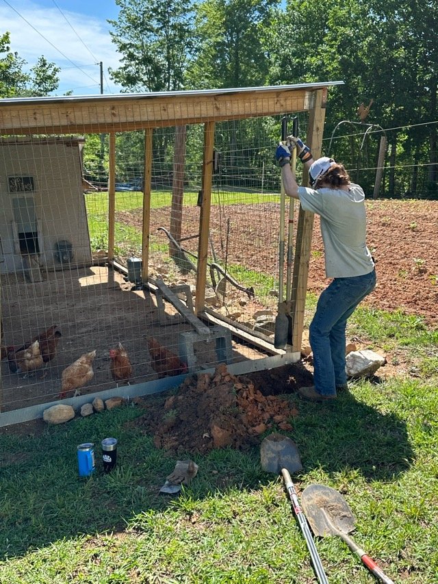

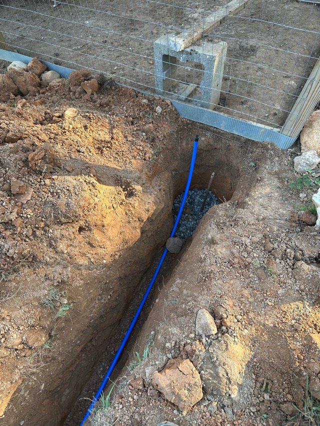

    First we dug the hole where the hydrant will be.

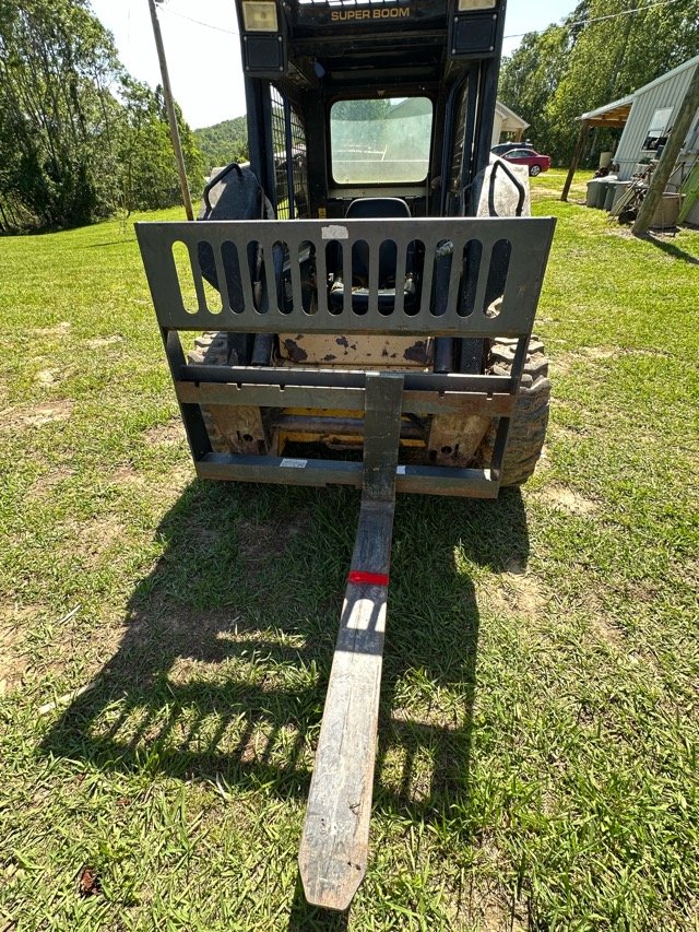

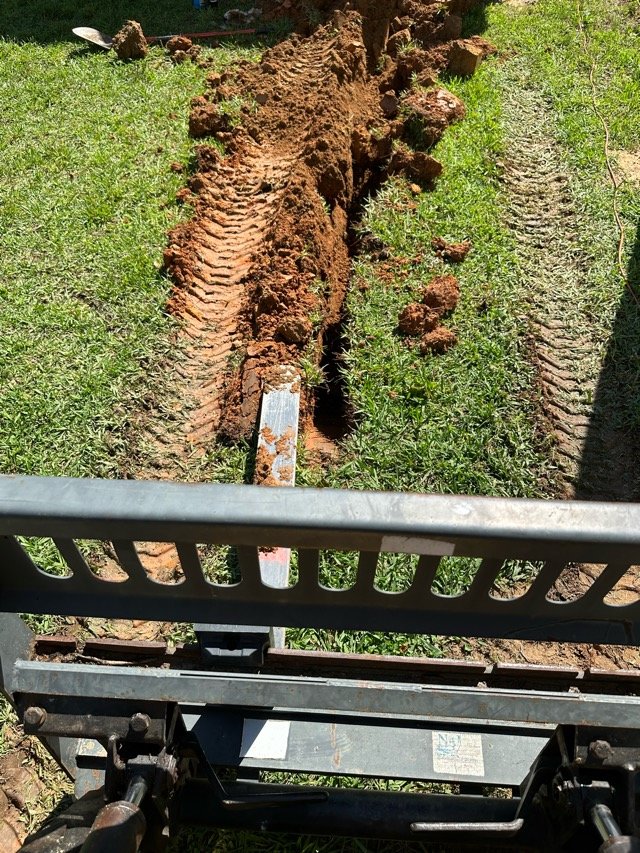

    Then I got the poor man’s trencher, with official depth mark.

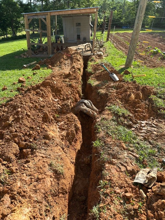

    Worked alright, had to do a lot of shoveling.

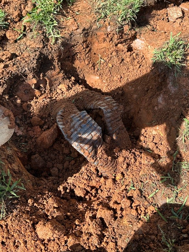

    Who put those gutter drains there?
    Yes, we shoveled all that to the sides. I’ll cover the line a little then patch those pipes. I got to get some underground wire so I can get the drop cord out of the yard going to the fencer for the garden.

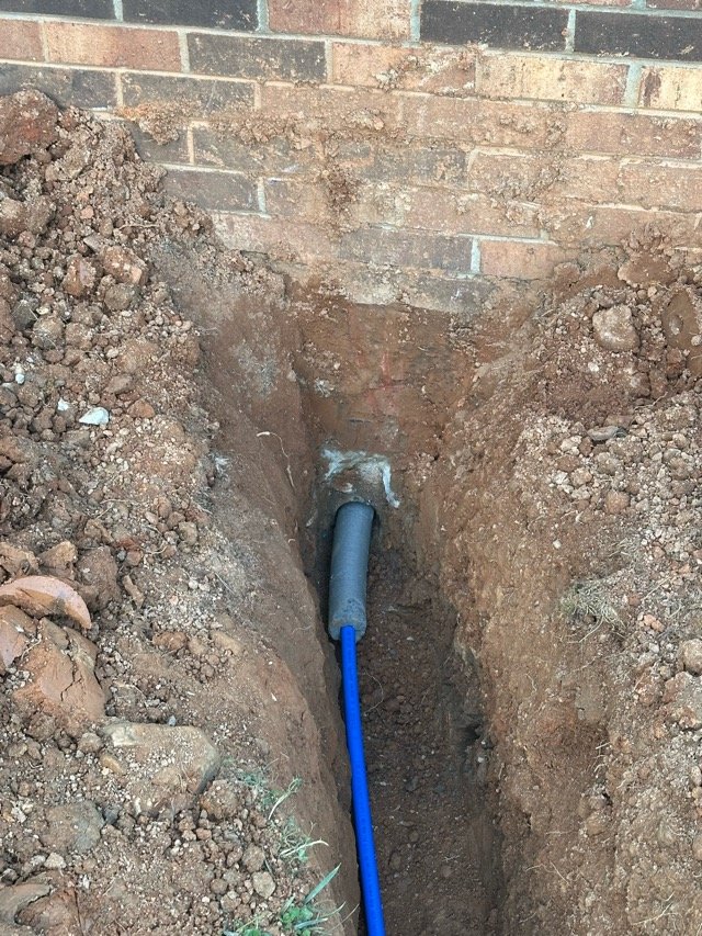

    Got the line in, no hammer drill to go through the foundation but I did use a hammer and a chisel.
    I would have hooked it up but I got a 3/4” pex to 3/4” female NPT fitting yesterday, I need a male fitting. Oh well, I’m tired anyway.

    Gotta love the ease of working with PEX. Can have everything functional in a fraction of the time of copper. Plus it's flexible so good for if the pipe shifts in the ground.

    You guys busted @$$ today, good job. :thumbsup::thumbsup:
    Great idea using the fork as a trencher.
