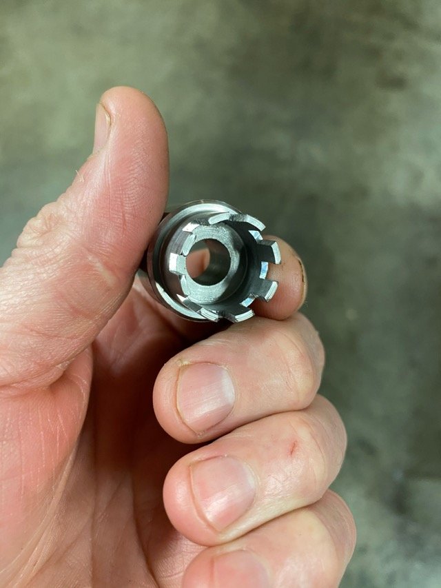

    Boss man had this disc laser cut. It’s so smooth the coax indicator barely jumps.

    Ah yes I can see blowing glass being pretty tight at +/-.019"

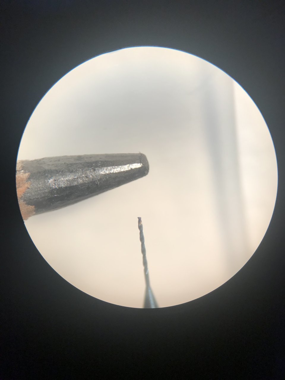

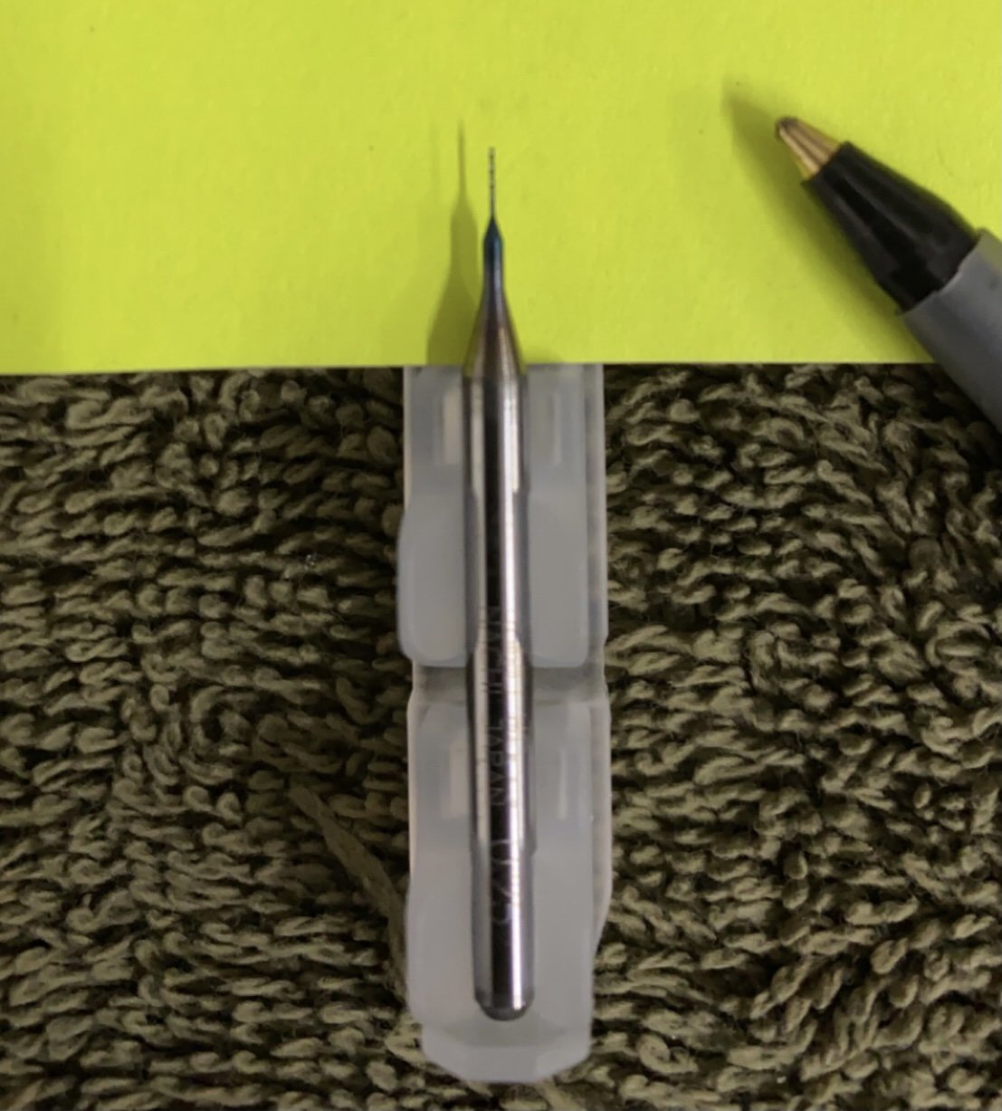

    Thought this would fit in here.
    .008 (actually .2 mm .00787) hole in 304
    It intersected a 4mm hole from the other end.
    I will see what else I can dig up that I have pictures of.
    5B310373-D480-4E87-8CA2-71120F02E98D.jpg 96C37478-AD5D-4787-9479-11ED8D4D85A5.jpg
  10. Oct 1, 2020 at 6:03 PM
    #1090
    Gregthespy
    Gregthespy Well-Known Member
    Apr 27, 2015
    #154090
    1,577
    Greg
    Orlando
    2015 Blue Ribbon Metallic TRD Sport 4X4
    How on earth does that even work?? Like I can’t even wrap my head around the fact that theres a drill bit made to do something that small!

    #1, how do they make a drill bit that small.
    #2, how do you drill it in anything, much less stainless :boom:
    Thanks for sharing, that is really cool :thumbsup:

    We have tiny drills, we call them circuit card drills

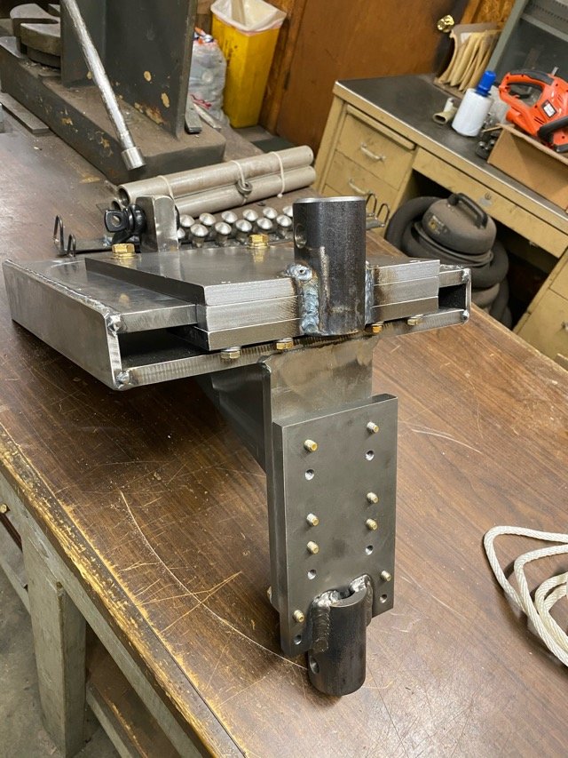

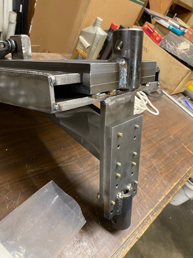

    Boss man took this to get tested today. They need it to hold 2,000 lbs. It was tested at 4,064 lbs, 10 times for 30 seconds each time. The graphs are near identical for all 10 pulls.
    I was a little nervous, I’ve never had anything tested I’ve welded. I’ve also never been to school for welding or machining.
    When I was 10 years old I ask my dad to show me how to weld with his Lincoln buzz box that he still has and uses. That was 1985, I remember it like it was yesterday.
    I didn’t touch a mig welder until I was 20 years old when I started in this machine shop, that was 25 years ago.
