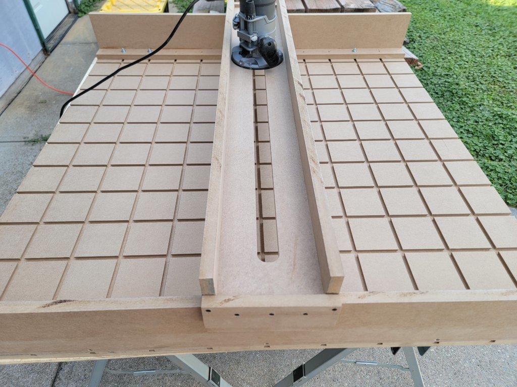

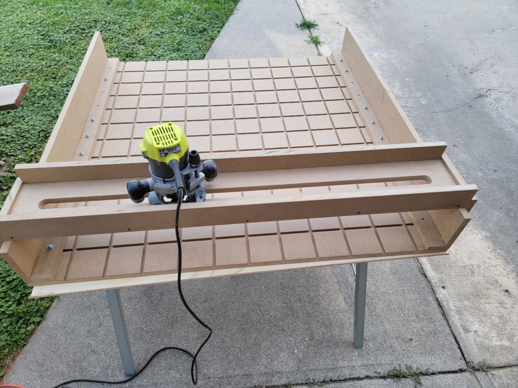

    Extra Large, 4x4 foot, modular, open ended, dovetail clamping grid, router sled is complete.

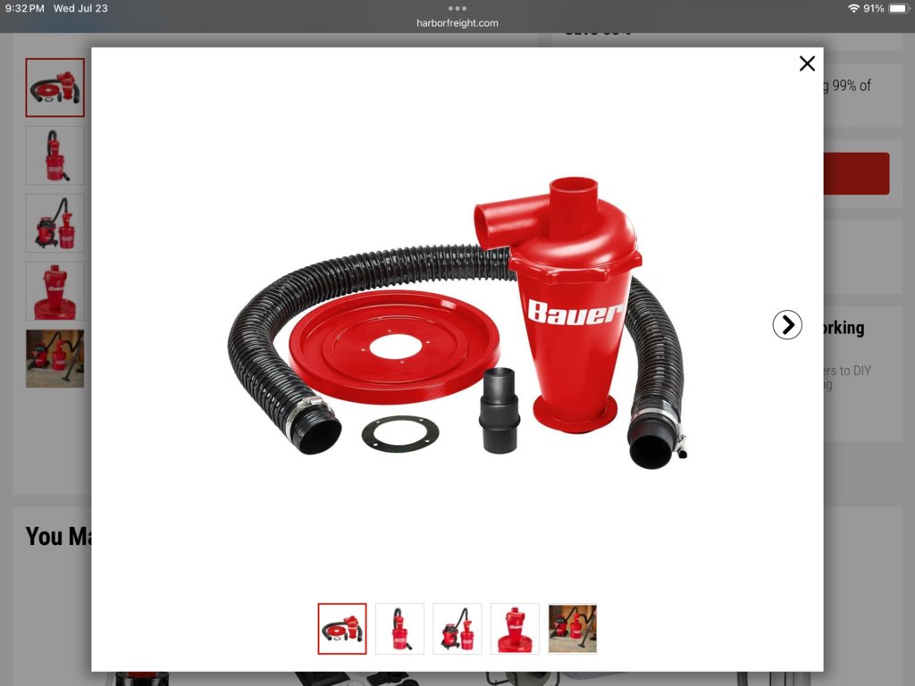

    I don't have any experience with that brand but I built 3 shop vac dust collection systems earlier this year.. two are dedicated to machines and one is for all the other things. With the Dustopper lids and 5 gallon buckets I've barely gotten a fine layer of dust inside the vacuum itself and its super easy to just dump the 5 gallon buckets.

    I get the concept, but I’m not sure I understand how it’s used/purpose.
    I could see using it for a linear pass through similar to a dado.

    It's for making wood flat

    The router goes right and left.
    The sled slides forward and back.
    The dovetail grid is for clamping the wood down.
    It's open ended so the length of a project isn't a factor.
    With the side rails being removable, shorter or taller side rails can be used to match the project.
    A round object, a wavy object etc can be flattened for further processing.

    I’ve got this, but I need a bigger shop vac than a 2 gallon 2 hp vac to use with it.

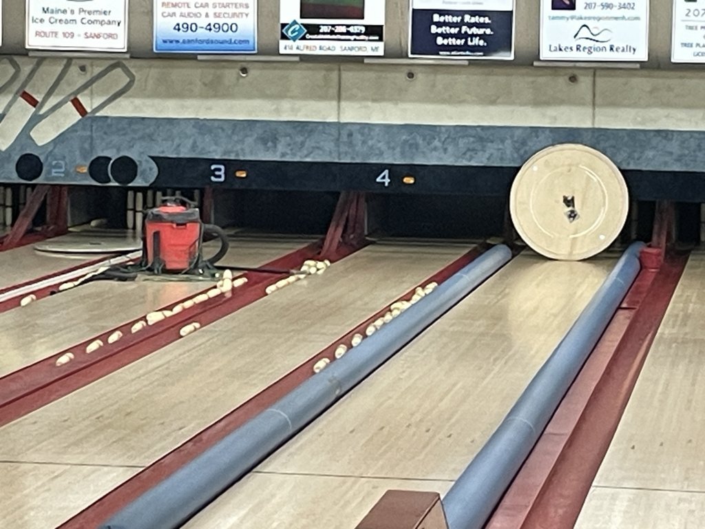

    A stripped turntable today
