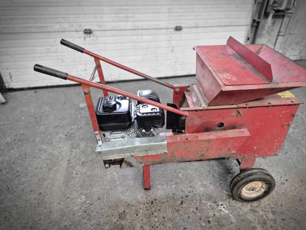

    Well Wrenchmen, it is even a bit warm here in the garage today, not bad though.
    I've been diligently working on the shredder :rolleyes: and the project is done!
    (...not perfect mind you but done just the same)
    The handles had to be raised and wider at the base to clear the larger engine. It is more comfortable for me to move now because I don't have to bend over, double win. :thumbsup::thumbsup:
    Seeing as good ole' @Delta09 has volunteered to come work for me for a week I extended the belt guard for safety with an old piece of galvanized from a furnace.
    Working a week unpaid no less, what a great guy !
    :fistbump:

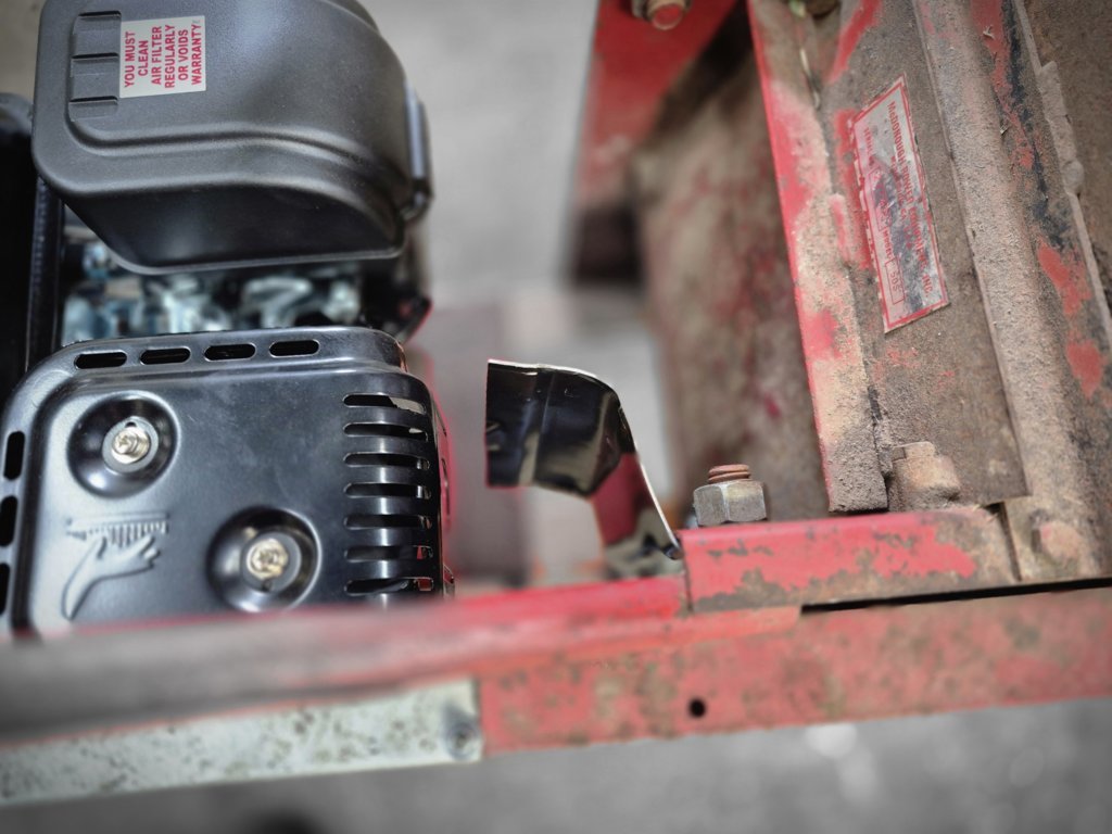

    The new engine discharges the exhaust toward the shredding drum, I thought that might no be the best idea so using a piece of leftover rocker panel from last years GMC project I made a deflector.
    I used my high tech metal forming tools - aka: large vice & hammer.
    With all the new bolts with Nylock nuts I used the machine is quite a bit quieter than before too -- and now it starts when you pull the rope! :)
