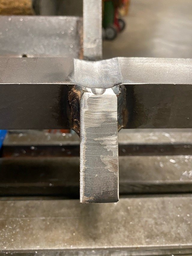

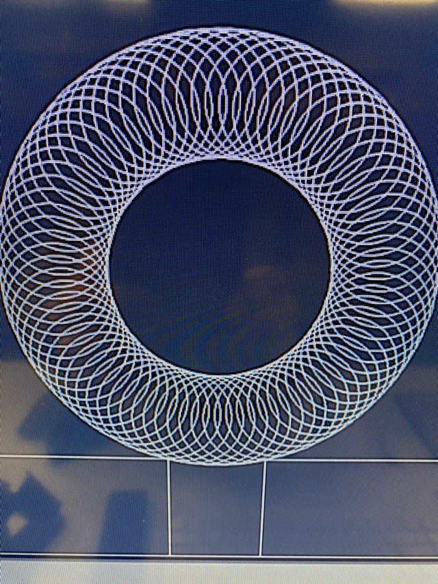

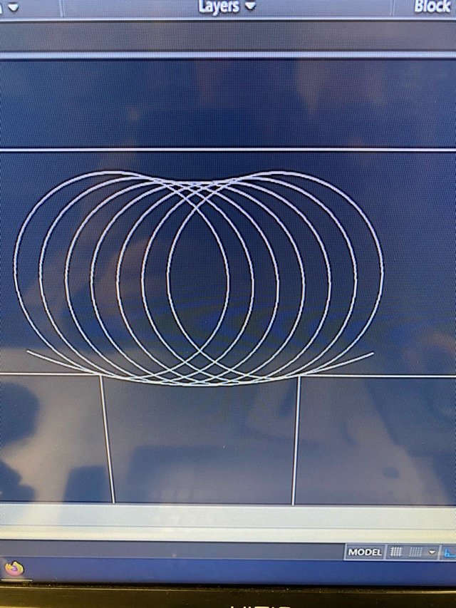

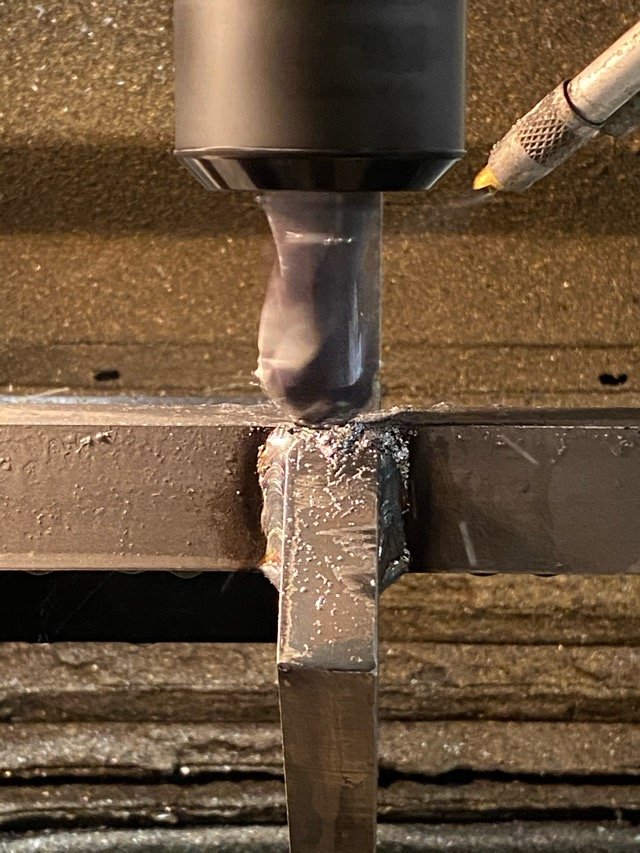

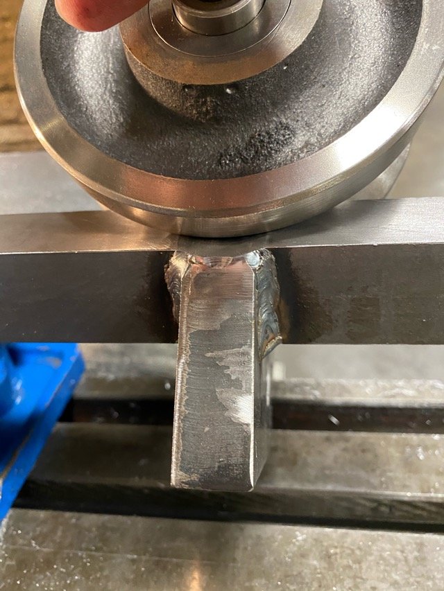

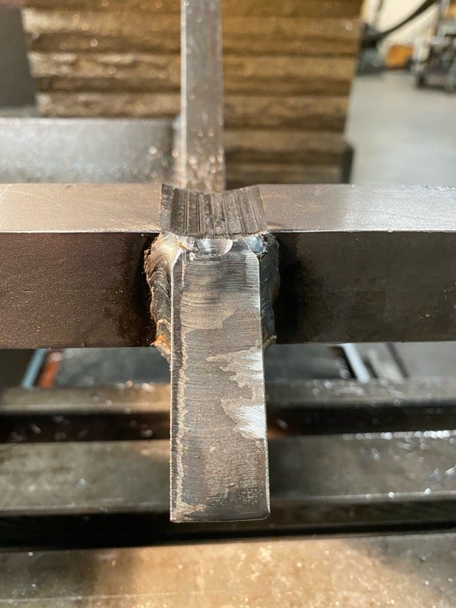

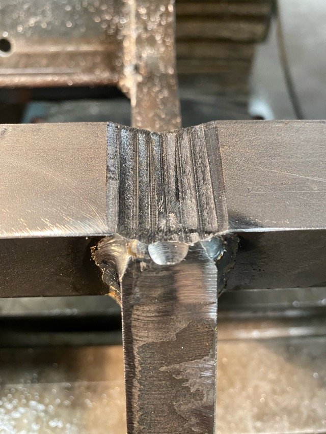

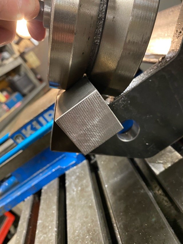

    I tried something I’ve never tried before. The biggest ball end mill we have is 1”. I drew it up and arrayed it, took it down to 7 passes.

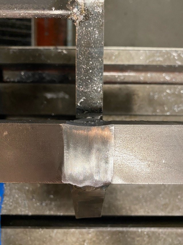

    It worked, I had to blend it in with the hand grinder.

    All it does is give this wheel a place to sit.

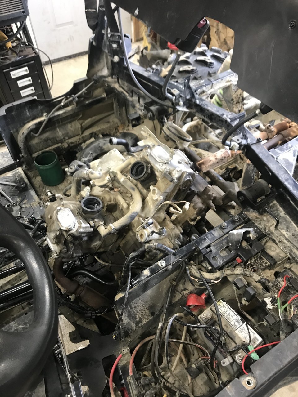

    72379790-2216-4718-8A71-4D7AD1A18BF1.jpg Part of getting a new job means no more side work. This is one of the last 2 motor jobs I’ll be doing for the foreseeable future.

    What is that, a side by side?

    If only you could affix a 10mm socket on that thing somewhere.
