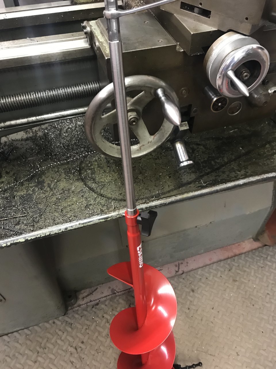

    image.jpg image.jpg I’m too cheap to buy a $180 pistol bit auger, so I made a drill adapter for a hand auger. I’m starting to figure out that hex collet block I think.

    Not familiar with that lathe attachment; some new type of boring bar?

    For 8” holes in soft materials. Tolerance is +\- 3”

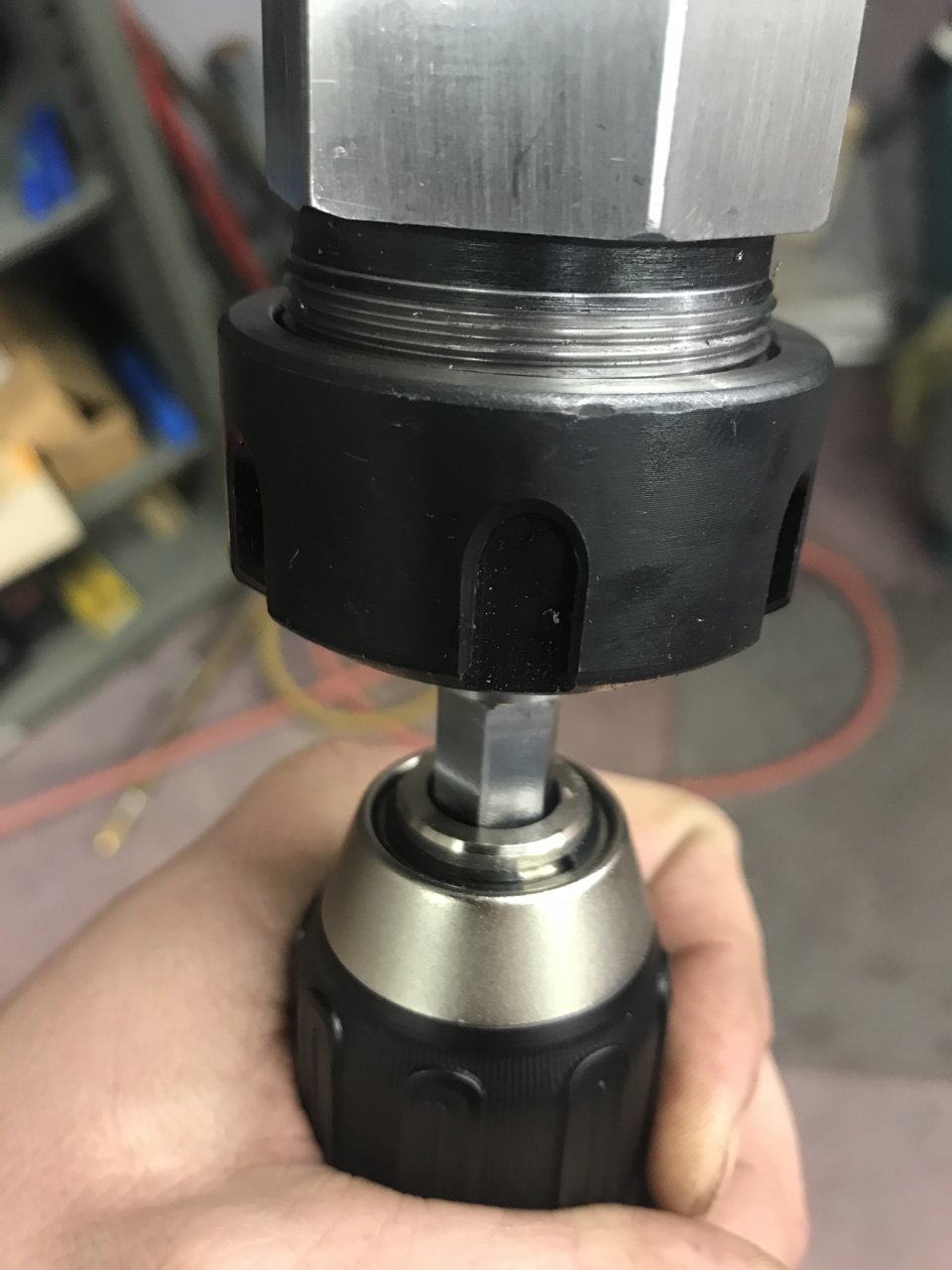

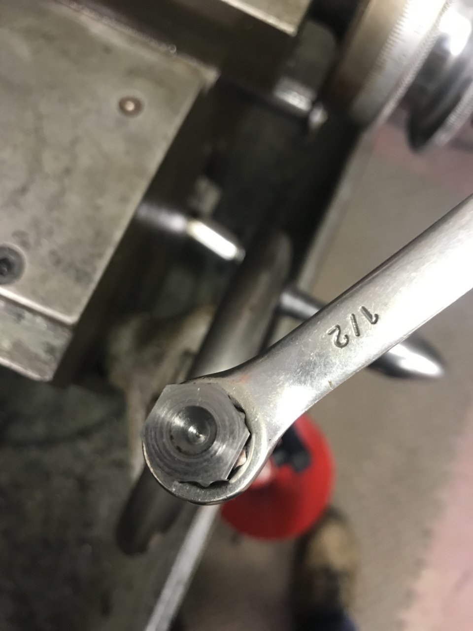

    Thanks! I made the mistake of thinking the 1/2” hex would fit in the Chuck of a 1/2” drill. Now it’s back in the hex block for a little trim :anonymous:

    Turn it down to 1/2" and just cut 3 flats 120 degrees apart :D

    That would have been a great idea. I just took .030” off each side so I could practice re setting the block to match what I had. She fits now!image.jpg

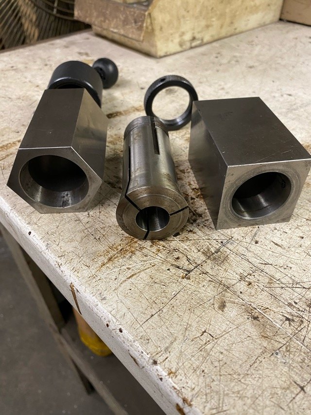

    What does the rest of that collet holder look like? I've never seen one quite like that with a hex.

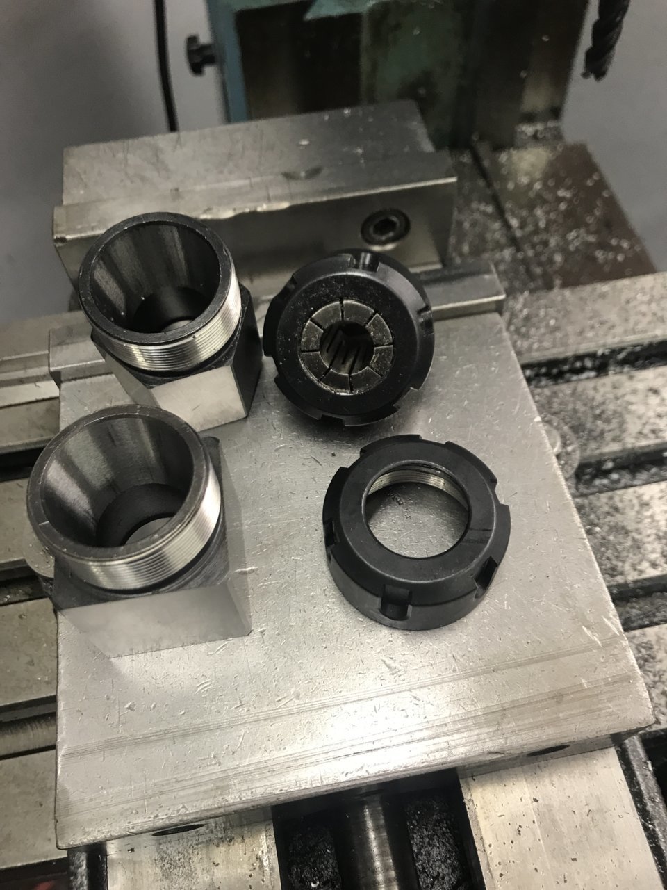

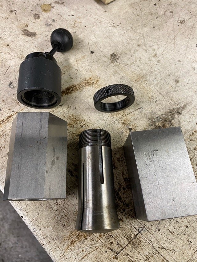

    That’s nice, this is the only one I’ve used, it uses 5C collets. It has a quick change piece for short pieces or a nut for longer pieces.

    Same set here. I need to look at that other set, it looks like it takes the same collet as a few other machines here.
