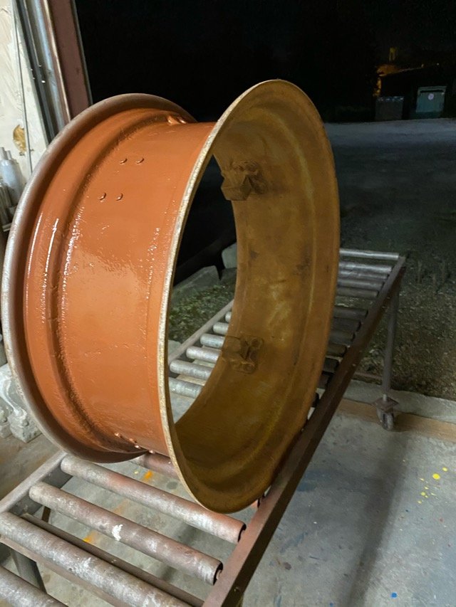

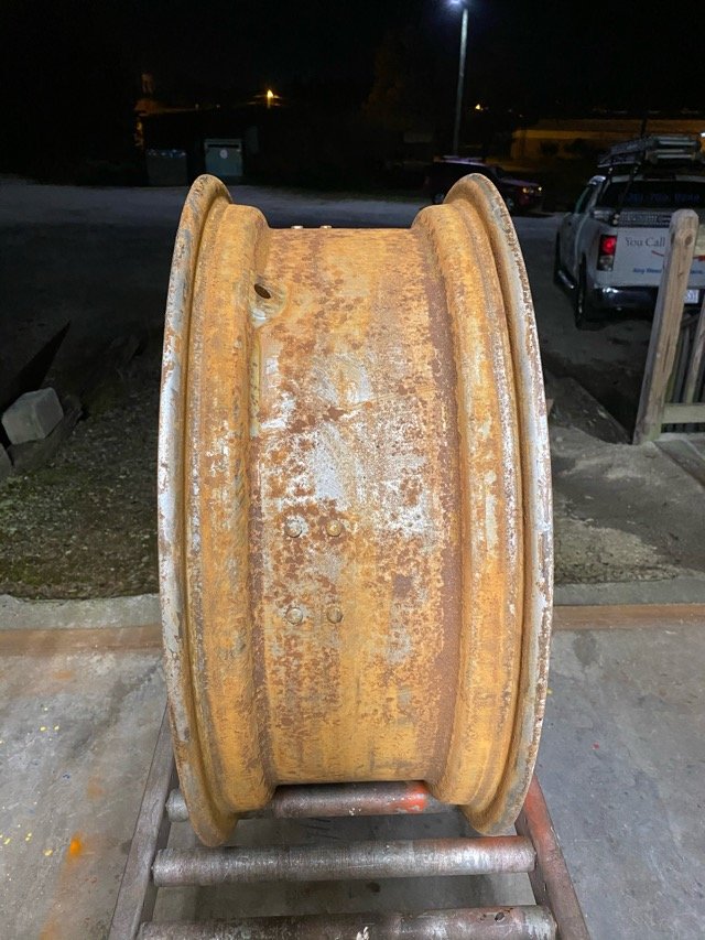

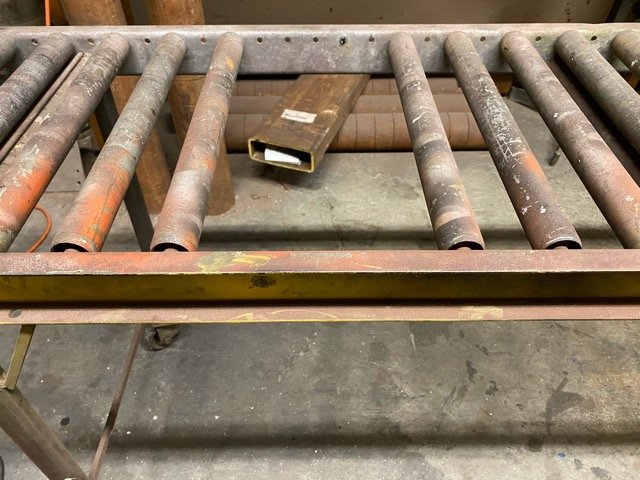

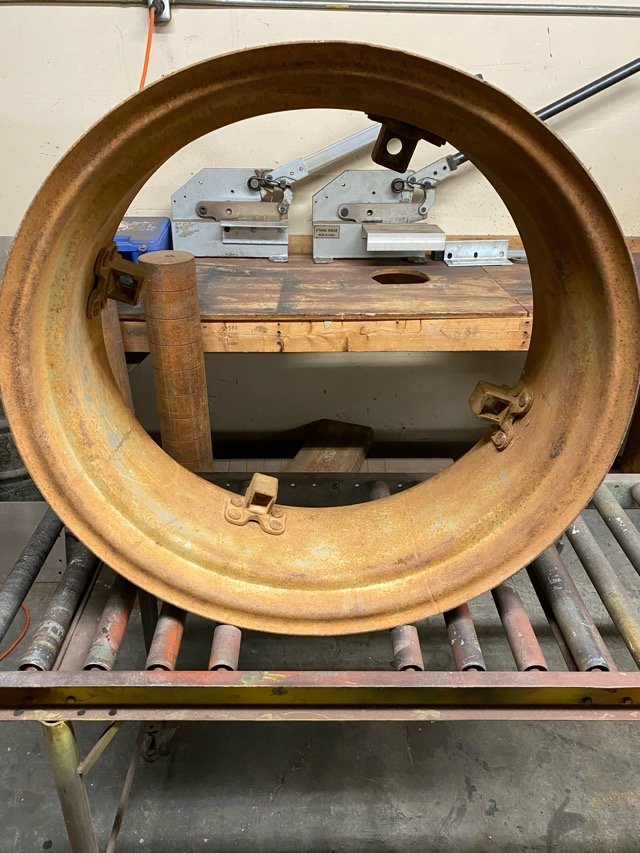

    Here's a trick I learned from my dad years ago. Take an old conveyor and pull a couple rollers out of it and wire brush, sand, and paint rims. It allows you to roll it for a good even coat and the only thing messed up is the edge but 99% of the time the tire covers that anyway.
    I had to buy 2 new rear rims for one of our 140's. Both of our 140's had one good wheel and one bad one. I saved this good one and only wanted to paint the inside to stop the rust before I mount the tire on it and leave the original finish on the outside to match the other one on the tractor.

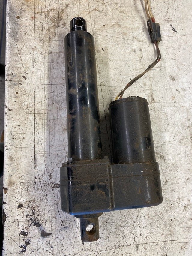

    Found this linear cylinder I forgot I had. Gonna try it on my vacuum system on my mower for the dump. The handle is on the left side and my left shoulder is bad. I have to turn and use two hands to open and close it.

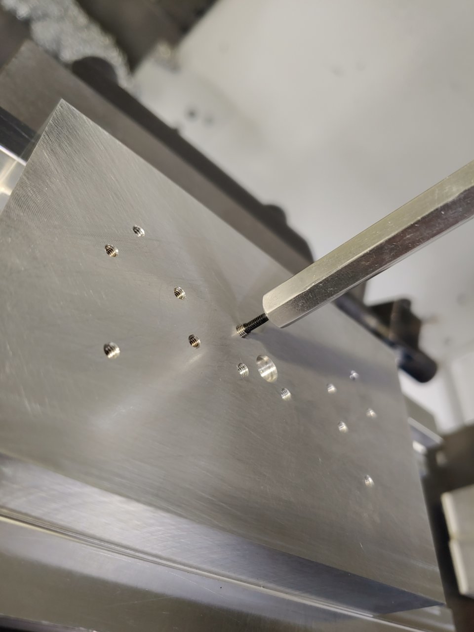

    2-56 helicoil installation

    So the threads don’t strip out of the aluminum?
    I don’t know that I could see them being that small :eek:

    Theyre bigger than you think. 2-56 .129 helicoil install, drill size of .093" @ .400" deep for good measure lol
    And yes so the threads don't strip, its a fixture plate for a part I'll be making tomorrow

    I just said that just in case anyone didn’t know why you put helicoils in aluminum, we do the same thing :D

    For some reason they don't do it initially at the shop I'm at, then when I pull 3 threads out within the first 5 parts after I reset up the fixture it takes time to drill out the holes, tap, and install the helicoils

    Most of the time the person making the fixture and using it knows what to do to begin with to make it work and last longer.

    Yes, but doing a lot of 30-40 parts and then doing it again (with setup scrap), they get tired. Or you could do what I did today and look at the wrong setup sheet and not add .091 to the Z work offset lol
