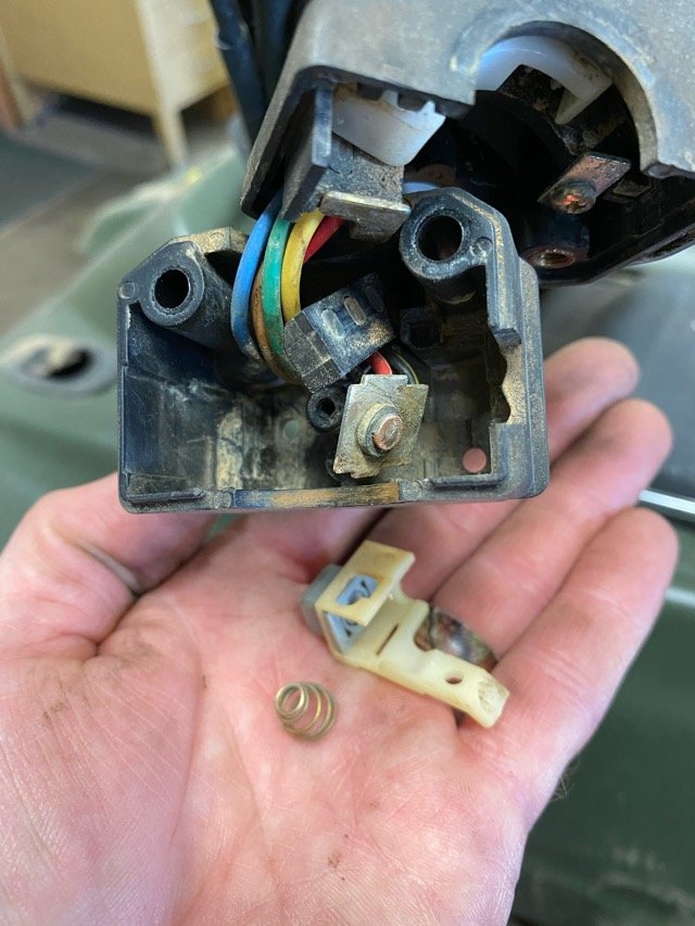

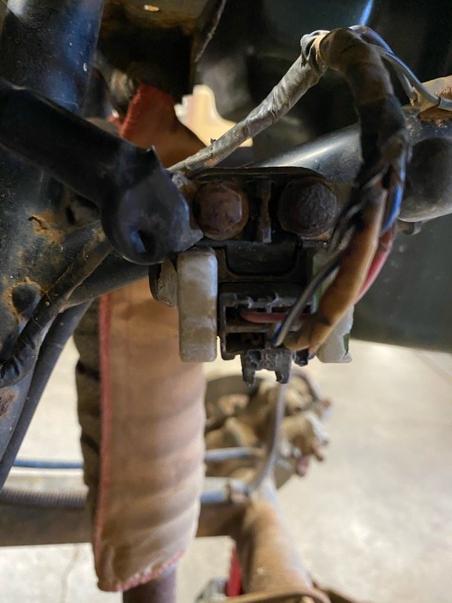

    @cory02taco or anyone else with Yamaha experience. This four wheeler, when I push the starter button I get nothing. The solenoid, when I turn the key on the top two poles where the plug is become hot. The bottom two are hot all the time. Both fuses are good. What am I missing? Solenoid bad?
    I can short the cables on top and get it to turn over. I took the switch apart and cleaned it too.
    I also sprayed a little ether in the air filter housing and heard it run for 3 seconds :D

    The kill switch is notorious for going bad. Id replace that first or see if its stuck on for sine reason

    Also key switch goes bad a lot

    Kill switch is working, I can here it clicking underneath when I move it back and forth. Key is getting power to everything as far as I can tell :notsure:

    I had to jiggle the key switch to work, i could get it to start sometimes but changed that and worked great

    This key is off and on, it has push button start. Neither of those being bad would explain all 4 poles of the solenoid being hot. If they're all hot, it should be turning over the engine but it's not. Which leads me to believe the solenoid is bad but I don't want to start throwing parts at it, that gets expensive quick and it's probably something simple.

    Those starter relays suck, that one looks toast. What happens is they get water in them, and the relay inside clicks, but everything is rusty and they won’t make contact. You should be able to find an aftermarket one for less than $30. That Yamaha snosled I posted a picture of here a few months back had that exact same problem.

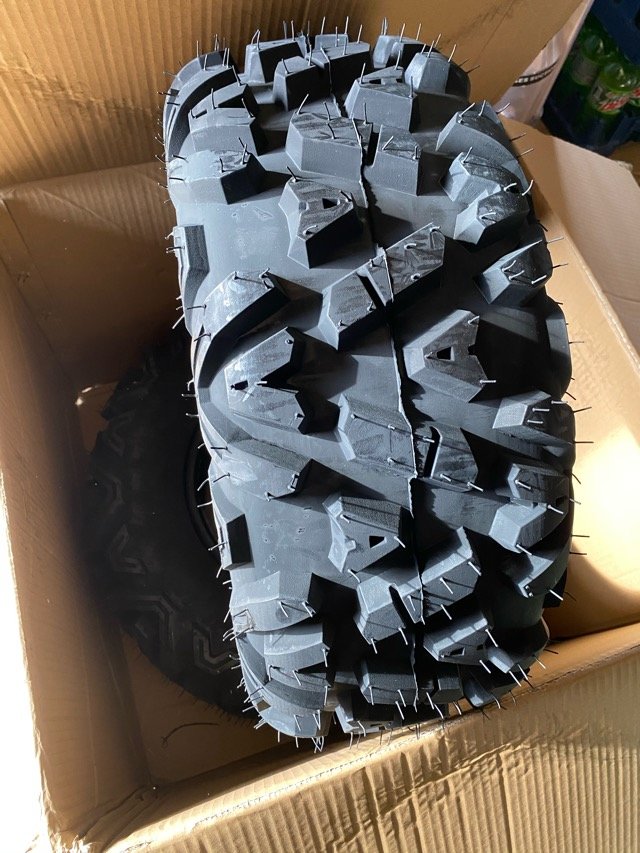

    Ordered a set of four tires, said delivered. Got two of them :annoyed:

    Have you taken a hammer to this solenoid yet while trying to crank it? Sounds like you have everyone figured out. BFH!

    I tapped on it with my pliers, didn’t get too rowdy with it since it’s old and brittle. I just ordered a new one and some other parts I need :thumbsup:

    Ok. I’d say if it’s that bad then get one in there! I’ll back your diagnosis

    Found one for $6.99, I replaced the one on our other four wheeler but it’s 3 years newer and a little different. This one I’m working on is a 1995 and has some odd stuff on it comparing it to the other one. I ordered a new solenoid, carb, front master cylinder, air and oil filter and some Yamaha oil. Hopefully I’m done buying parts and will have less than $1,200 in it :D
