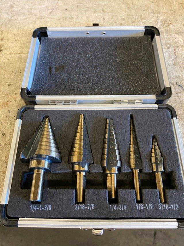

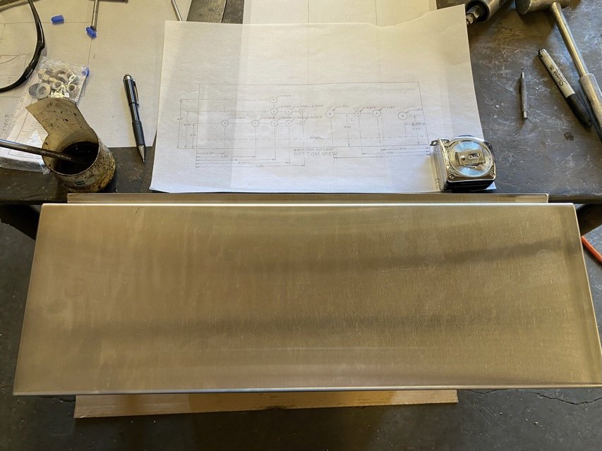

    Boss man ordered these off Amazon to try for the holes. Hopefully they last.

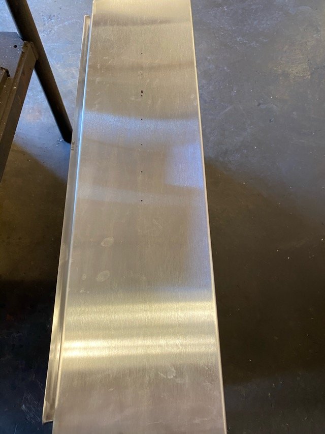

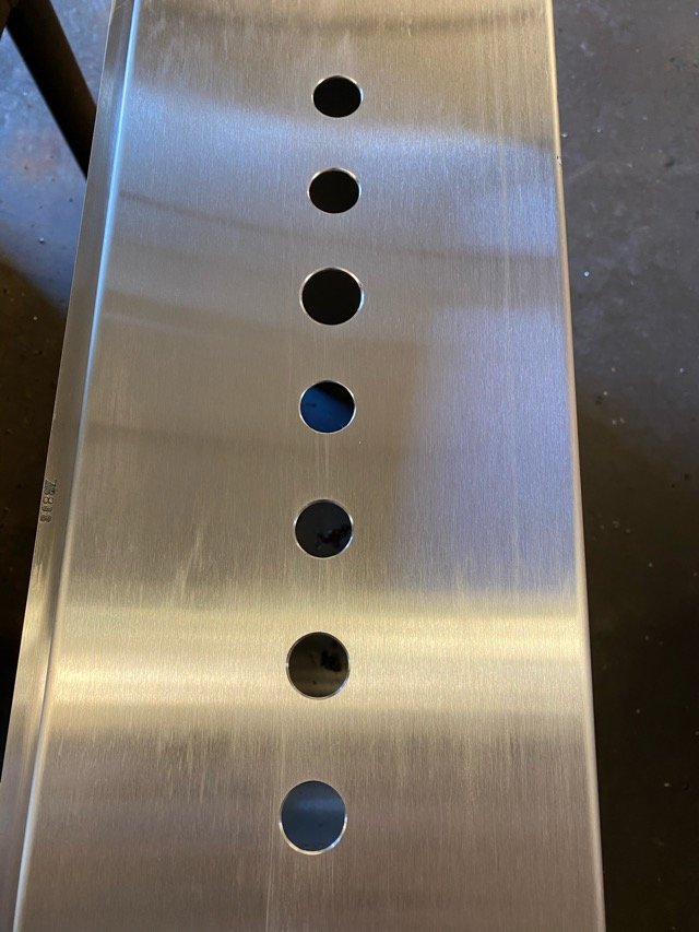

    1st side done. One of these drills goes up to 7/8” which is what 6 of these holes are. It worked great! The 3rd one down from the top is 1”, I had a time with it. I’m also using some really good cutting fluid. This is 1/8" thick stainless.

    Five Amazon step drills - five holes.

    That is what I was thinking, so far so good though. The whole set was $26 I think.

    As long as you can use them in a Mag Drill drill press or mill they will last a long time with common sense.
    Never fails some one chucks them in a hand drill Rocks them side to side and they are finished.
    Never did figure out if they can be sharpened after they are ruined.

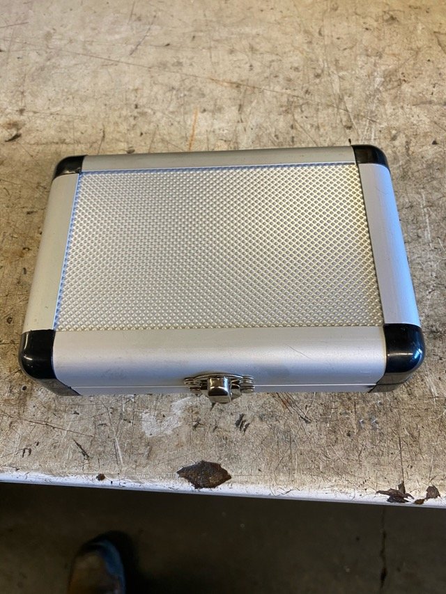

    I'm having to use these in a hand drill, box is too big to put in the machine.

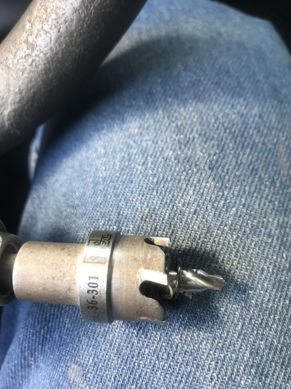

    We use carbide cutters for most everything we can’t knock out, step drills work but they throw a lot of chips into a panel, which is bad if it’s live. Most of the chips stay out of the enclosure with a carbide cutter. image.jpg

    That is a cool bit! We don't do many of these boxes, this is the first one I've had to drill the holes. I've cut several doors for the screens over the years though.

    They are real handy if you have to cut a lot of holes or in thick material, but pretty expensive. I have a 2-1/2” one left over from a job years ago, it was a little over $100 if I remember correctly

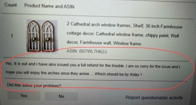

    My wife ordered these a while back and finally asked for a refund and got this response o_O

  17. Mar 11, 2021 at 10:11 AM
    DLRIII
    DLRIII Well-Known Member
    Feb 27, 2018
    #245744
    1,977
    David
    Baton Rouge
    2018 Quicksand SR5 DCSB V6
    Does not compute

  18. Mar 11, 2021 at 10:12 AM
    six5crèéd
    six5crèéd [OP] Be the light
    Jul 9, 2019
    #298734
    35,983
    Southern Virginia
    8 lugs no plugs
    Yeah, makes no sense!!!
