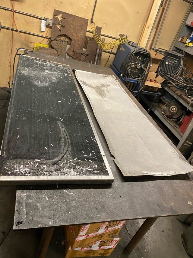

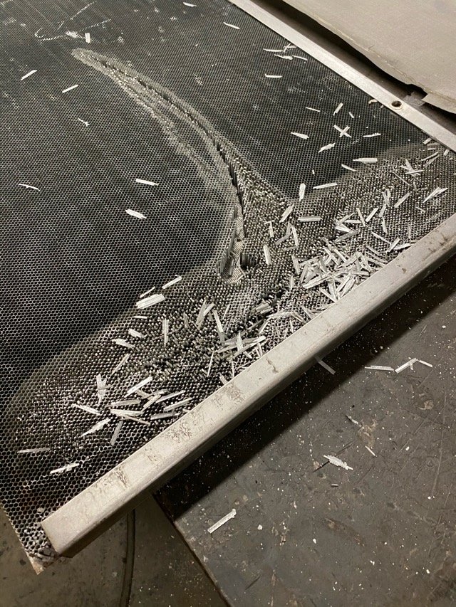

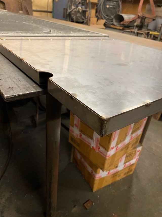

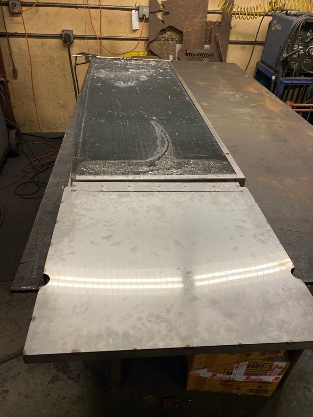

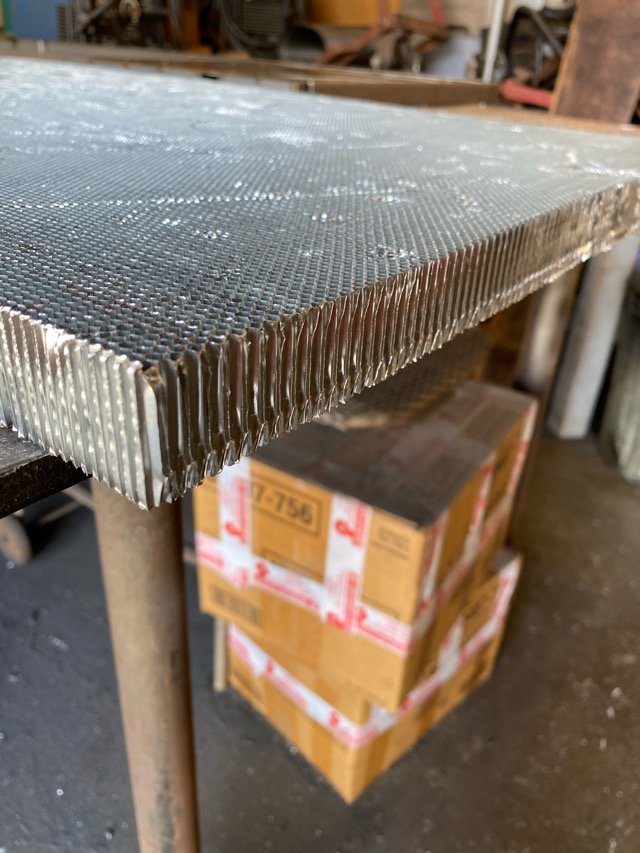

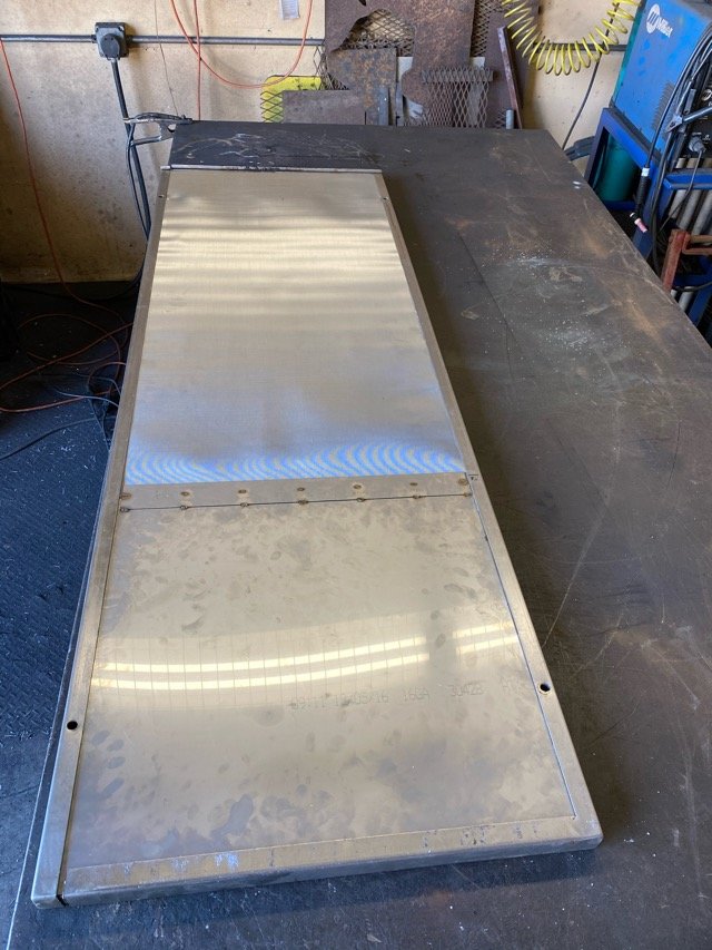

    Finally got the go ahead to repair this. Customer asked to cut the bad out, make a stainless box to fill the void so it will increase the volume through the remaining part. If they like it we will be doing more.
    Boss had our fab shop make the box.
    I cut the honeycomb with a razor blade, it's aluminum.
    New stainless screen.
    Finally got the puzzle back together.

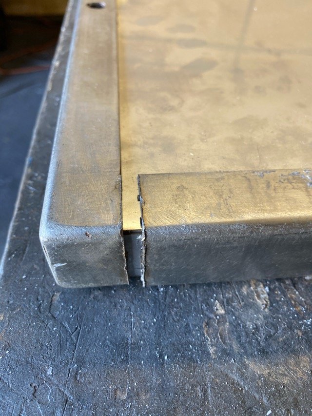

    Now to clamp it a little closer and weld it. Got to leave a 1/16" gap from where I cut it apart.

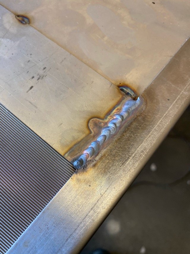

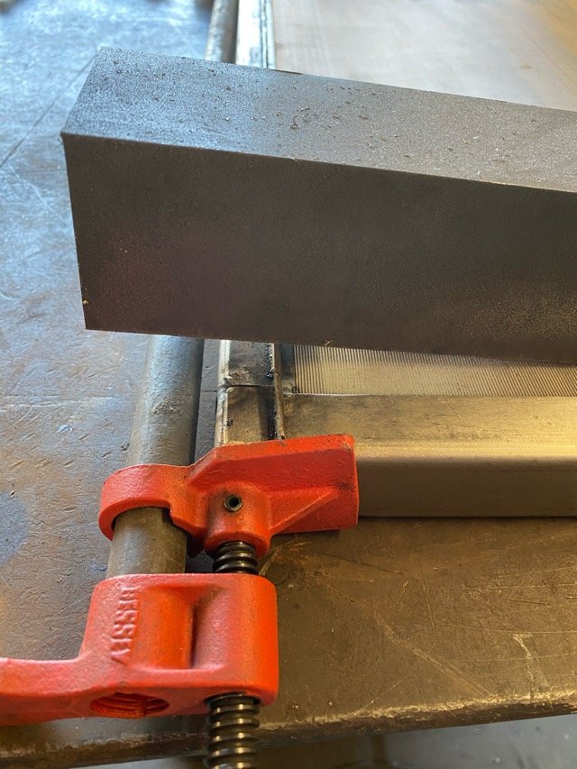

    Trying to manipulate this where it needs to be.
    I don’t like TIG welding. I don’t do enough to be good at it.

    It’s amazing what regrinding the tungsten will do for my welds :D
