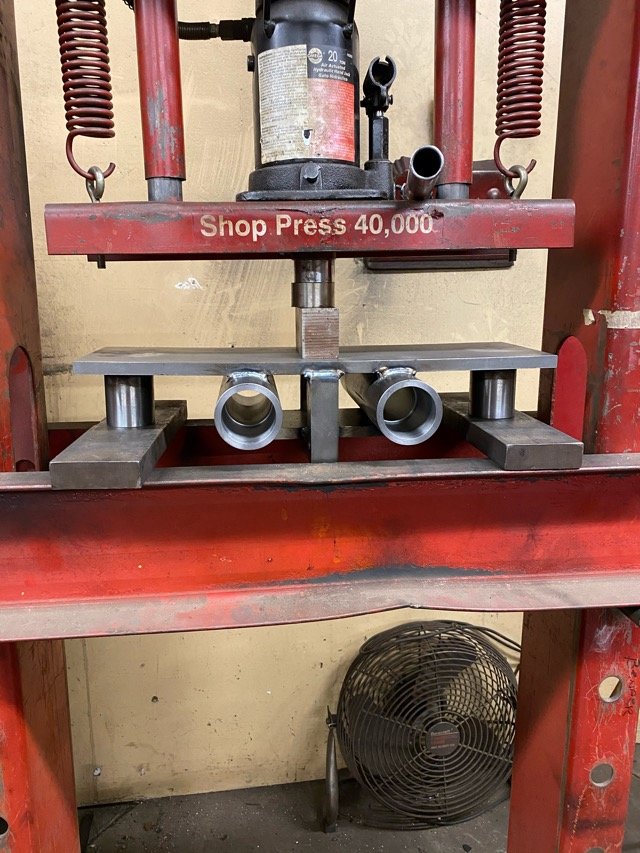

    Bowed more than I hoped, time for the press.

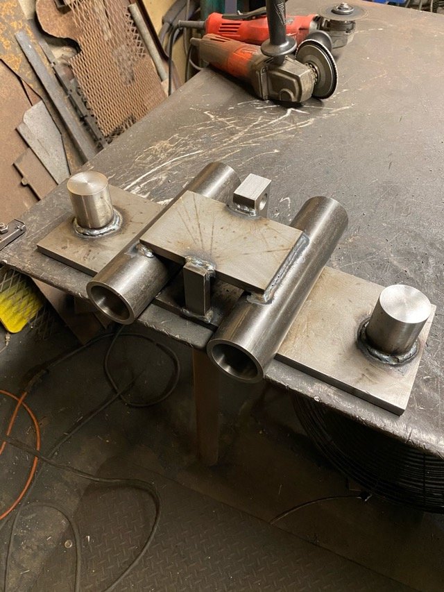

    The print says "carriage" I'm not 100% sure what this thing does :eek:

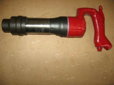

    Since folks here are of a mechanical turn of mind, you remember a while back I posted a picture of a new toy I received, the "rivet buster"
    (Essentially an air-hammer on steroids - 23 CFM @125 PSIG)

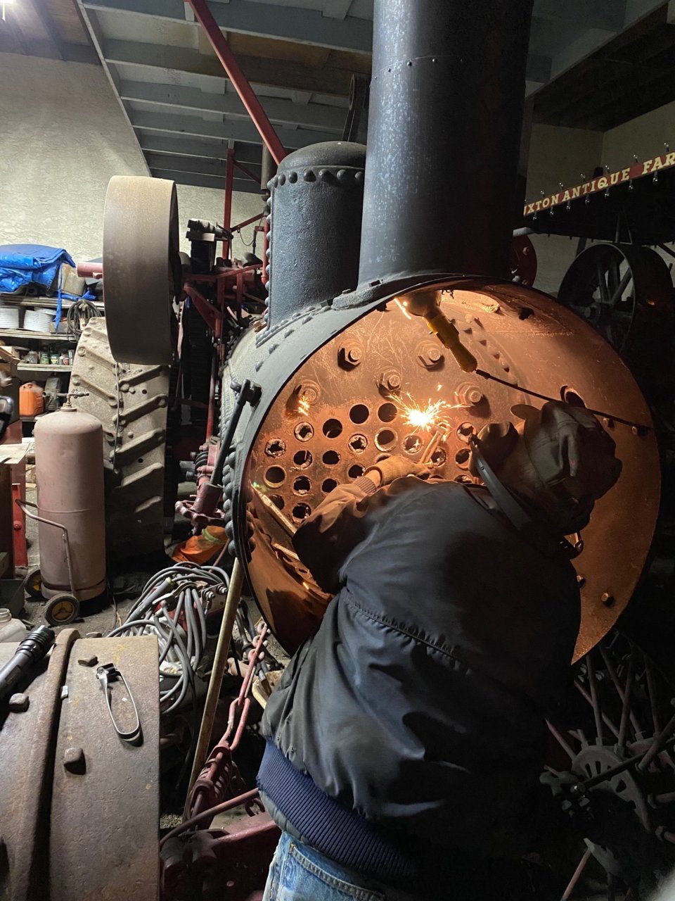

    Here it is in use:
    Our antique farm equipment club is retubing the boiler in our 1912 Sawyer-Massey steam traction engine. Jason is in the firebox at the back of the tractor with the rivet buster collapsing the tube ends with a cape chisel, and Dave is on the torch slotting the smoke-box ends. We then put a drift into the rivet-buster and push the tube out the front.
