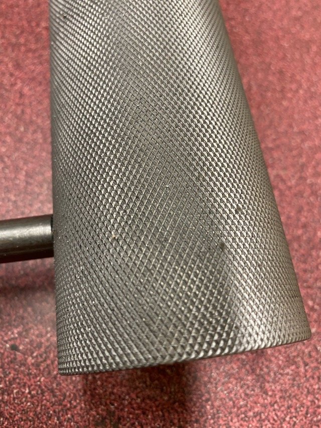

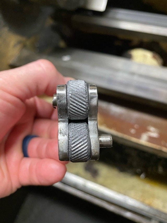

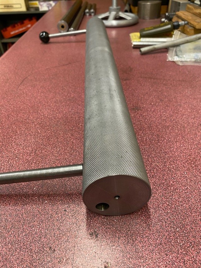

    Probably a dumb question but that's done on a lathe right? Just spiral cuts at a particular speed? I've never used our lathes at work for something like that, of course I've only rarely used a machining lathe at all.

    There’s a tool for it. You can change the rollers for different size checkers :thumbsup:

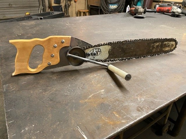

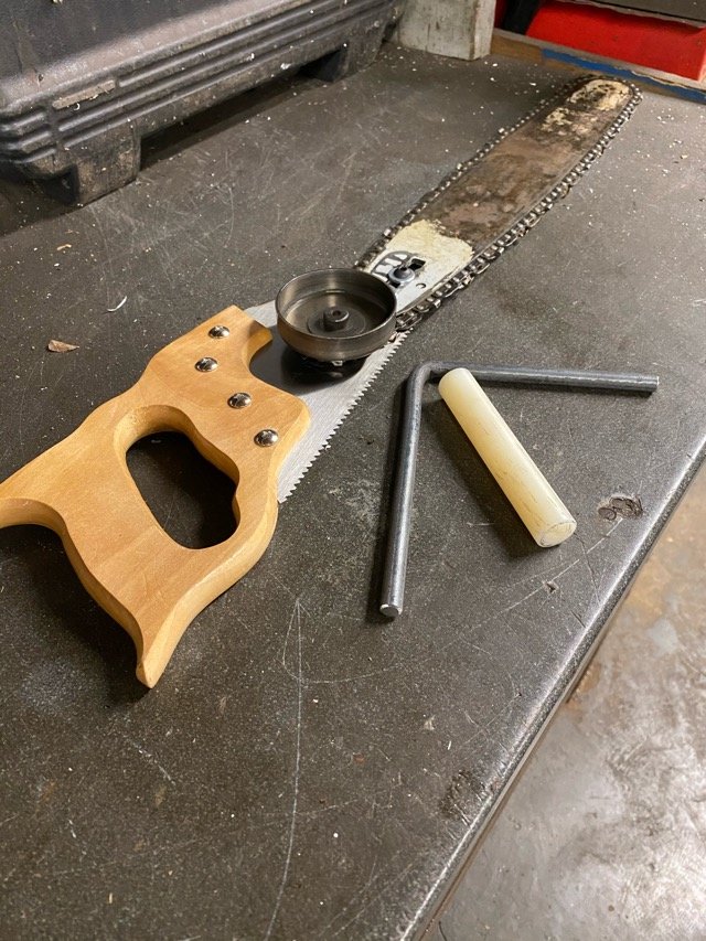

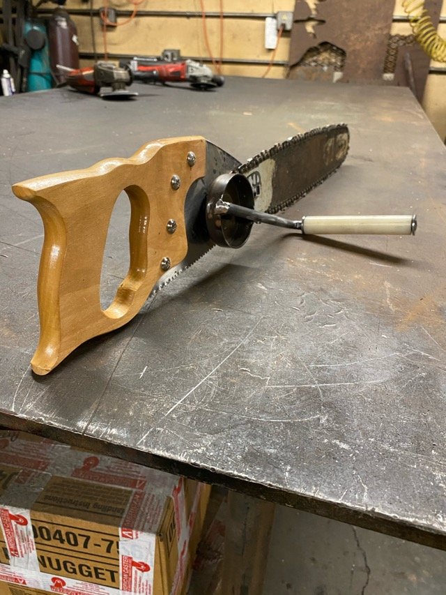

    New hand/chainsaw is done. Thought we had a handle but the boss said he threw it out. Made one :thumbsup:

    Makes sense! Thanks

    Yes sir :thumbsup:

    Yeah, getting a knurled finish...my difficulty is consistancy, one time they look great next time not so much. It helped getting new wheels.

    So you roll that 1/2" then move it over and repeat?

    Once it starts to engage it is supposed to stay in it's own track so you just move it one way or the other while the little wheels spin. My problem is is gets crossed up and doesn't stay in the same track and makes an ugly finer knurl.

    I got to pondering a bit about that saw...
    :rofl:I'm not sure one way or the other would be any easier cranking lefty or righty:D

    I have mixed knurling results. That part your co worker did looks great!
