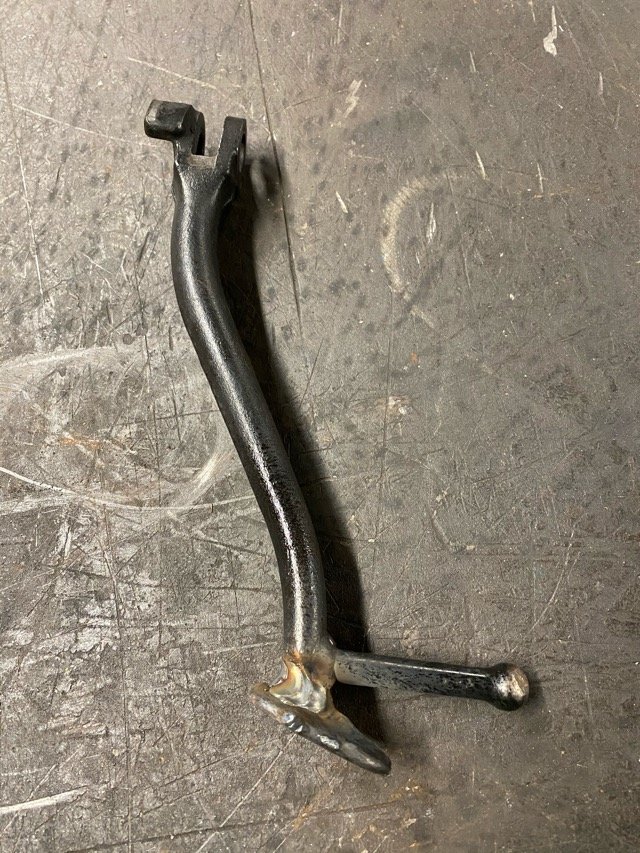

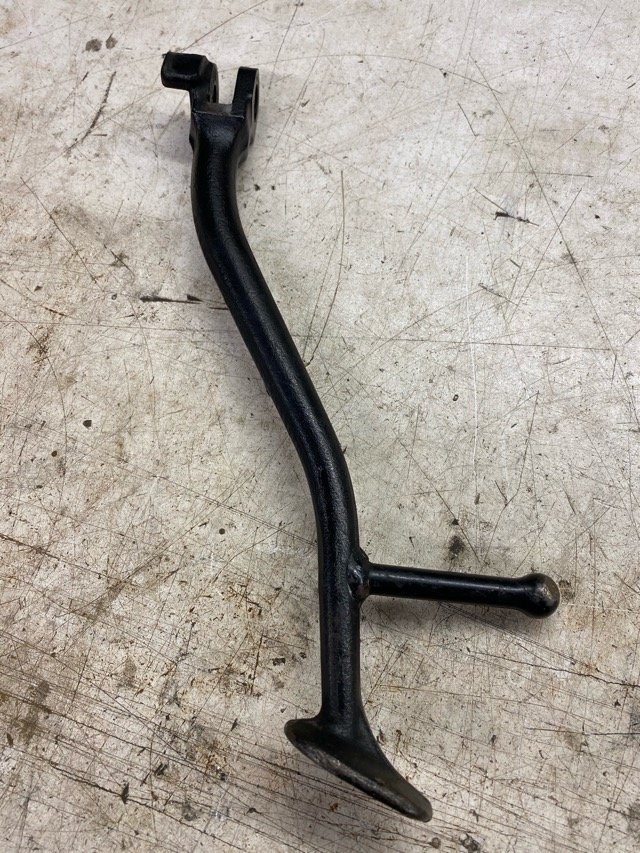

    Customer wanted his kickstand shortened.

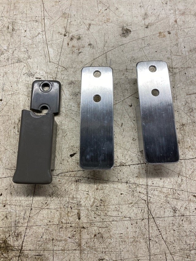

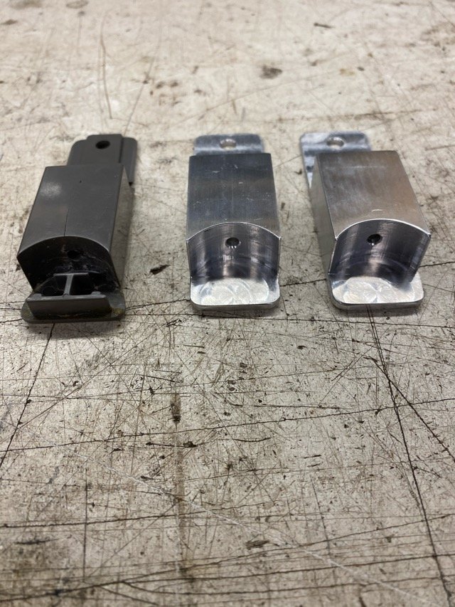

    Guy that lives up the street from me ask me to make him two brackets for his fridge for his beach condo about a month ago. Finally got them done cause his worker has been bugging me. He’s a multimillionaire :facepalm:

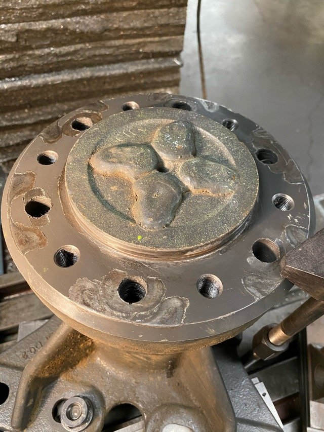

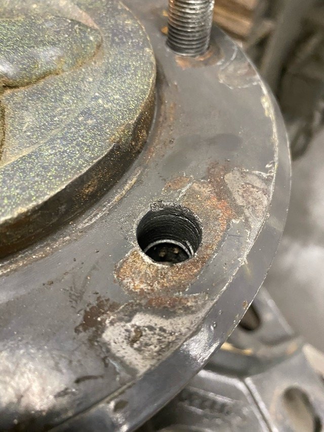

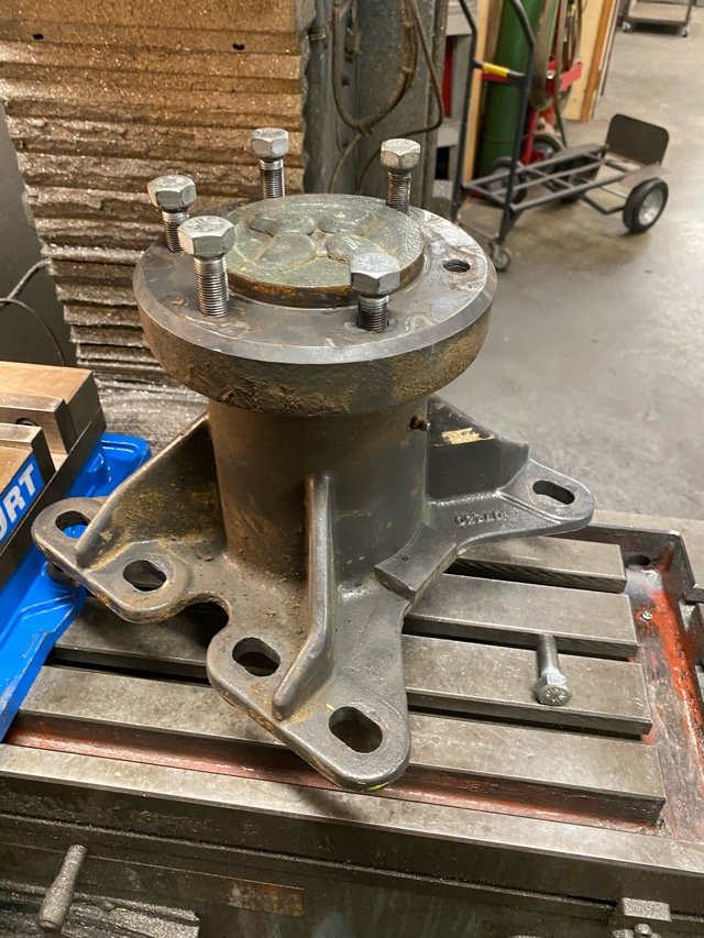

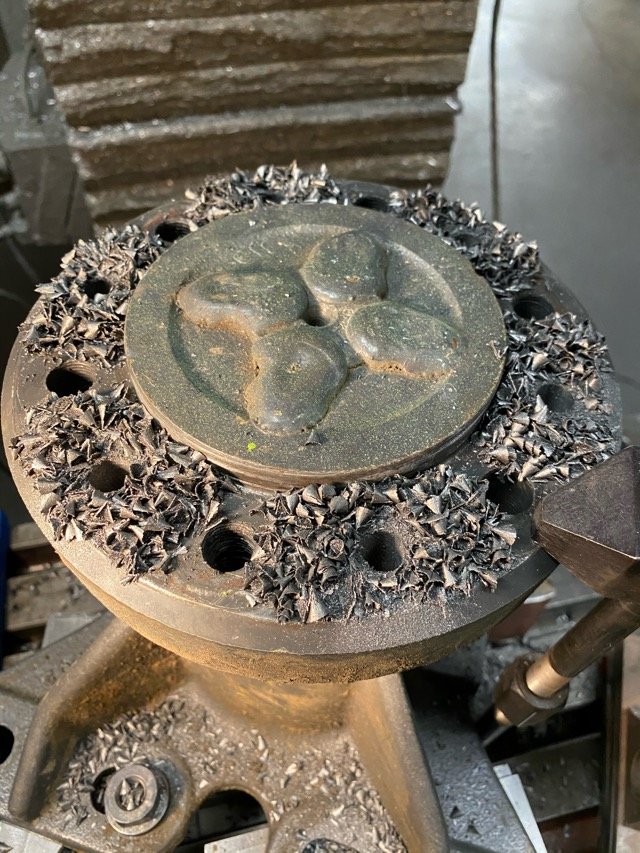

    Next hot one. Customer ask if I could fix these holes in this skidsteer axle, they’re supposed to be 1/2-20 but have been drilled and tapped 9/16-18 and now they are wollered out. I said it would be easier for me to just rotate the hole pattern and drill and tap new holes. He said I didn’t think about that, do it :D

    Got it clamp and indicated, let’s do this :D

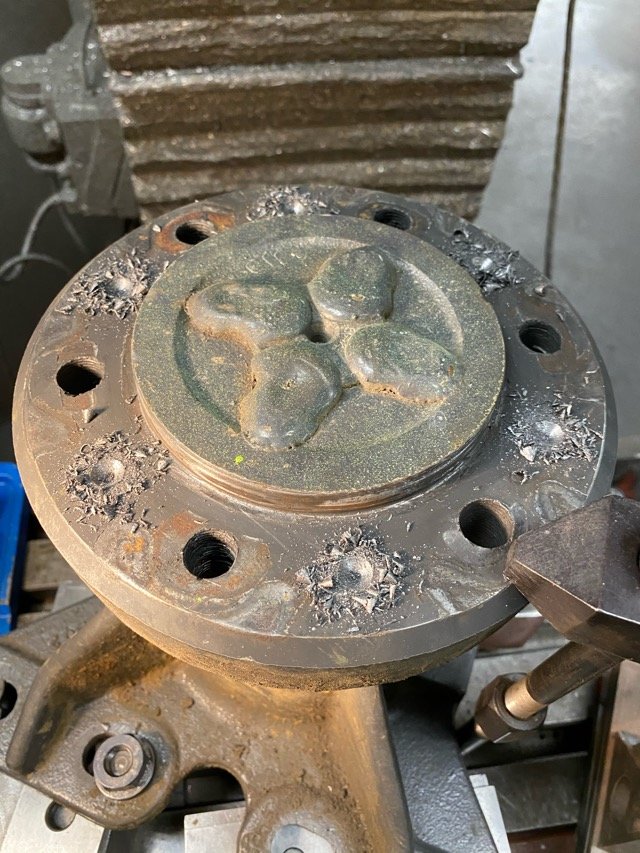

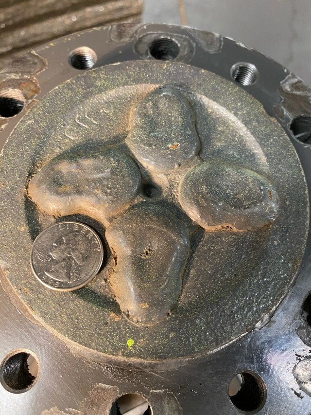

    Done. Check out the size of these welds.
