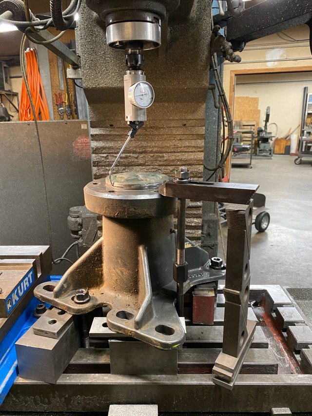

    Nice! I've got some longer pieces of 2x2 bar milled on the ends same lengths, and various sizes. Don't believe I've ever stacked toe clamp blocks like that, no problem with it just noticed. I also keep numerous lengths of 1/2-20 all-thread, meh, just prefer over fitting parts together.

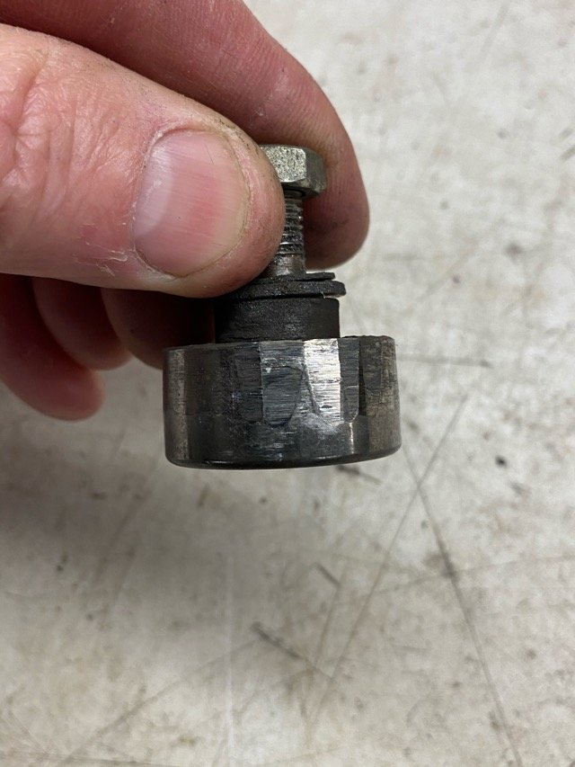

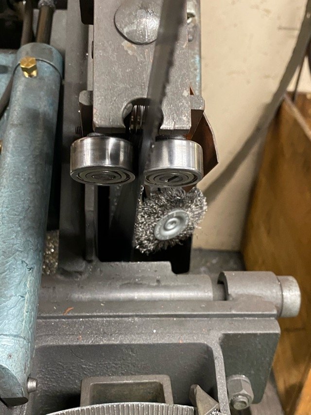

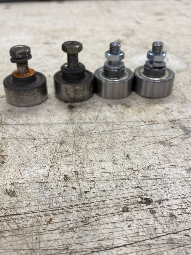

    Noticed the saw was cutting crooked the other day. One of the guide bearings went out. Been out for a while apparently.

    The toe clamps get wobbly stacking them if you spread them too far :thumbsup:

    Makes a huge difference! Our Marvel band saws have carbide guides that need turned once in a great while.
