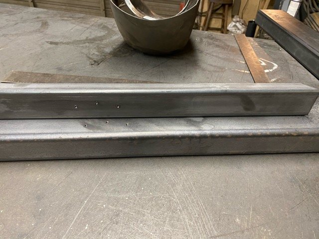

    The problem with these doors is they’re 1/2” too short. I would have to cut them in the middle of the holes and add the 1/2” if we go that route to match the frame. It’s already drilled and ready to weld too. May be easier to start from scratch.

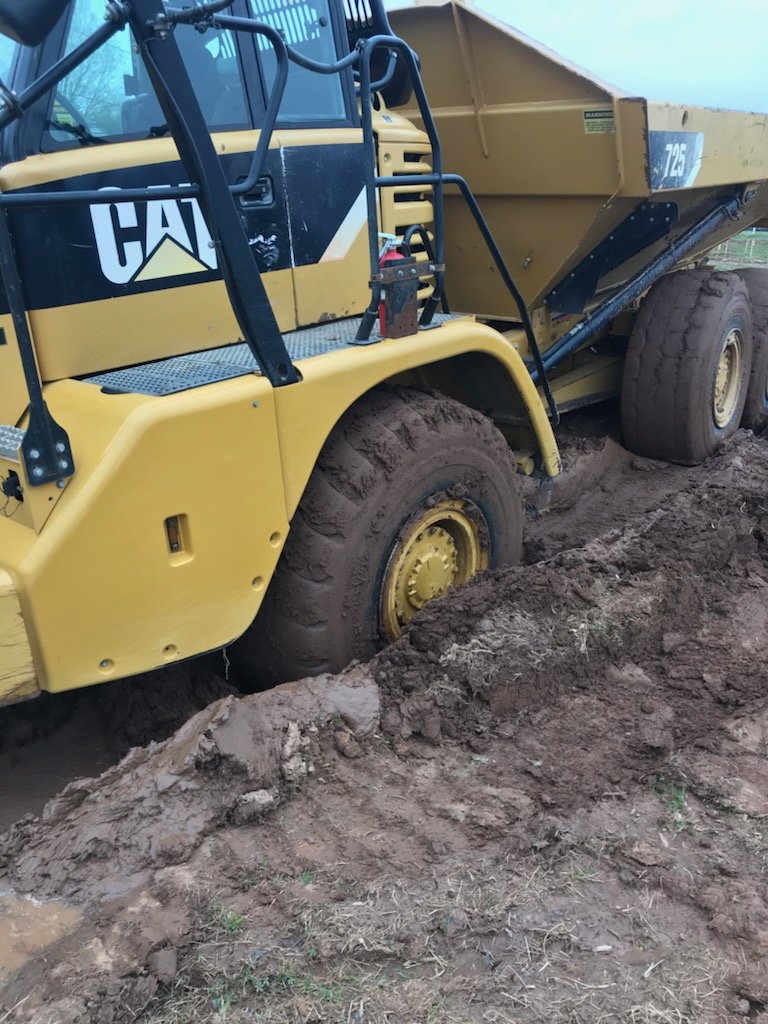

    upload_2021-4-1_7-52-12.jpgBrother joe says we delivered this to a customers property.... failed to mention that they just had fresh fill dirt which led to this truck sinking o_O

    That's not good!

    I talked the boss into ordering more material, it'll be easier in the long run.

    Shear a shim plate to weld in between the joint of the miter to make up the difference?

    I could cut them and add 1/2" but by the time I cut them, weld them, and grind all 8 it'll be about the same as making them over. Plus trying to keep them straight and this is a new customer, our first job for them. If it was one or two pieces it wouldn't be bad.

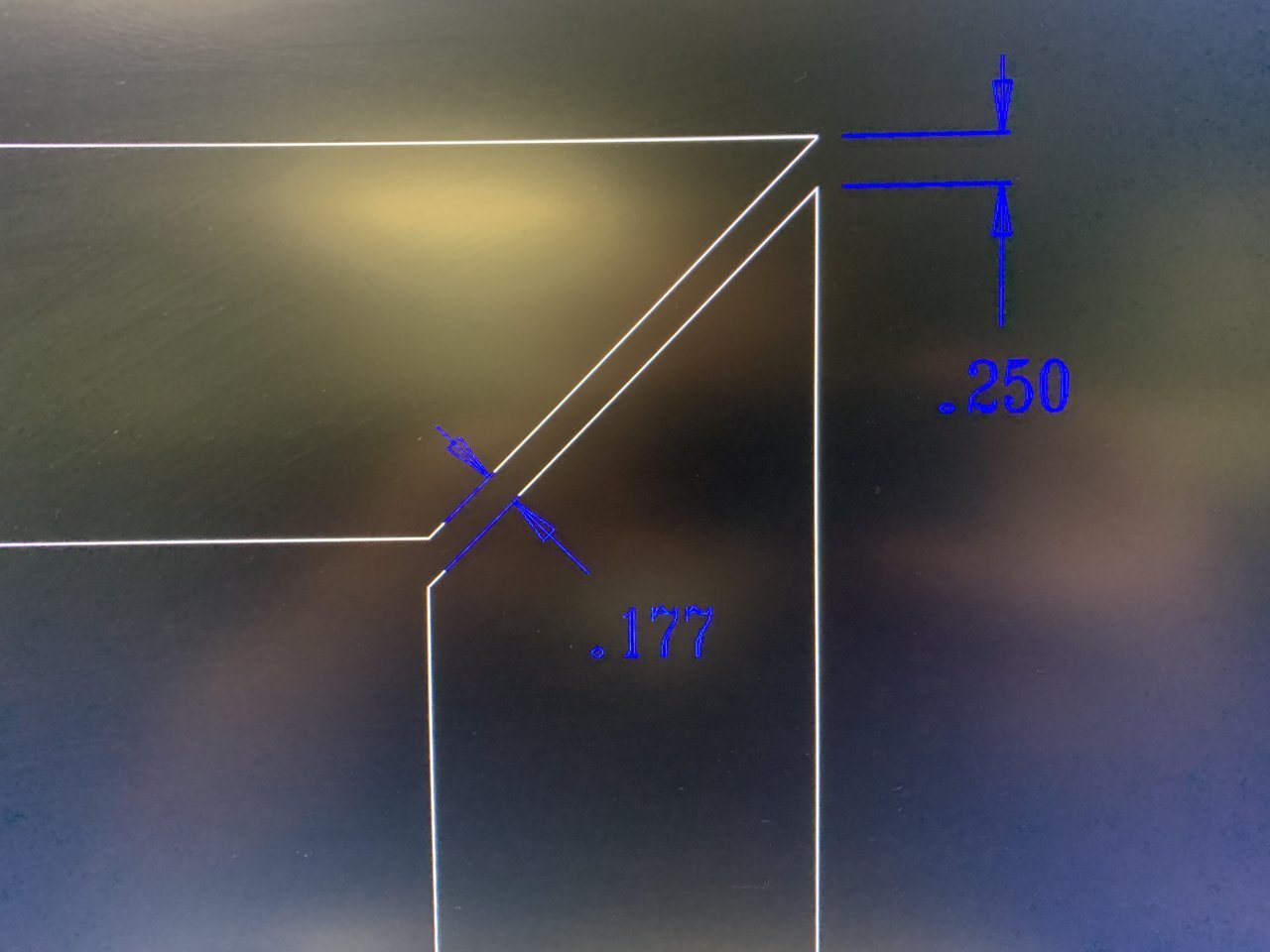

    I’m talking about adding a roughly 3/16” or 7 gauge (.179”) plate inside the miter joint on both ends, this would move the upper and lower tube 1/4” each end.
    See my cad math...

    I’ve put the holes in both pieces already for the hinges. The bottom ones are 1/2” high. Would have to weld them and redo them and add it all to one end :pout:

    I gotcha, so the hole patterns in relation to the end would be off, I was hopeful the pattern was located off the center.
    At least you might be able to use the drop from this job on another project. :pout:
    (As you can tell, I’m used to trying to come up with “Apollo 13” style solutions for damage control, lol)

    I get it, we have this material and it could be salvaged if I had too :cheers:
