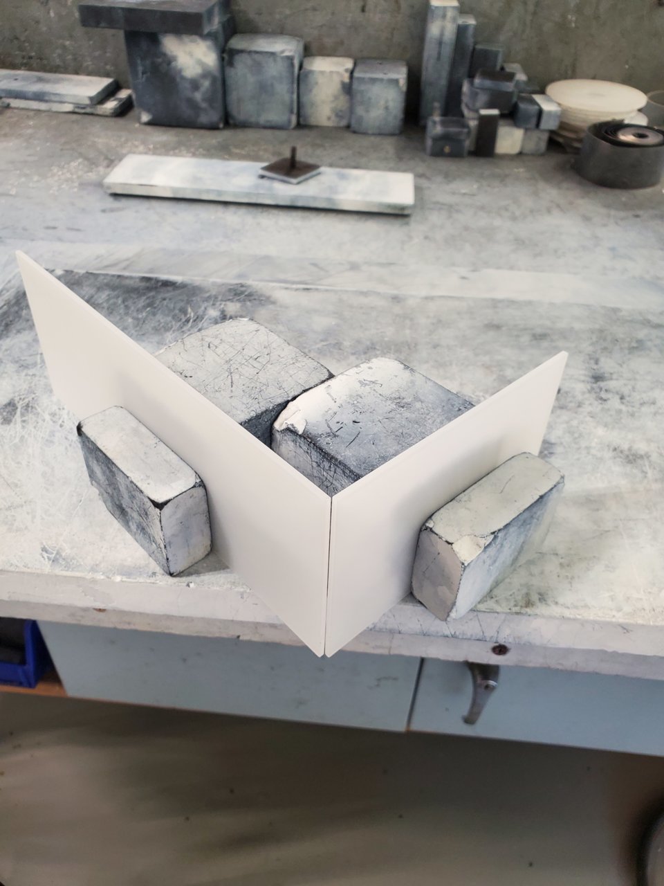

    A while ago I think someone asked about how quartz welding is done, well heres a pic of 2 sides of a tank I set up to weld. Blocks keep it square, we like blocks (graphite). I'll weld them together using hand torches and quartz rod. Today ill only weld the 4 sides together then anneal it to remove the strain before I weld on the bottom plate. After that, it'll get lapped on all sides and corners to return flatness. Finally it will be sandblasted to an opaque, smooth finish. I'll try to get some more pics along the way.

    This is always intrigued me. Never known anyone that does it.

    +1 on this ^^^^
    I think it's super neat!

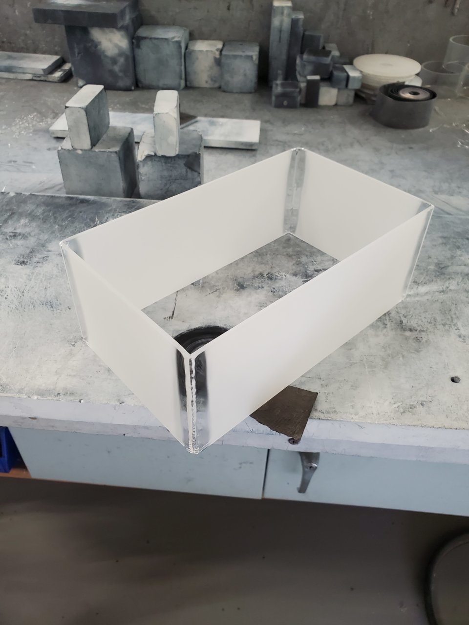

    Here it is with the 4 sides welded up, thats it for this one until tomorrow. I've got 6 tanks to make. By the way the heat clears the opaque ground plate which is partly why they get sandblasted at the end. Looks better with a consistent finish.

    That is awesome, truly a form of art :thumbsup:

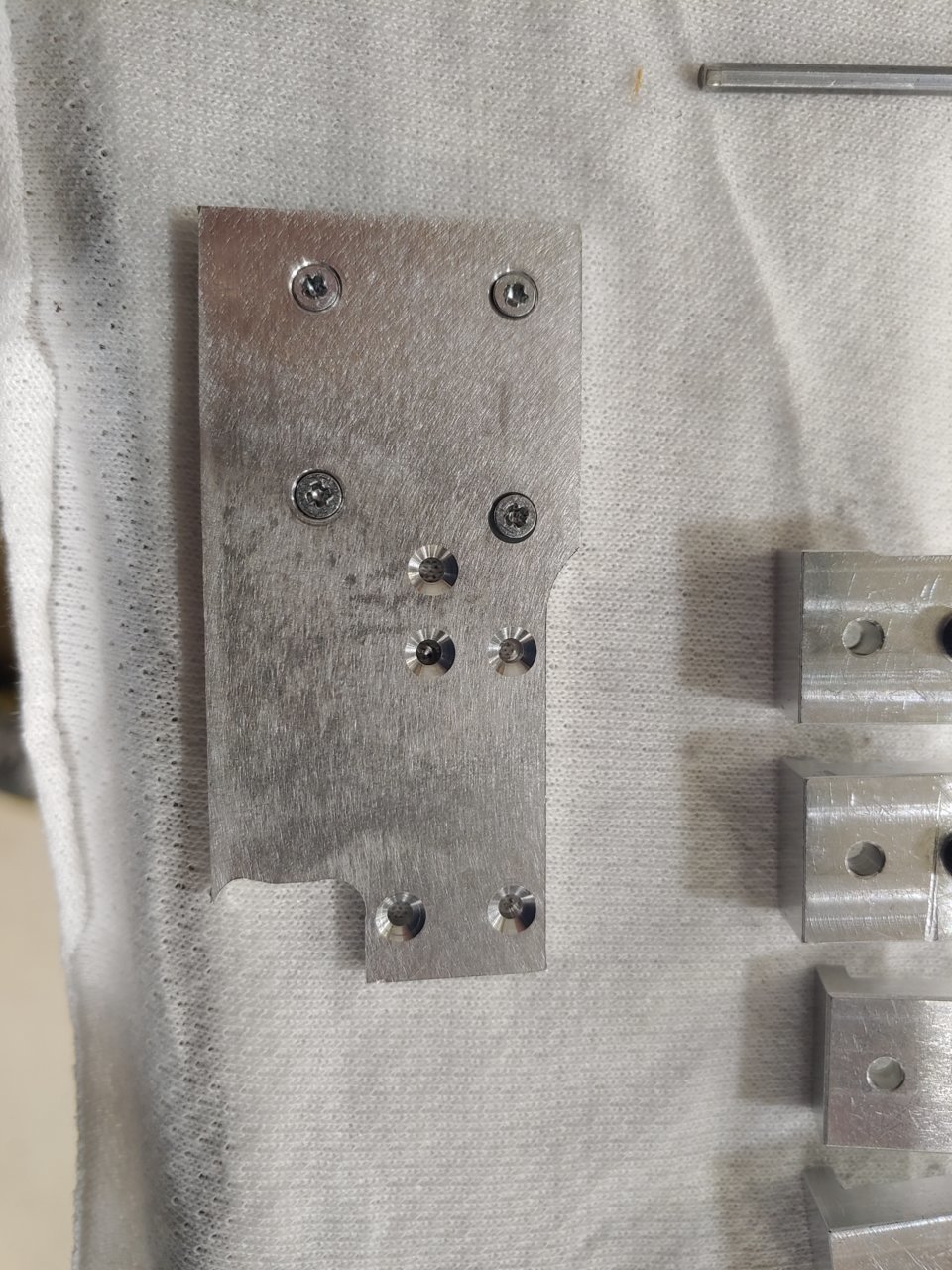

    If you guys remember when I was putting 2-56 helicoils in a fixture, well here is the reason. Had 6 screws holding the part down to finish the first side. While profiling the endmill launched the 2 missing ones and ripped the part out otherwise. Worn threads are weak, 18-8 stainless is a lot tougher than aluminum.
