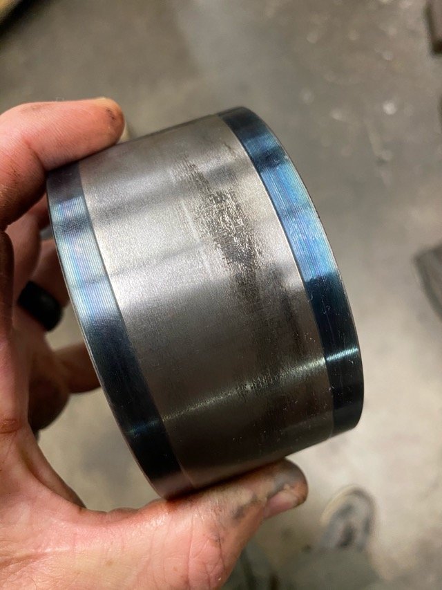

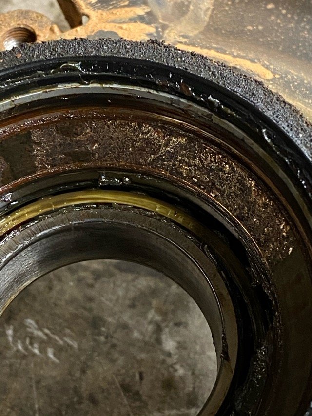

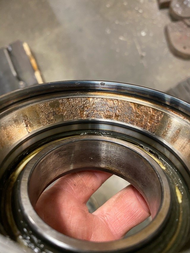

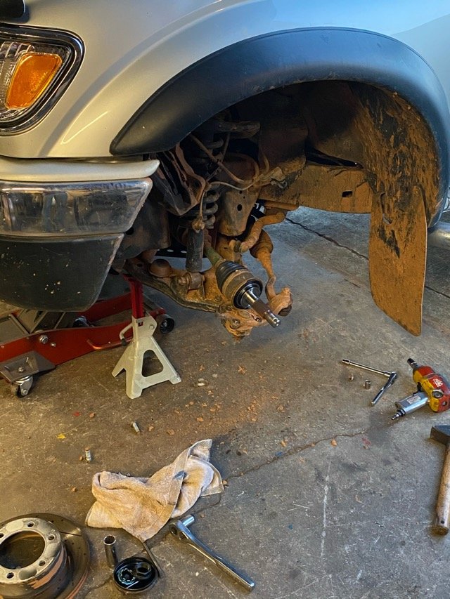

    I did the passenger side wheel bearing last week because it sounded like that was the side that was bad. I was wrong. The noise was still there. Took the drivers side off just now and found the culprit.
    The bearing itself looked okay, the race is what is messed up. Can’t complain at 201k miles :D

    I'd say that is FUBAR, toss it :D

    Believe me, it’s gone :)

    She gone. There’s a little discoloration on the outside where it’s been getting hot.

    Little toasty in there lol. Any particular reason on the National Bearings instead of Timken or Moog?

    Only reason is because it's what O'Reilly auto parts had near me. The old one is a Timken.

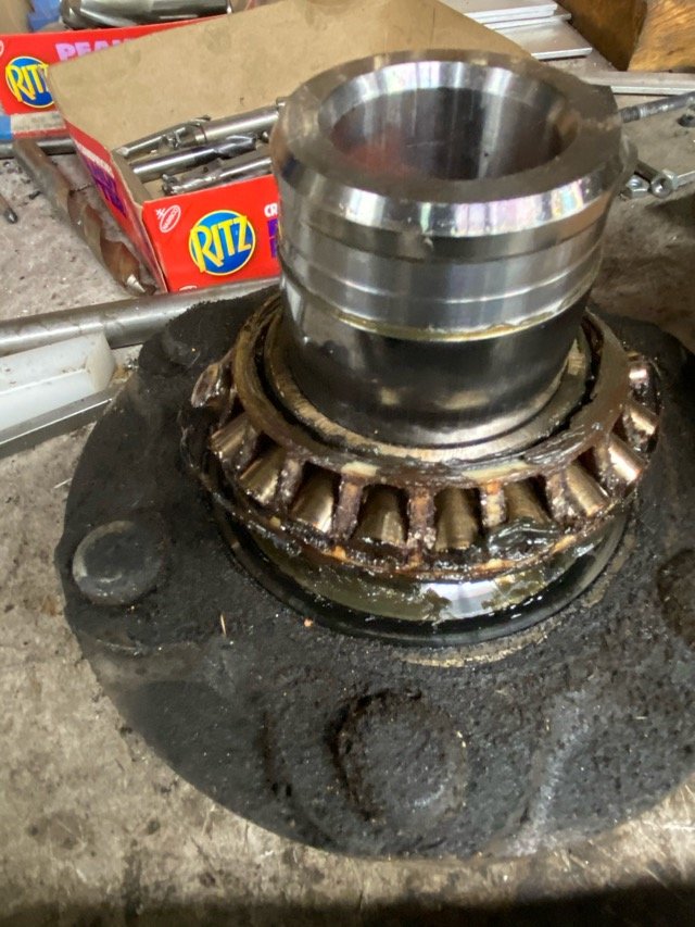

    Don’t try this at home kids.
  12. Oct 22, 2020 at 5:43 AM
    #1612
    tacobell007
    tacobell007 Western Mass Automotive Coatings
    Jun 11, 2009
    #18327
    11,609
    Drew
    Western MA
    06 Regular Cab Lifted
    Eibach springs, OME Dakars, Walker Evans remote resi coilovers with adjustable dampening, Icon tubular uniball UCAs, Icon ext travel rear shocks, Kenwood in-dash nav receiver, Kicker 10 inch sub in a ported truck box, Alpine 250 watt amp, stickers, Rigid 32" gang box, LED tool box lights, 35% tint, Flowmaster Super 44 muffler, 35x12.5x17 Mastercraft Courser MXT's, Fuel Off-Road Trophy d551 in 17x8.5, Retros, white corner marker bulbs, color matched front grille, custom satoshi grille mod with matching Toyota badge, aFe Pro5R drop in filter, diff breather mod, new frame from recall, SOS concepts front plate, SOS concepts rear high clearance plate with swing out and full size spare, SOS bolt-on sliders with kickout, 22" LED bar, flush mount pods in rear plate bumper for aux reverse lights, Rigid Industries dually's on SOS ditch light brackets, 5.29 Nitro gears, ARB front air locker, Detroit locker in the rear
    You could have also ramped up the voltage on a tig or mig and just laid a bead on it, the slammed it against a piece of wood. Thats how we did my rear bearing retainers. The heat creates enough of gap that it will come off. Looks like you got it off cleanly though :thumbsup:

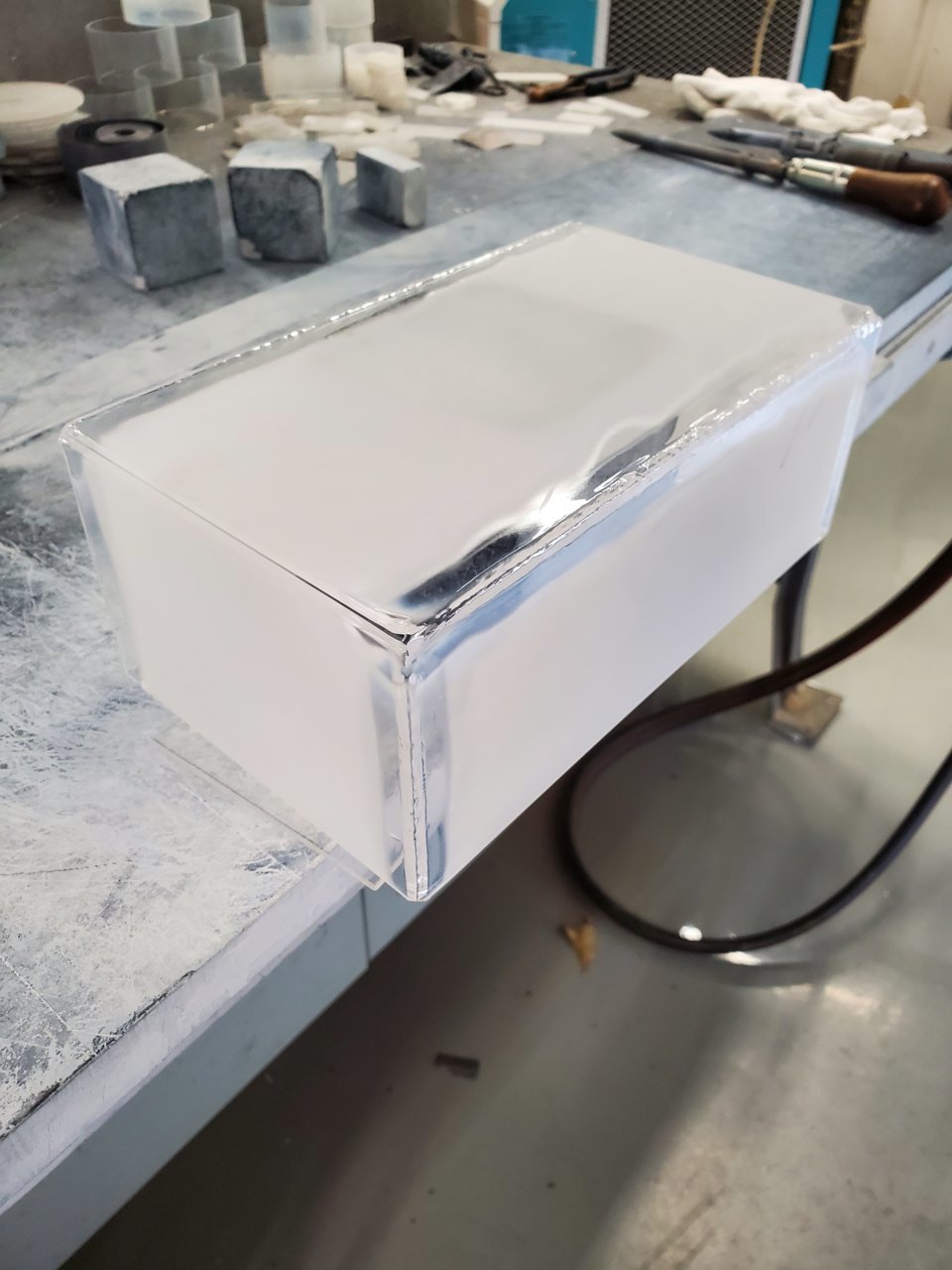

    Got the 2 long welds done on the tank bottom. I could have gone ahead and welded all 4 sides of the bottom today but that would produce even more strain in the glass than welding 2 sides causes, and I happen to only have an exact number of pieces for these things. Better safe than sorry so ill anneal again tonight and make the final welds tomorrow. After that it'll have to be annealed again before grinding it flat again lol glass is a pain in the ass.
  17. Oct 22, 2020 at 6:47 AM
    #1617
    six5crèéd
    six5crèéd [OP] Be the light
    Jul 9, 2019
    #298734
    35,970
    Southern Virginia
    8 lugs no plugs
    How do you anneal glass?
    tacobell007 and Bigdaddy4760 like this.
  18. Oct 22, 2020 at 6:48 AM
    #1618
    DLRIII
    DLRIII Well-Known Member
    Feb 27, 2018
    #245744
    1,977
    David
    Baton Rouge
    2018 Quicksand SR5 DCSB V6
    We put the work pieces in large ovens or kilns that heat the whole part evenly over a few hours and then they cool overnight, this even heating removes the strain caused by heating isolated areas.
