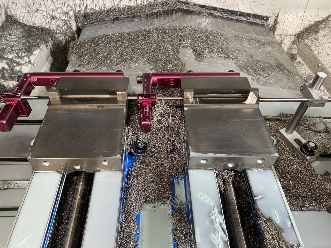

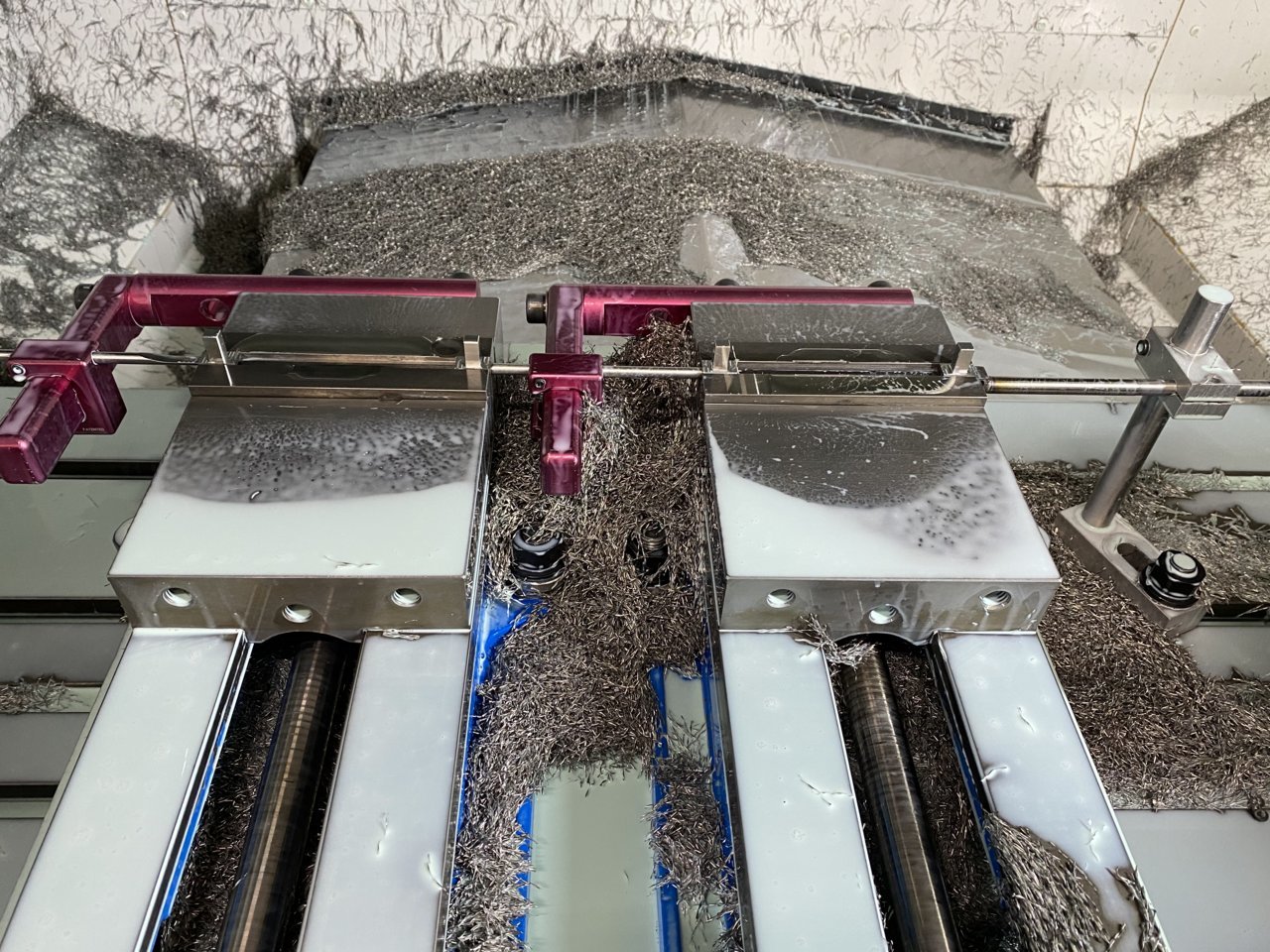

    Neat setup, I know it took a little time and programming but it’s worth it when doing multiple parts :thumbsup:

    actually wasn’t bad on the setup and programming. Already had it programmed for 1 so just had to change when I posted it to the machine from a single part to 4 parts. A few minutes with the probe to set 4 work shifts and I was in business. Got about 90 runs done today after setup.
