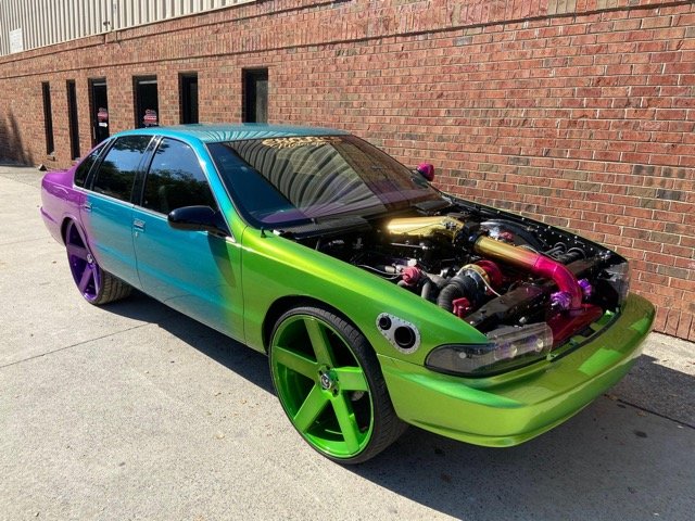

    Here’s the 1995 caprice with the LS7 with twin turbos. It’s ugly as I don’t know what. He put it on the dyno the other day and got 693HP out of it, as a start :D
    Did I mention it’s ugly? :eek:
    How about that fender exhaust?

    Dayum! To each there own though

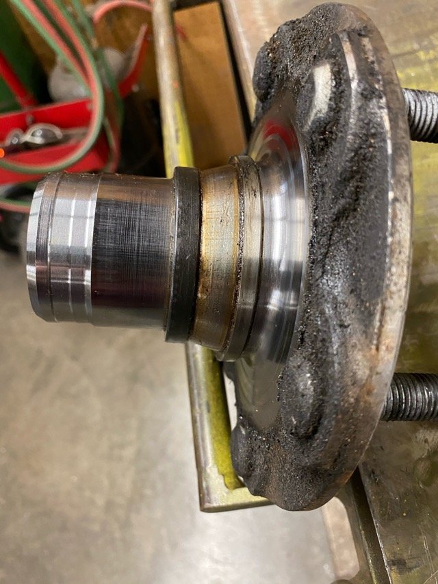

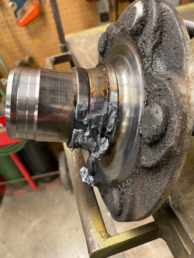

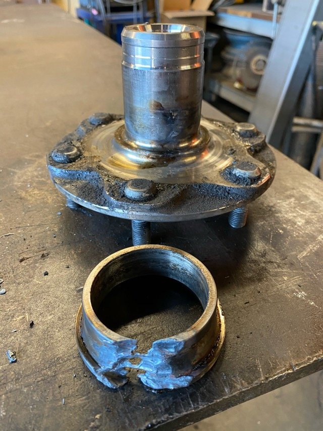

    I’ve welded a bead on the inside of a stuck race with a mig, then when it cools it contracts and is easier to pop out. Would the same thing work welding on the outside of a stuck inner race?

    I’ve welded inner stuck races before and they fall out, I should have tried it on this one to see what would happen.

    Yes it does work. Inner or outer bearing race.
