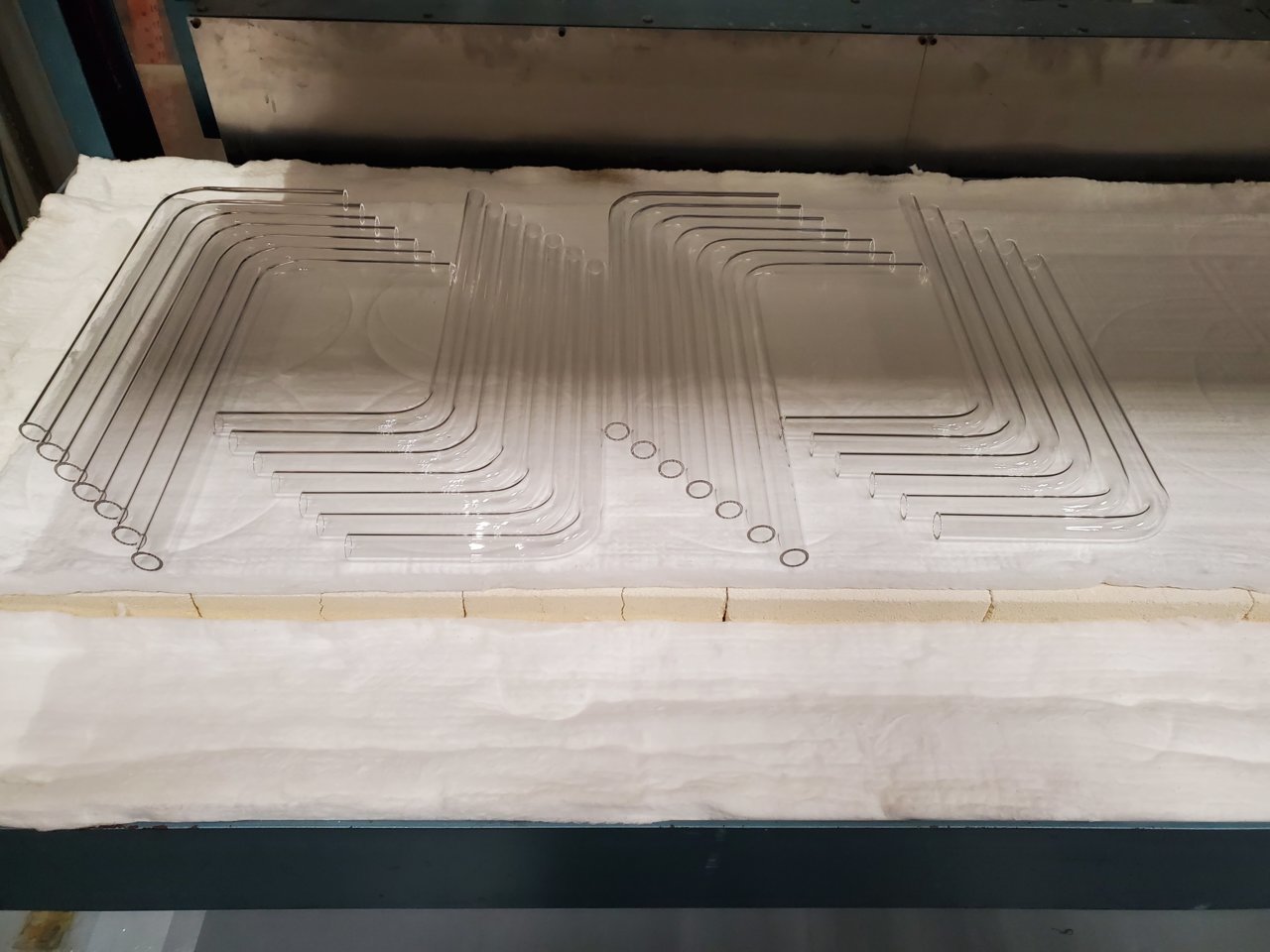

    Here are some 1" diameter tubes I bent on Friday coming out of the oven this morning. I had 2 crack from strain so ill repair them and aneal them again.

    How are you going repair those tubes?

    How do you bend those and not have them collapse?

    The cracks are small so ill just heat up the cracked area slowly and they will most likely seal themselves up. This tubing is thick walled and that makes sealing the cracks more successful, thinner walled glass will just distort as you heat it enough to seal the crack.

    I put corks in both ends, one with an air hose and after I bend it I blow the collapsed areas back out.

    That’s awesome! Such a simple solution.
    Thanks for sharing!

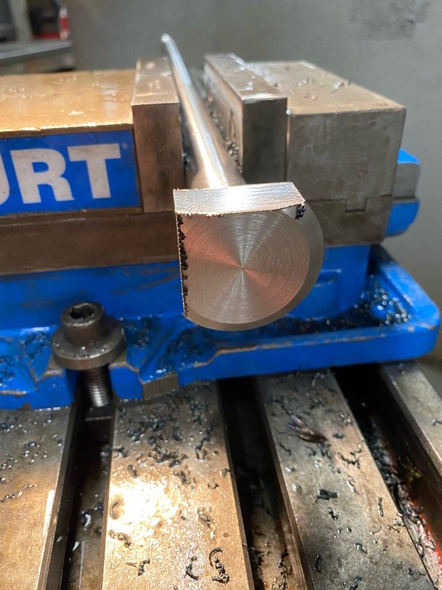

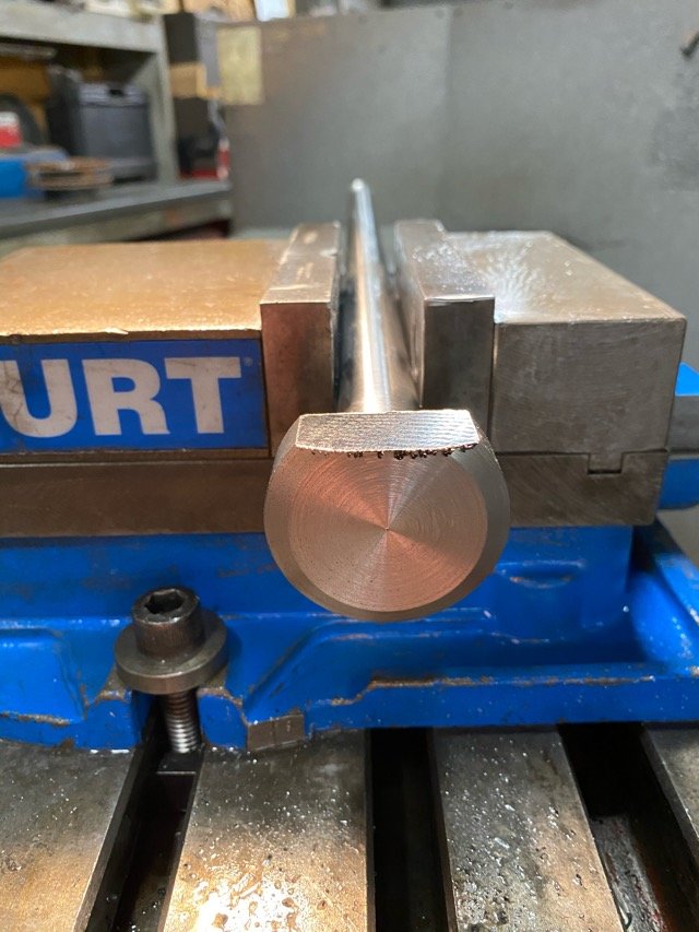

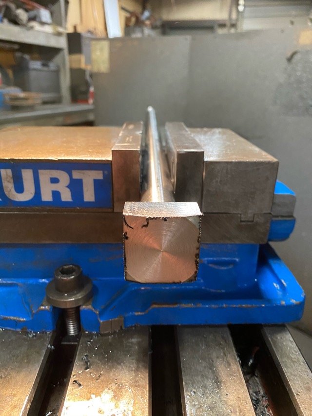

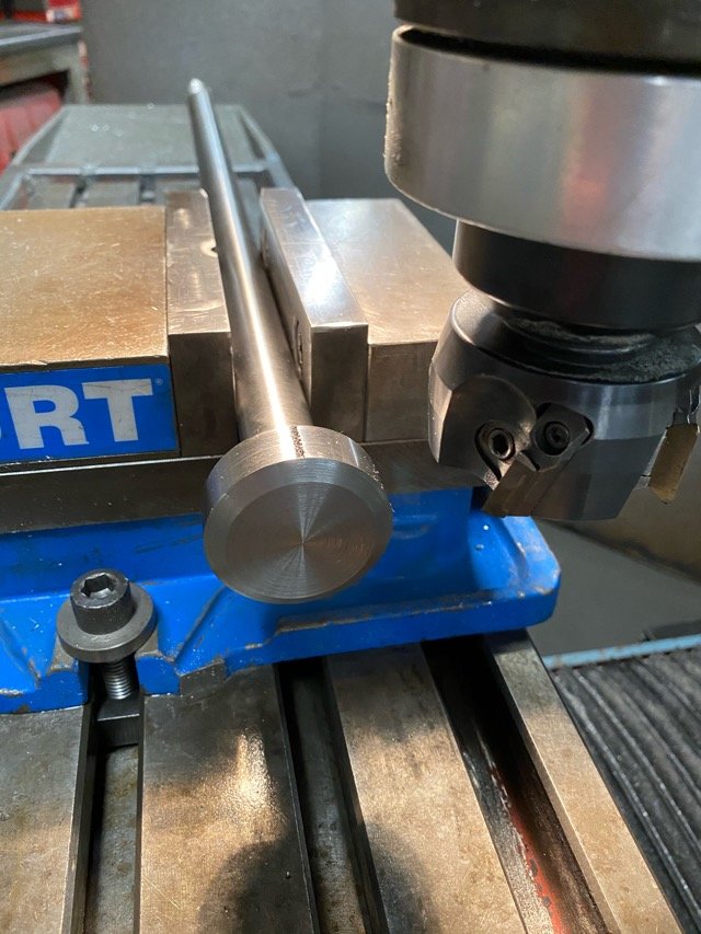

    I got to finish this bolt. It’s M24 x 3 thread with a 35.5 mm square head :thumbsup:

    35.5mm head to fit a 36mm 4pt socket?

    It goes in a tail stock on a lathe, for one of our customers who is another machine shop, go figure.

    Where? I can't imagine where it would go at on a tailstock...

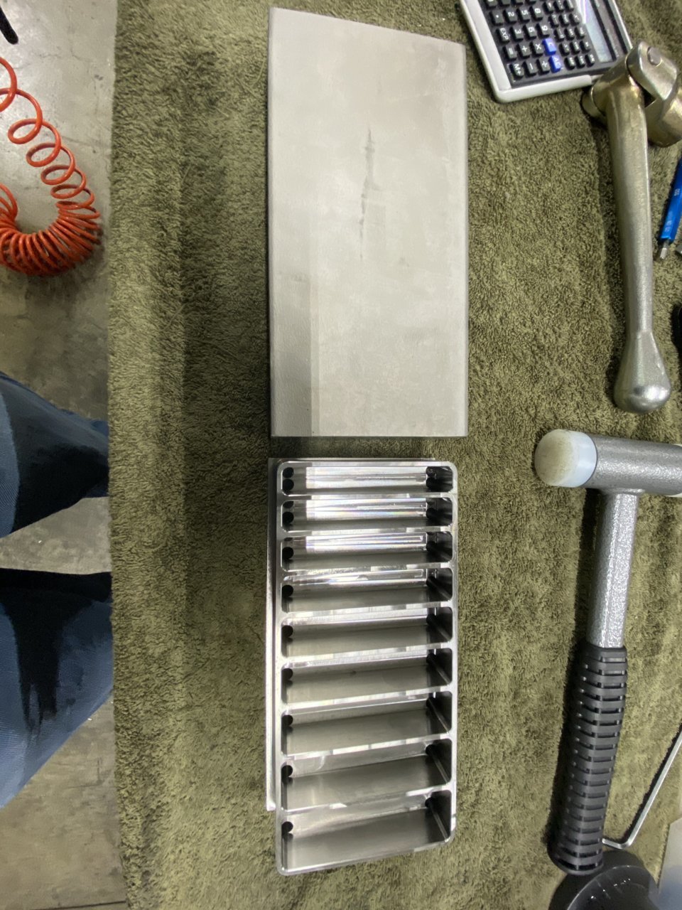

    Some big chunks of 304 going through the shop today.

    It goes on their lathe with a 20’ bed, it’s large. It’s the bolt that goes from top to bottom to lock it.

    Oh. I thought all tailstocks were cam/friction locked.
