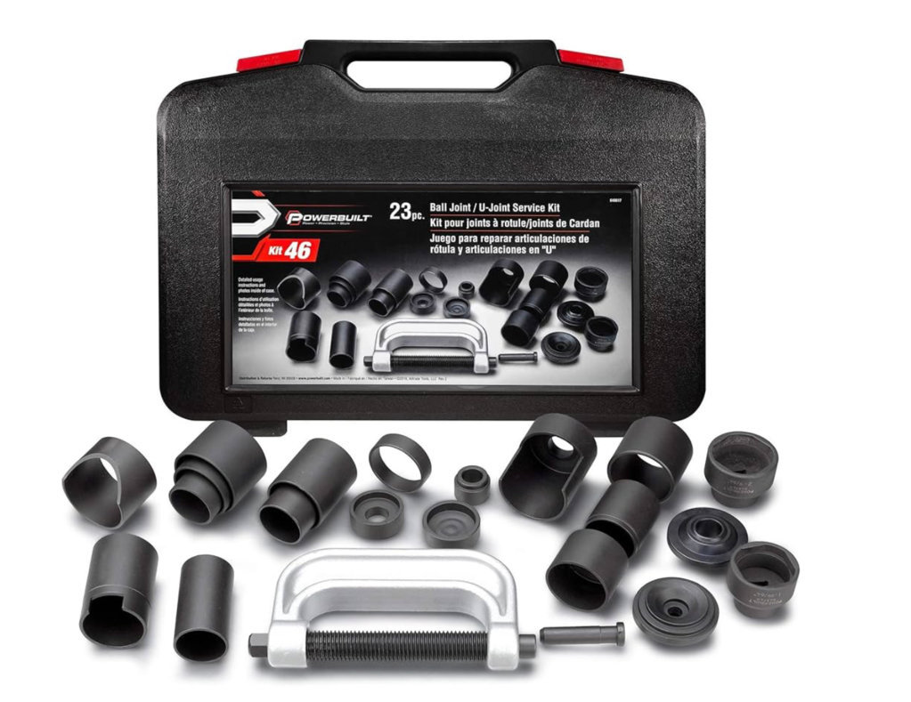

    I have the specific ball joint tool kit(bought to do my 3rd gen) if you need to borrow it, the cup sizes in most kits do not fit the tacomas(odd sized) so i had to order this specific tool kit. Shoot me a DM, I’m in N county(Vista) but work on Pendleton too.IMG_0370.jpg

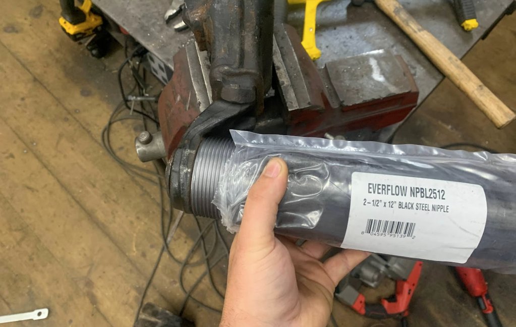

    A 2.5" pipe nipple works perfect. Just cut a chunk off and press it out. Mine where siezed and needed some heat and alot of persuasion.
