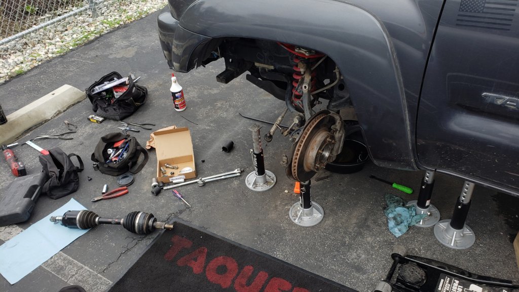

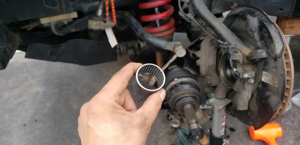

    Honestly I was afraid of this myself but if you don’t need to pull the whole CV it’s maybe a 3 bolt job…
    I had to replace a bad axle and changed the diff fluid and did the bushing while I was in there. Whole job took about an hour, so if you skip all that extra stuff you’re removing the 2 lower bolts from the control arm, pop the inner CV out and swing it aside. Then use the bearing puller to get the needle bearing out and place the bushing.

    Whole cv needs to be removed, axle bolt bottom 2 knuckle bolts, tie rod, sway bar link

    This is so completely false. I did my ECGS bushing install without completely removing the CV. Just as @DailyTacoMD said. There are tons of YT videos. My axle nut was seized and once I found the procedure to do it without removing the CV completely I was thrilled because it was much, much less complicated.

    Sorry I know what I'm doing and did it the right way! Watch the brake lines and speed sensor if half assing the job.

    First of all, you essentially said it couldn’t be done that way which isn’t true. Now you’ve admitted that it is indeed possible.
    Second, neither method is any more “right” than the other. Leaving the CV axle attached to the wheel isn’t half assed, it’s quite a bit more efficient as long as it’s supported while disconnected from the diff. I would love to hear you explain why complete disassembly of the suspension is a) necessary and/or b) “right”. There are some pros and cons, but one big pro to not completely removing the CV axle is it’s much easier to reinstall if you are doing the work alone. The con is that you have a little bit less space to work on the diff, but it’s not very noticeable.
