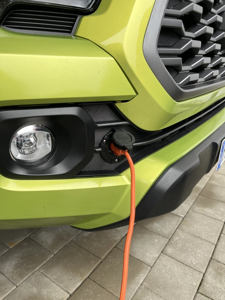

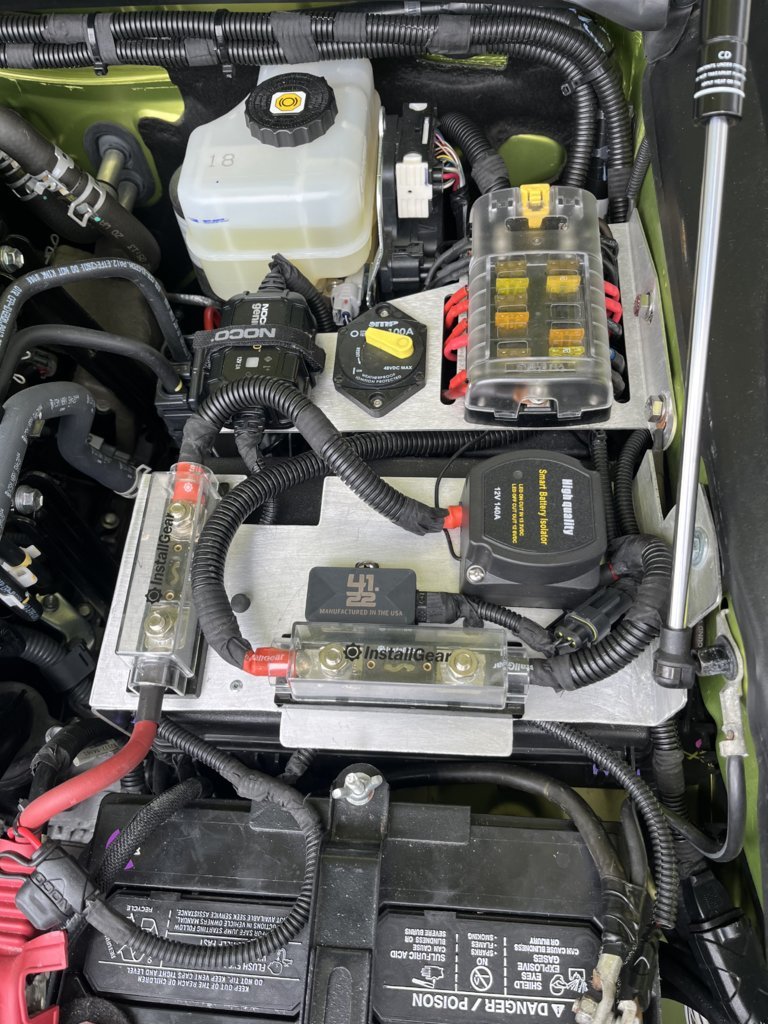

    I installed a NOCO 2D and a NOCO outlet. Happy with the setup.

    That looks terrific, @nds0000. Super clean installation.

    Did you make the Trays that all of the Components are on? Or are those purchased?

    The one with the fuse box is purchased, the other ine with the isolator and the kill switch is self made.

    What brand is the Purchased one? You did a Nice Job on the Self Made Tray.
