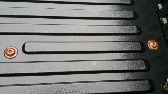

    Has anyone replaced these with Stainless?20150305_171009_94a5f397d3677f1bd7f8e4a87aab58242fd22e84.jpg

    I took mine out one at a time and put anti-seize on the threads so they wouldn't ever get stuck in there

    I've thought about doing duracoat or powder coating them. It wouldn't scratch off as easy. But if I knew the size I'd probably try to find stainless
    Like you said though I'd have to do it 1 at a time

    You could take one out and get the size and thread pitch that way

    They are pretty custom hope you got deep pockets. Take them out and have them chrome plated probably would be cheaper.

    I would just paint them myself

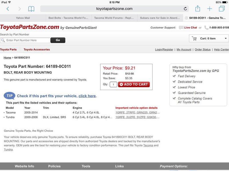

    Part number and info for new ones.

    I had one rusting on me pretty badly. I took it out, cleaned it up, applied a light coat of grease on it put it back, and sealed around the washer with roofing sealant.

    Those are the Galvanized replacements for the original bolts, not sure when they switched to galvanized. I got one at the dealer about a year ago, I'm thinking it was around $13. Its a PITA to get the old ones out once they rust into place.
    Toyota Part Number: 64189-04020, Replaced By:64189-0C011.

    The bolt threads can be partially cleaned and lubricated from under the truck, before removal. As I recall it protrudes 1/2" from the frame. The galvy ones are good, but if the coating is compromised, it will begin corroding.

    Bolt size is M12x1.25x3.75" which is 95.25mm which is almost impossible to find
