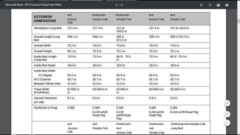

    What measurements are you looking for?

    That link didnt work, how about this one?
    2015 bed dimensions, should be the same for 05-15.
