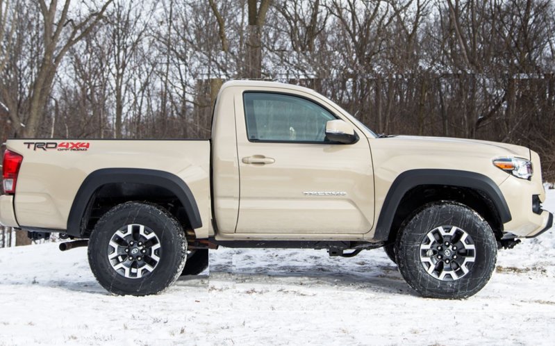

    I'm curious what problems would be encountered if I wanted to put a 1st gen DC bed on a 1st gen reg cab frame? Do the bed mounts not line up? Or do they line up and it is as simple as ditching the little frame-to-bumper assembly pieces?
    And does anybody have a picture of this setup?
  4. Dec 30, 2015 at 1:06 PM
    #24
    tgear.shead
    tgear.shead Well-Known Member
    Aug 20, 2015
    #162276
    1,734
    You need to think carefully about where the wheels line up with the bed. What you will find out, is that you would have to set the bed back on the frame (i.e., with a huge gap between the back of the cab and front of the bed) in order for the wheels to line up.
    In other words, doing surgery like this isn't a simple matter of putting on the shorter bed and lopping off the back end a bit, but rather the back wheels would need to be moved forward. That means that the frame gets shortened in the MIDDLE.
    I very strongly advise against this kind of modification.
    Now just shortening it off at the back? Go for it. Unfortunately, a short box is not going to help with this kind of thing.

    Reminds me of the guys who do the shortened bed on super dutys
  7. Jan 6, 2016 at 11:24 AM
    #27
    zmw
    zmw Well-Known Member
    Apr 20, 2014
    #128112
    307
    SATX
    2014 TXproBAJA
    none
    all pro's black betty build has a bobbed bed also, if you plan on using it as a truck not so awesome, but awesome for departure angle!

    There are a number of places that will do the conversion for round 3-5k done right...

    Makes me wonder if the new Ranger will have a shortbox Reg cab 4x4...
