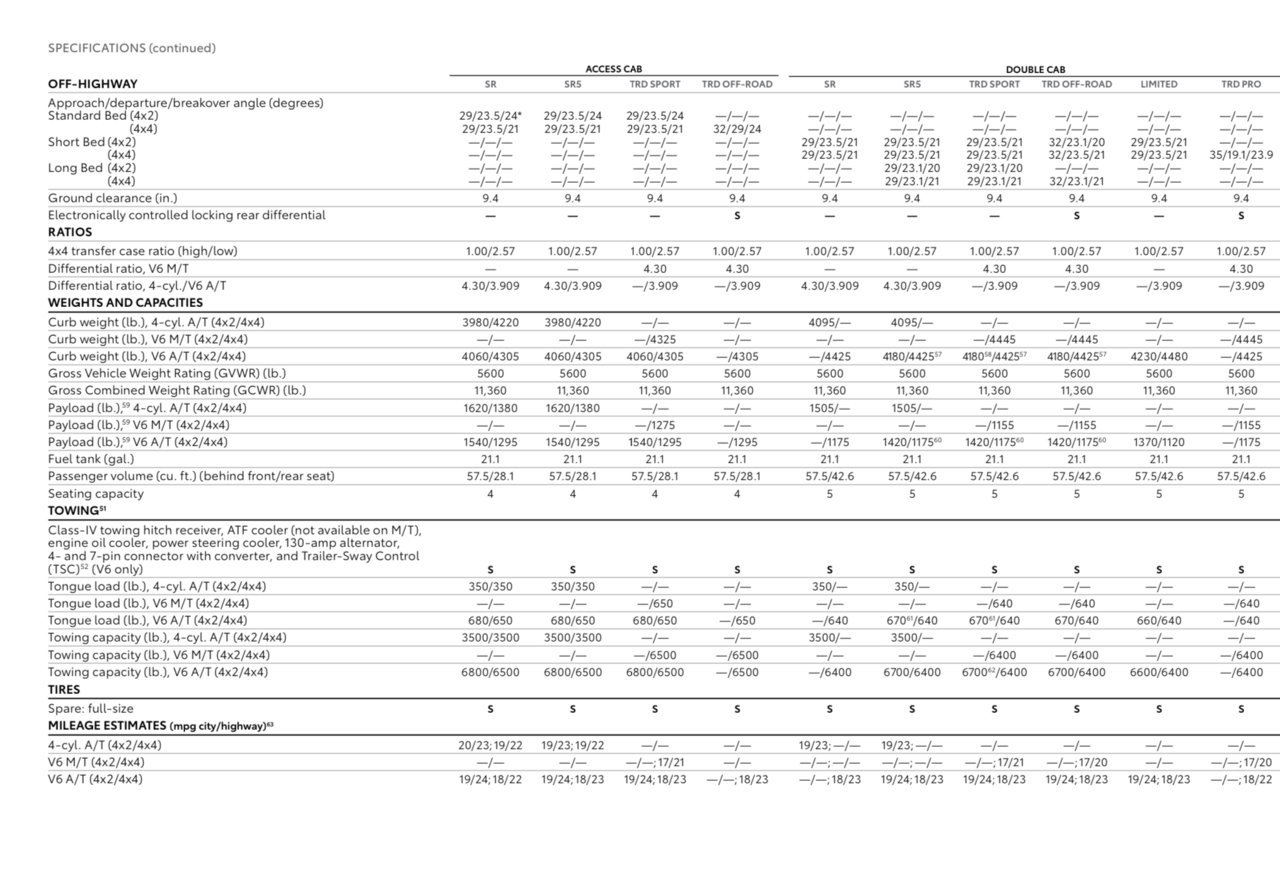

  6. Nov 5, 2020 at 7:45 PM
    TnShooter
    TnShooter The TacomaWorld Stray
    Sep 2, 2010
    #42625
    21,302
    Deogee
    07' TRD Off-Road, Auto
    STOCK
    This is from the 2020 Brochure

  8. Nov 5, 2020 at 7:50 PM
    CT Yankee
    CT Yankee Well-Known Member
    Dec 26, 2014
    #144946
    2,066
    CT
    2021 TRD OR AC AT MGM
    Only aesthetic mods so far Leer 180 cap & Clazzio covers on order.
    From TnShooter's response you can see there's about 110 lb difference between Access Cab & Double Cab. You lose weight with the shorter bed and gain weight from the additional sheetmetal & glass in the cab. If you're looking for the weight of the bed alone, that's gonna be difficult to find.
