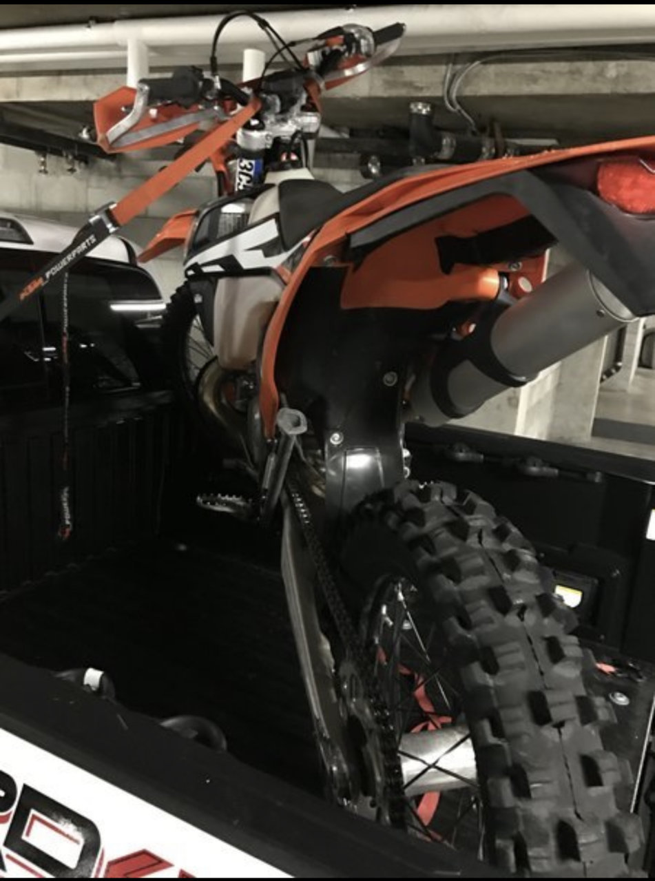

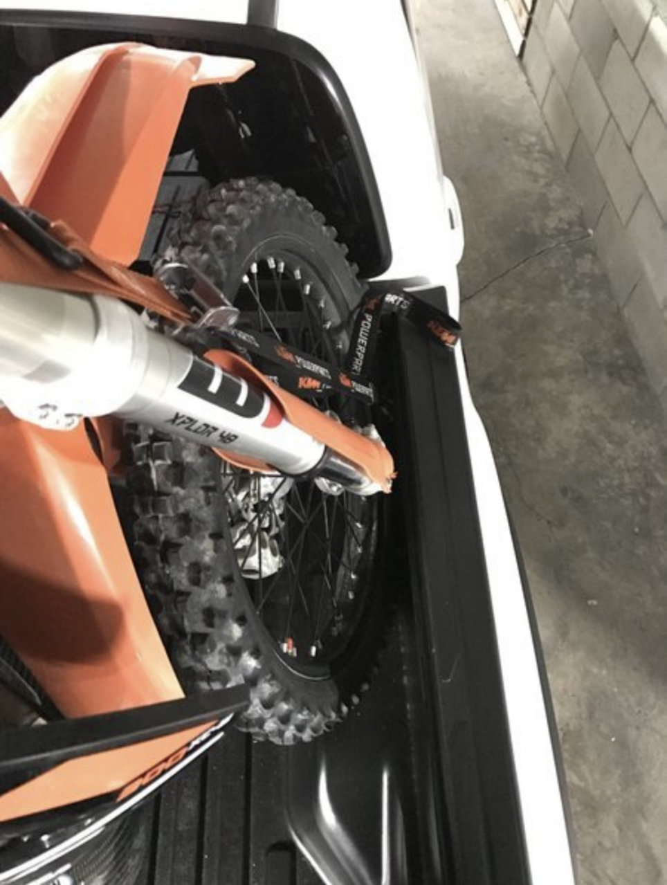

    I dont think you can with a short bed with a normal sized bike. There are some pictures in here...
    Short beds and dirtbikes. | Tacoma World
    The weight on the tailgate is a non issue. Ill regularly load 2 bikes with the tire on the tailgate, no issues. But Ill mention that I dont really trust the side rails. I use the side loops...
    2016-toyota-tacoma-bed-jpg.2208740 (1280×960) (twstatic.net)
    and I added D-rings to the front bed bolts for carrying more bikes. And when they are snugged down it takes most the weight off of the back wheel.
    This short bed is embarrassingly small.

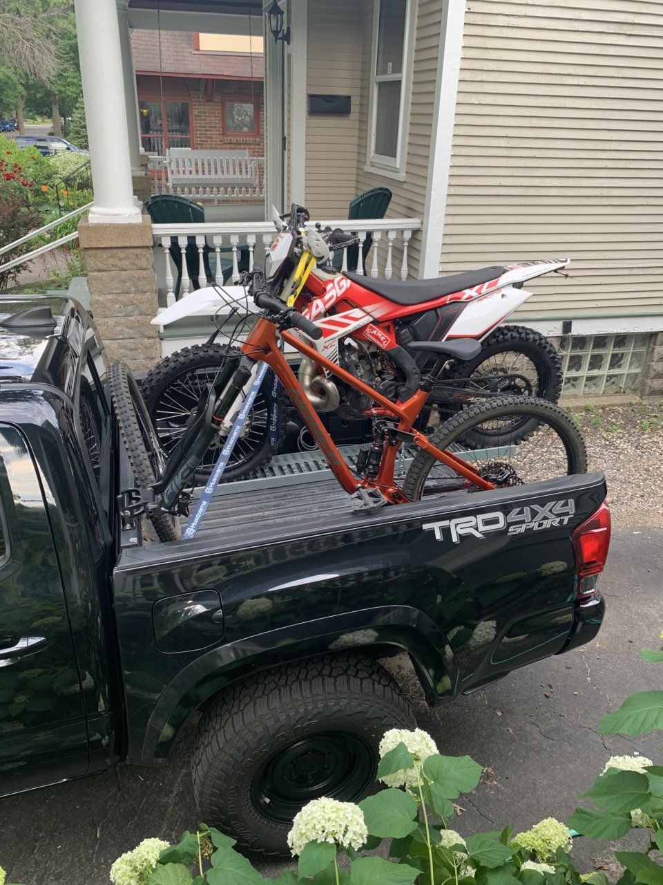

    I’ve seen people make a channel out of wood to hold the wheels securely-it would extend out the back to support the rear wheel. They had two bikes in the back with two channels. They probably had spacers between them and the sides to keep them from sliding around also.
    There’s a member here on TW that posted a really neat one he made out of wood, I’ll try to find it.

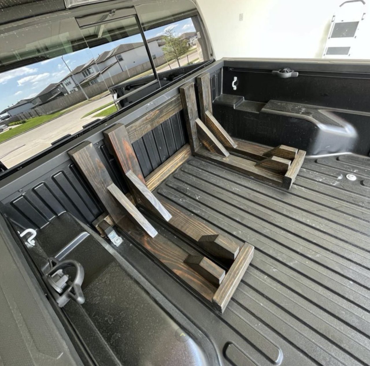

    Someone made this as a home product. Make a back part of the system that is a sheet for the read wheel distributing weight to reduce flexing on the gate hinge, as others said.

    @RichochetRabbit That’s a nice mount, I like it. I have a trail 90 I could do that with good idea! Only issue is I have a shelll, so it must to go on the back hitch and I bought a carrier for it from HF.
    I’m trying to figure out how to put a tandem on mine also, it’s too wide for the back hitch mount, so I leave it inside the bed, but on trips I’d like to hang it diagonally, somehow probably off the back with the front wheel taken off.

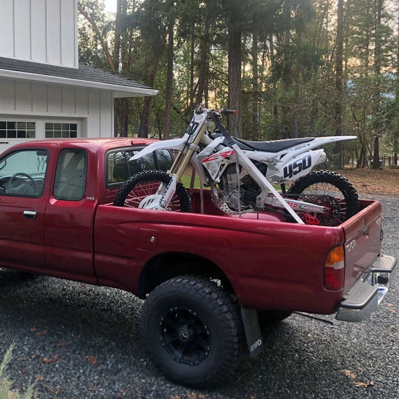

    I have not put a dirtbike in the Tacoma yet, but I had a Ranger and used to put it diagonally; The front tire in the L shaped corner of the drivers side bed-front tire 45 degree ish either side of the bed frame- slide the rear tire to the adjacent side, close the tailgate. Simple.
    This is not a Ranger, just the correct orientation

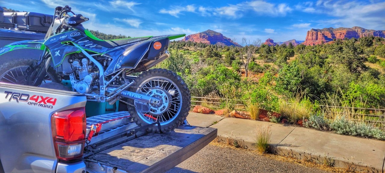

    I go in slightly diagonal w/ bars turned to left, and I stow/strap my ramp side to side between the wheels. Keeps the weight off the tail as much as possible, though it’s not much of a concern. The bulk of the bike weight is forward, vertically inline with the engine. I suppose I could go a bit more diagonally towards the passenger side and orient the rear tire to sit on top of the ramp, but doing so really seems unnecessary.

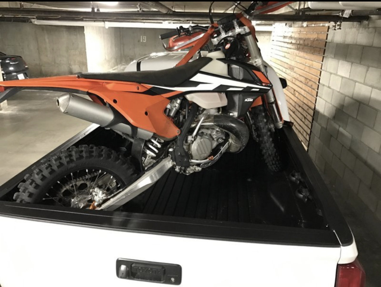

    Some dude managed to get his Kitoom in his shortbed and close his tailgate though, fyi.

    Diggin the wheels
  18. Jun 27, 2023 at 9:03 PM
    #18
    MGMDesertTaco
    MGMDesertTaco Come on, live a little...
    Jan 30, 2021
    #354573
    9,725
    That looks safe. :rolleyes:
    TwinTaco31719 likes this.
  19. Jun 27, 2023 at 9:05 PM
    #19
    TwinTaco31719
    TwinTaco31719 Well-Known Member
    Nov 16, 2019
    #310895
    7,842
    Eric
    Glenbrook, NV
    2023 Lunar Rock LB Sport
    Agreed :eek:
  20. Jun 27, 2023 at 9:10 PM
    #20
    desertdweller
    desertdweller Well-Known Member
    Aug 31, 2020
    #339346
    343
    jp
    Phoenix, AZ
    2019 TRD OffRoad
    It’s a 220lb moto. Tied down competently, this orientation is perfectly fine.
