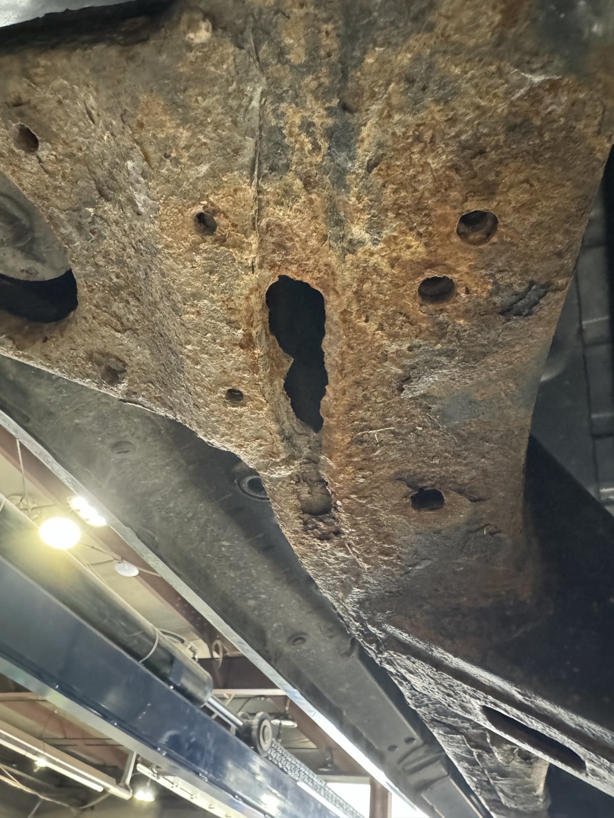

    New to Forum and Tacoma...Have money down on a 2010 you see in my pic, taking it to a mechanic tomorrow.....160,000 miles....manual tranny, 2.7
    This truck was Recall inspected by Toyota and had frame cleaned and coated(circa 2019), or whatever they did, not replaced. It seemed solid to me when I did hammer test, but did have 2 dime size holes on bottom by LF cab mount. Not sure what to do....my 2000 suburban is super rusty, but as bad as it is I have no worries it will break in half. Heavy surface rust, no holes.

    I went to get it, asked if I could take it to my mechanic (long story: a friend’s in a different city), they said OK…….see pic. I guess they didn’t charge my card for the deposit and we walked

  13. May 4, 2024 at 8:34 AM

    Glad you walked!!!!:yes:

    Hole-y crap, good thing you walked! That is some significant frame damage.
