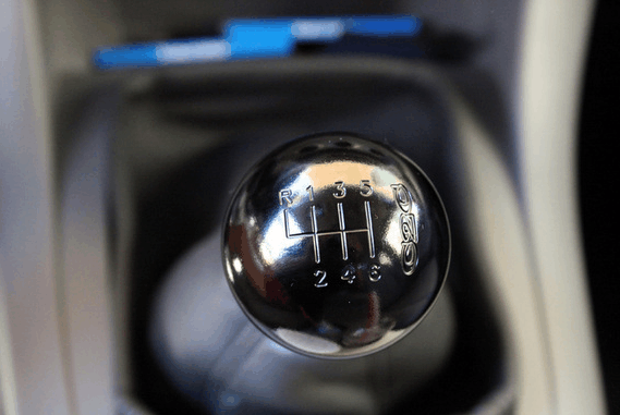

    heads up for anyone with an aftermarket short shifter, get a heavy shift konb. It'll help with momentum switching gears. I have the URD kit and the heavier shift knob helped a ton

    What knob do you reccommend? I have the TRD one and so far I'm not impressed:rolleyes:

    They are spendy-but I like the weighted knob from TWM. Great feel and weight. They give you some height adjustment options too.

    I love my C2C, too bad they're not around anymore
