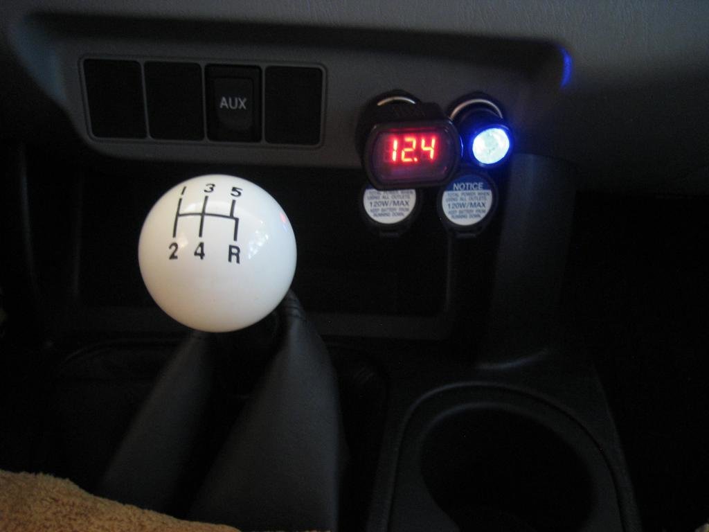

    I chopped off my lever on my 5 speed,
    and that also shortened the throw. ;)

  17. Nov 23, 2013 at 8:40 PM
    #17
    tooter
    tooter play every day
    Apr 13, 2013
    #102021
    2,441
    Greg
    Los Angeles
    2012, std cab, 5 lug, 2.7, 5 speed
    Built for maximum low end torque, tooter II.VII intake manifold spacer, LCE long tube header, Injen long tube intake, 2,900 rpm torque peak.
    My chopped lever is similar as I also lost a little leverage with the shorter length. It just makes the shifter a little bit more "notchy", and not a problem. I really like the shorter lever and shorter throws... feels more like a sports car. ;)

  18. Nov 23, 2013 at 10:44 PM
    #18
    toyodajeff
    toyodajeff Well-Known Member
    Nov 11, 2009
    #25817
    1,897
    jeff
    canton Ga
    06 reg cab sr5
    General lee horn mod, Bilstein 5100's and maxtrac 4 inch lift spindles. omd spring rebuild w/ s10 springs kenwood h/u and cb, warn trans4mer brush guard level 8 tracker wheels and cooper s/t 33's
    Whats up with the do dads in the ciggarrette lighter ports. Is the one on the left a volt meter?
    I think the tacoma shifter is pretty nice for a truck. I had a 5 speed jeep comanche with a
    Pretty long throw, but it did go into gear real easy, I figured it was just wore out. Even the jeep though wasn't bad compared to the old granny 4 speeds in full size trucks.
  19. Nov 23, 2013 at 11:06 PM
    #19
    tooter
    Apr 13, 2013
    #102021
    2,441
    Greg
    Los Angeles
    Yes, it's a nifty little volt meter that I got off ebay for just $3 including free shipping. The other one is a rechargeable LED flashlight that glows blue when its charging, and when you turn it on the light is white. I got it for $5 from Home Depot.
