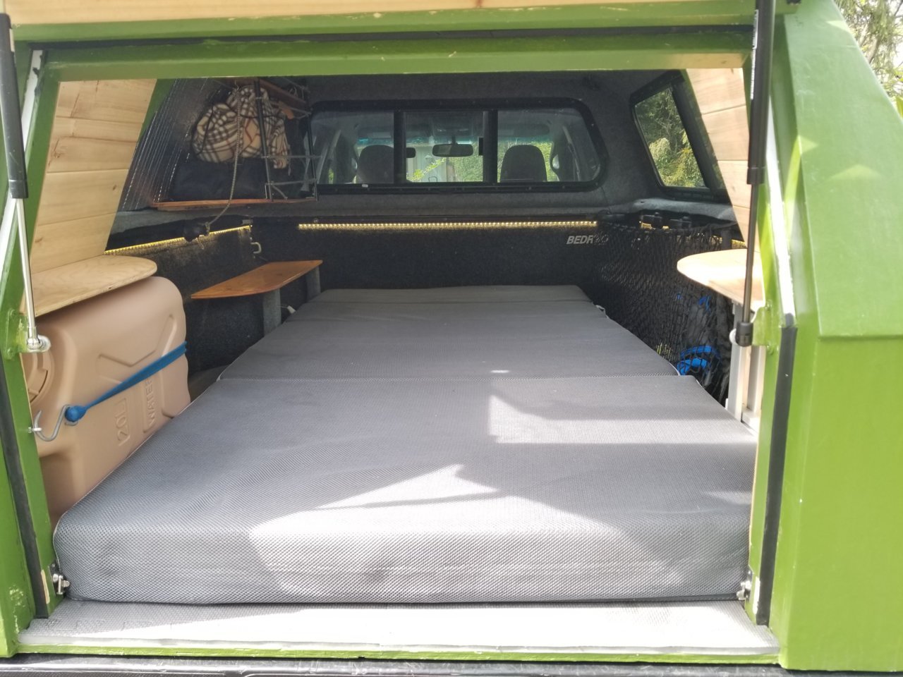

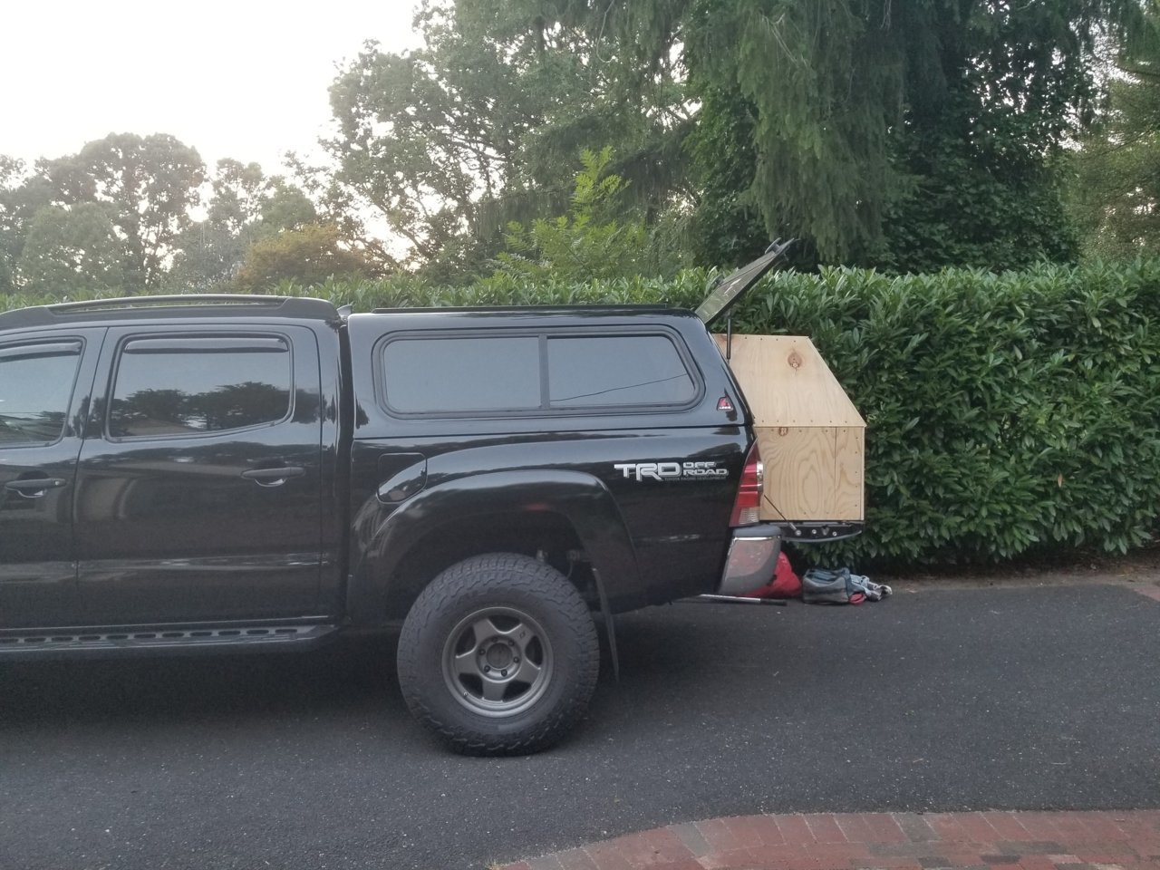

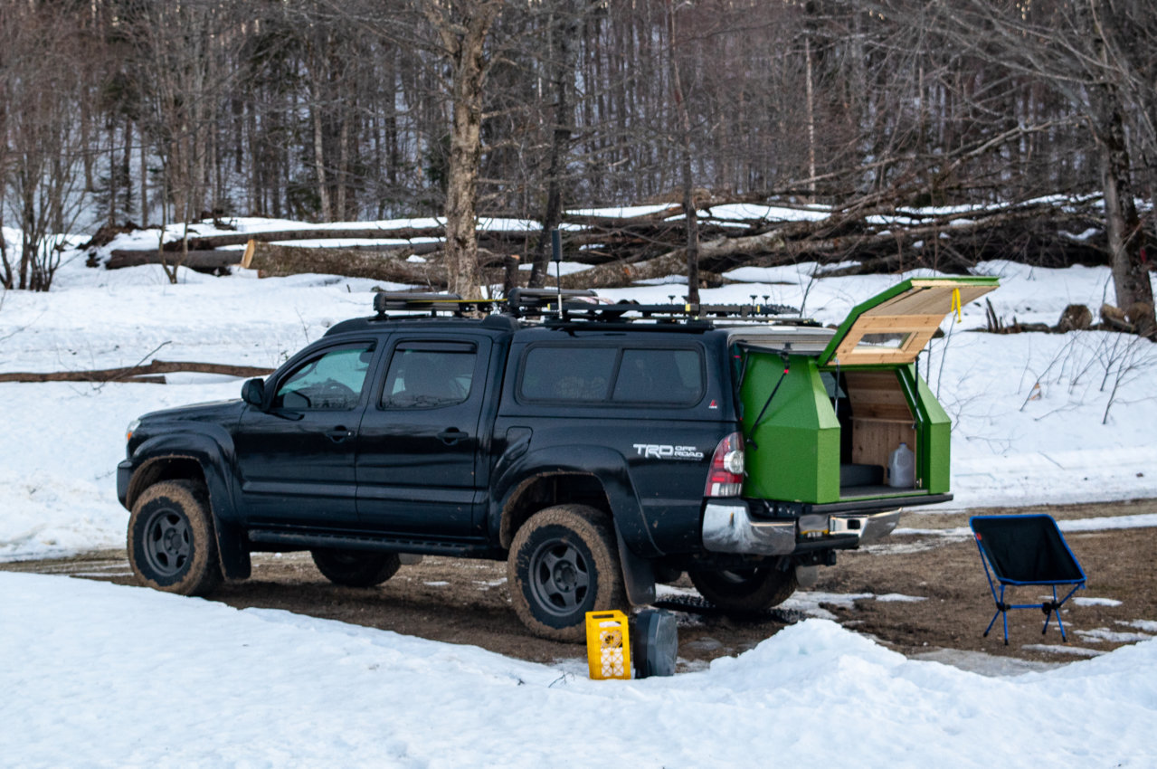

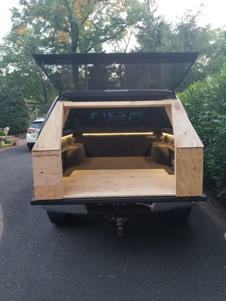

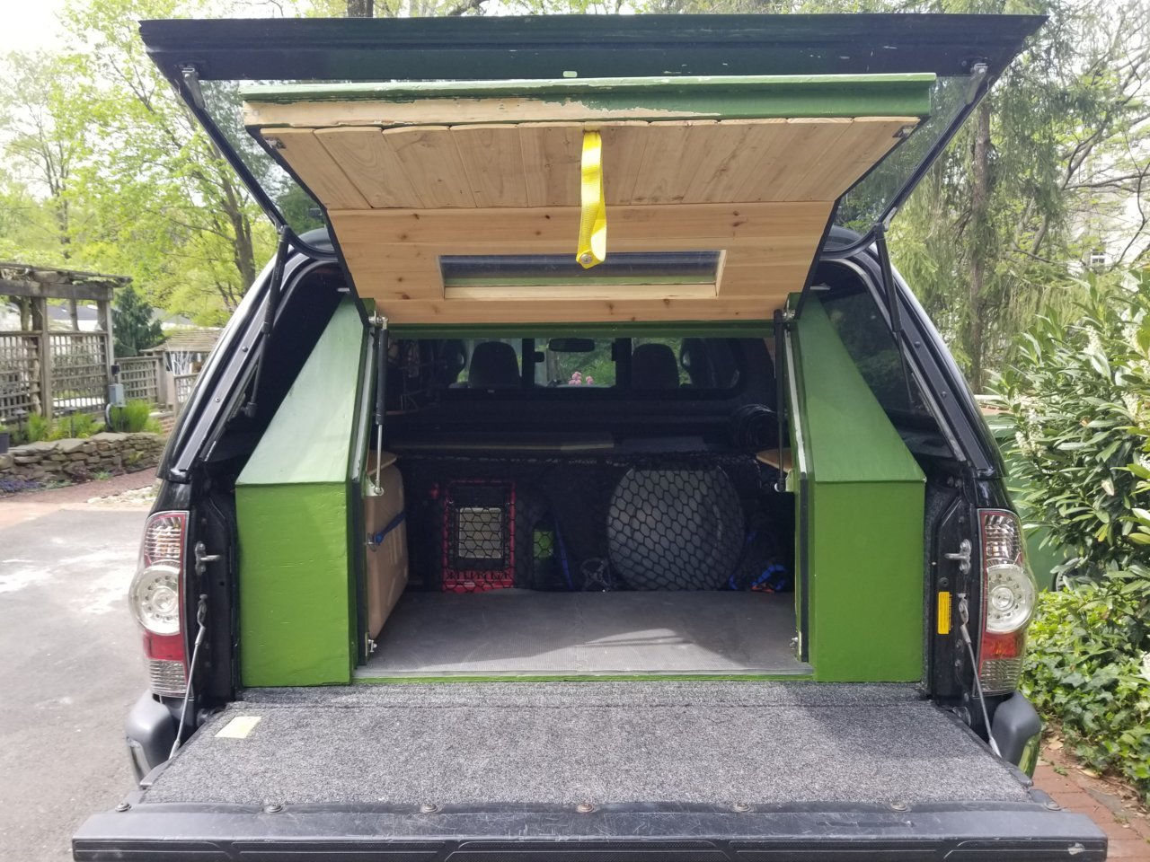

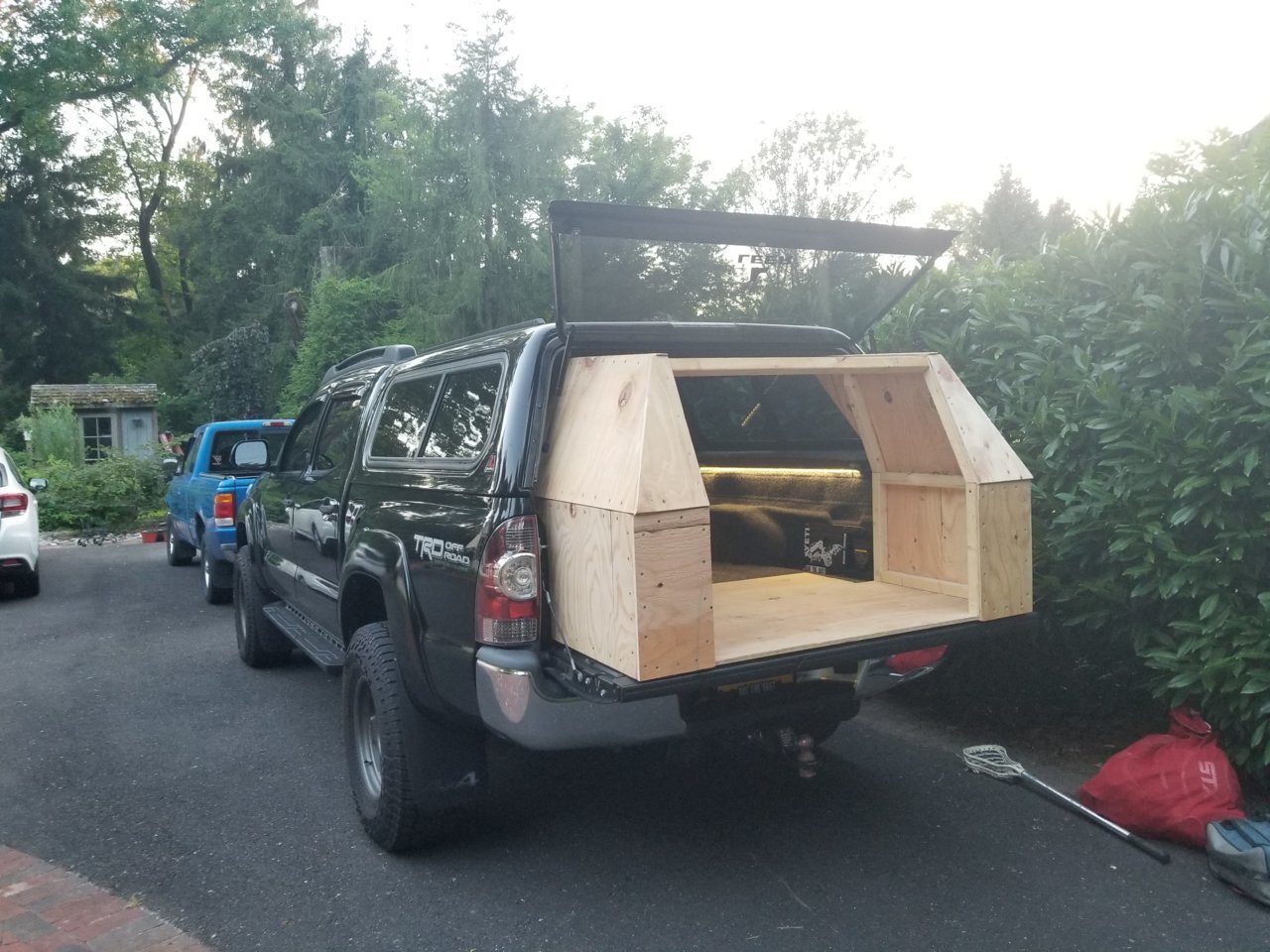

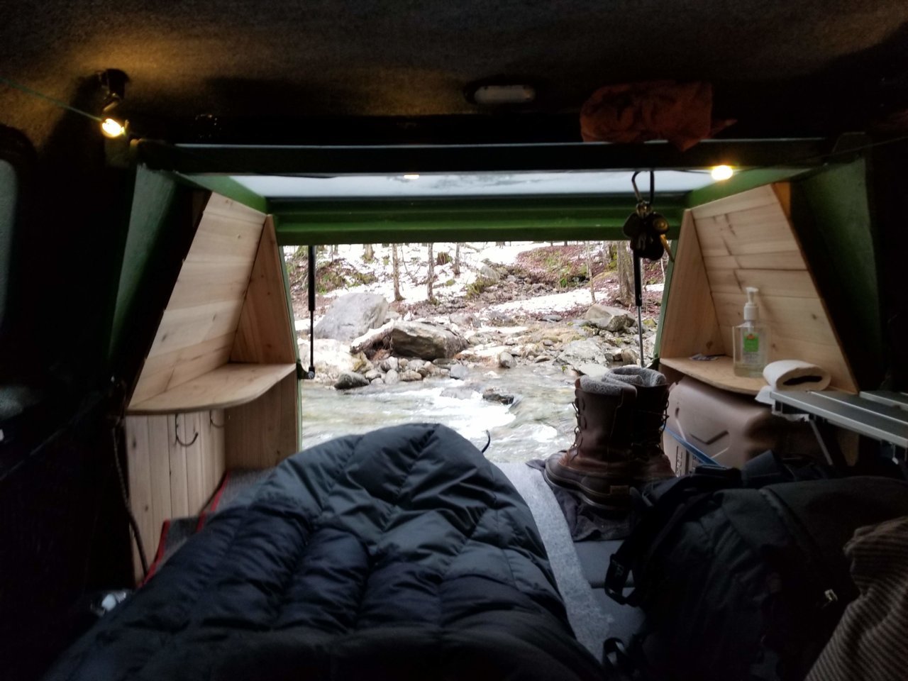

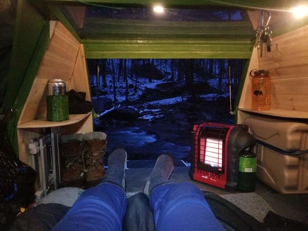

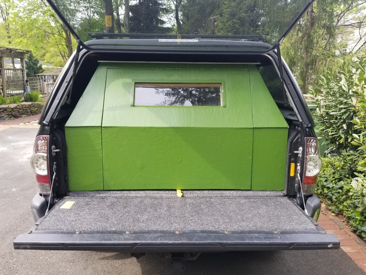

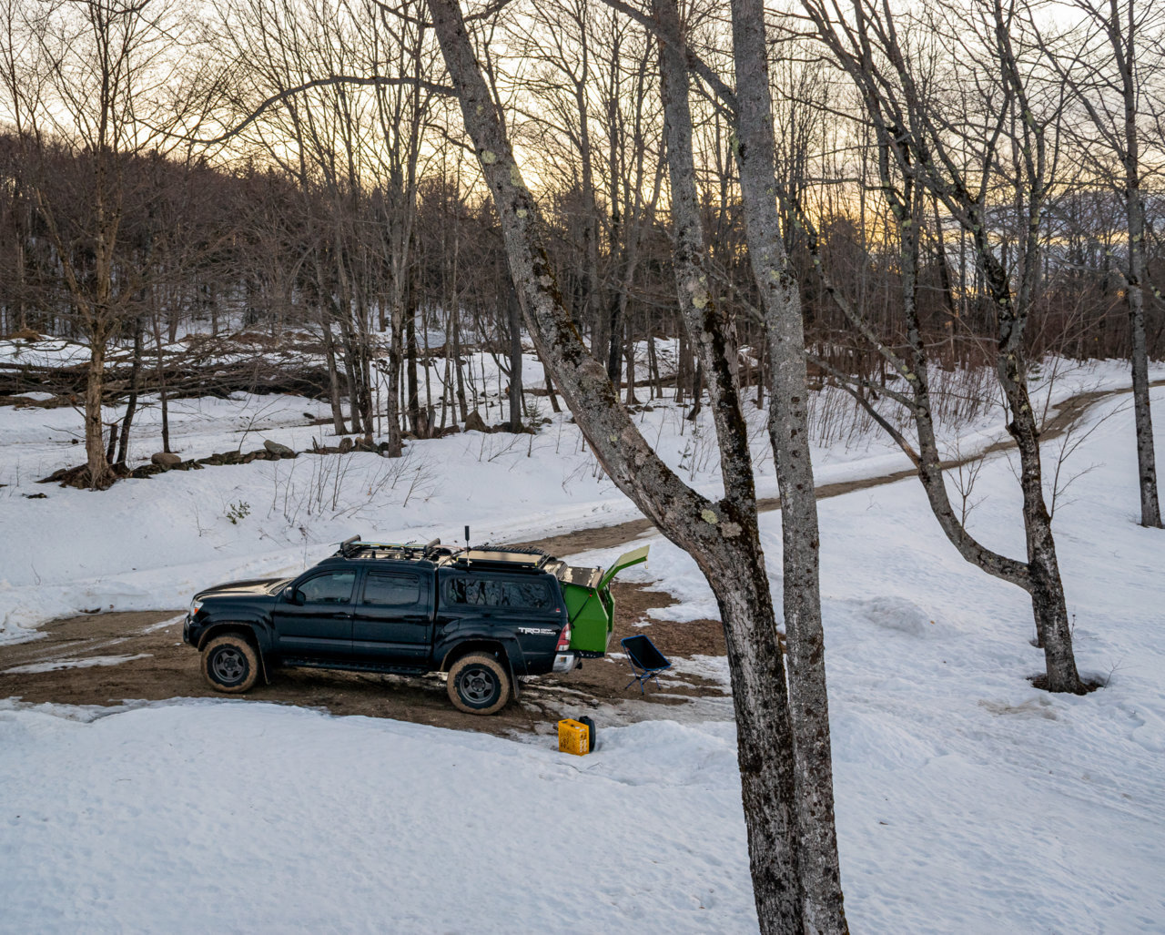

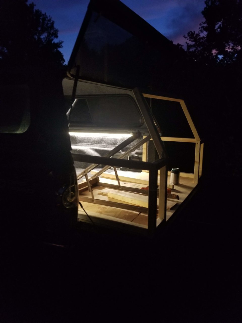

    Last summer I needed a quarantine project, so I converted my shortbed into a camper/ski lodge for ski bumming around the northeast this winter. Big shout out to Off-grid Backcountry Adventures and Drenalin Adventures on Youtube for the inspiration on the slide out extension.
    Here is my version...

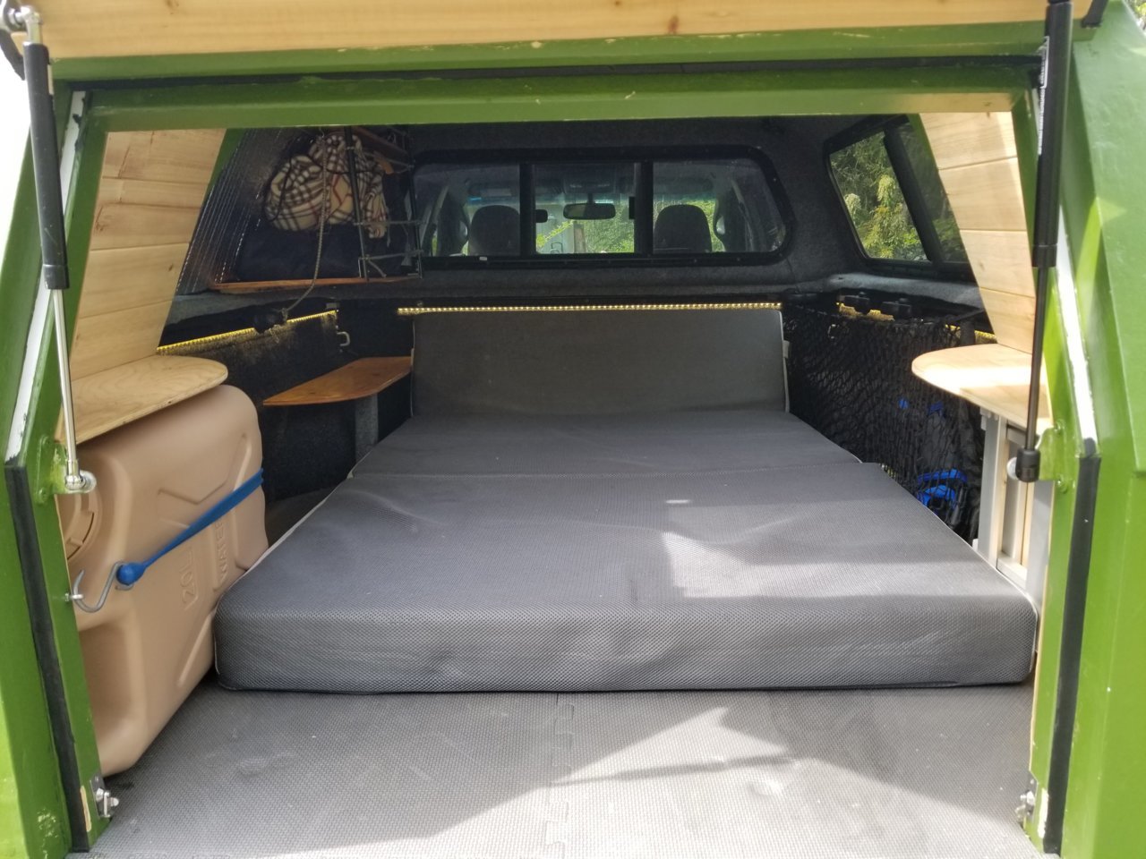

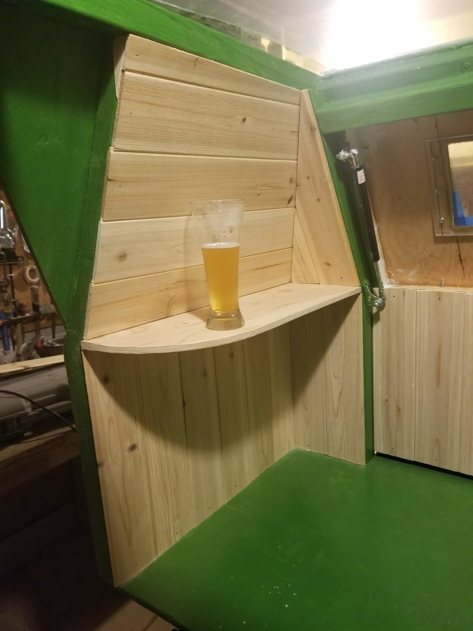

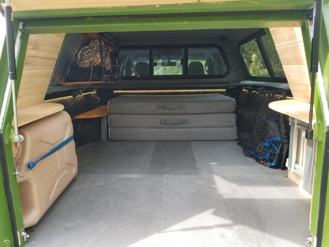

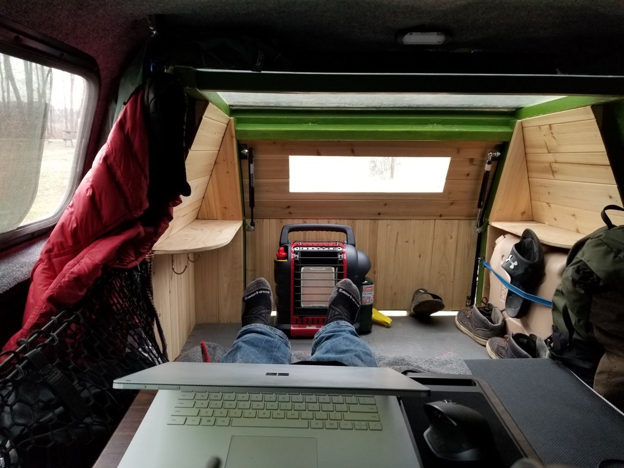

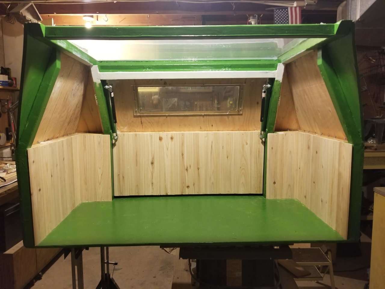

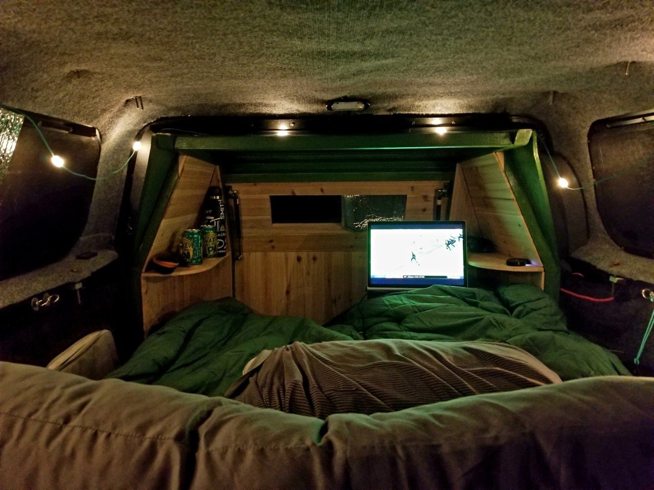

    From the inside...

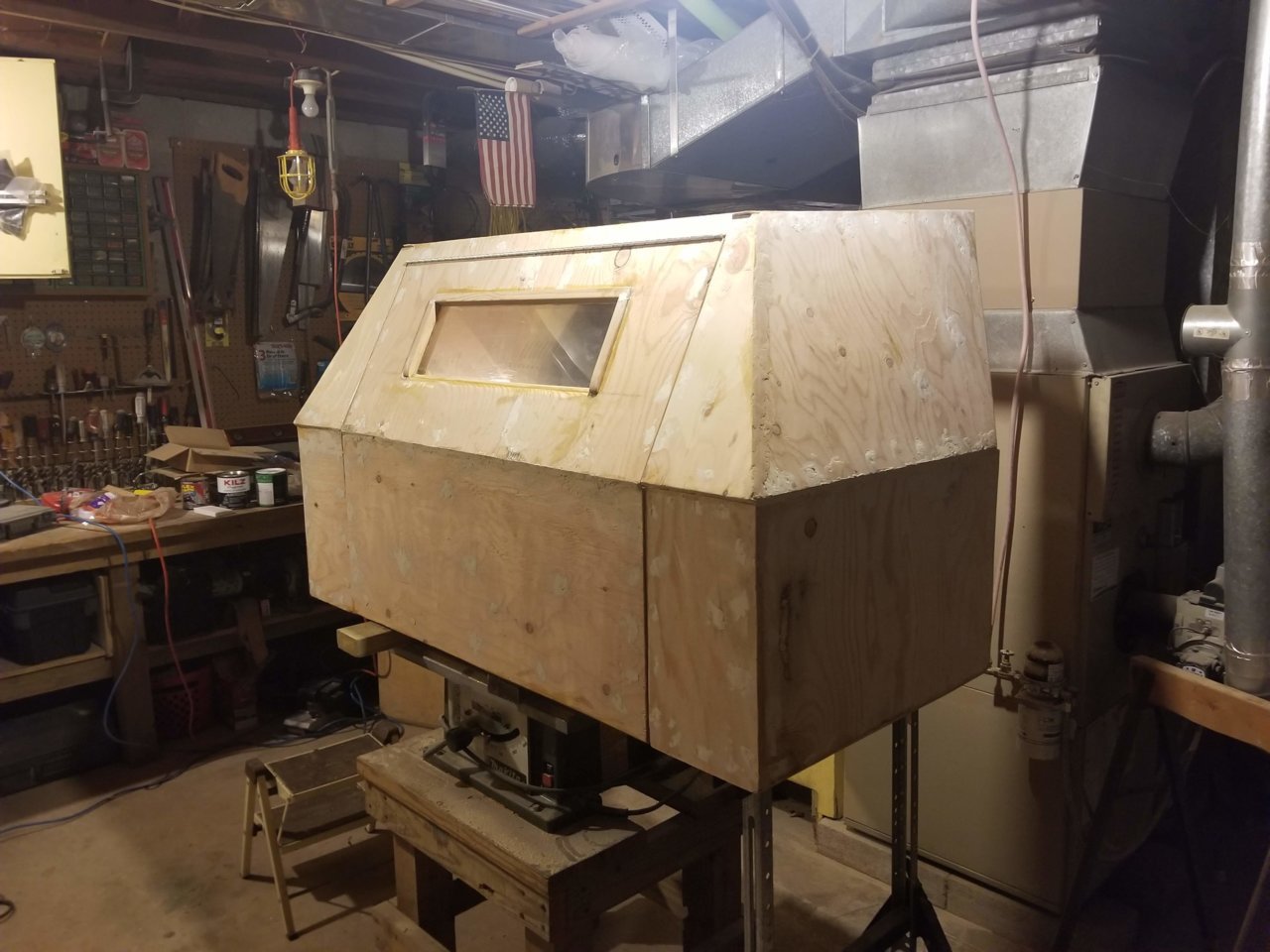

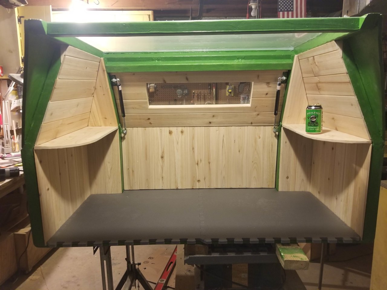

    The Build

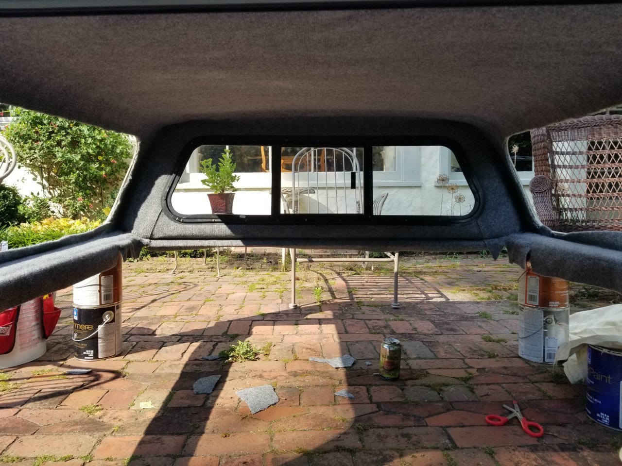

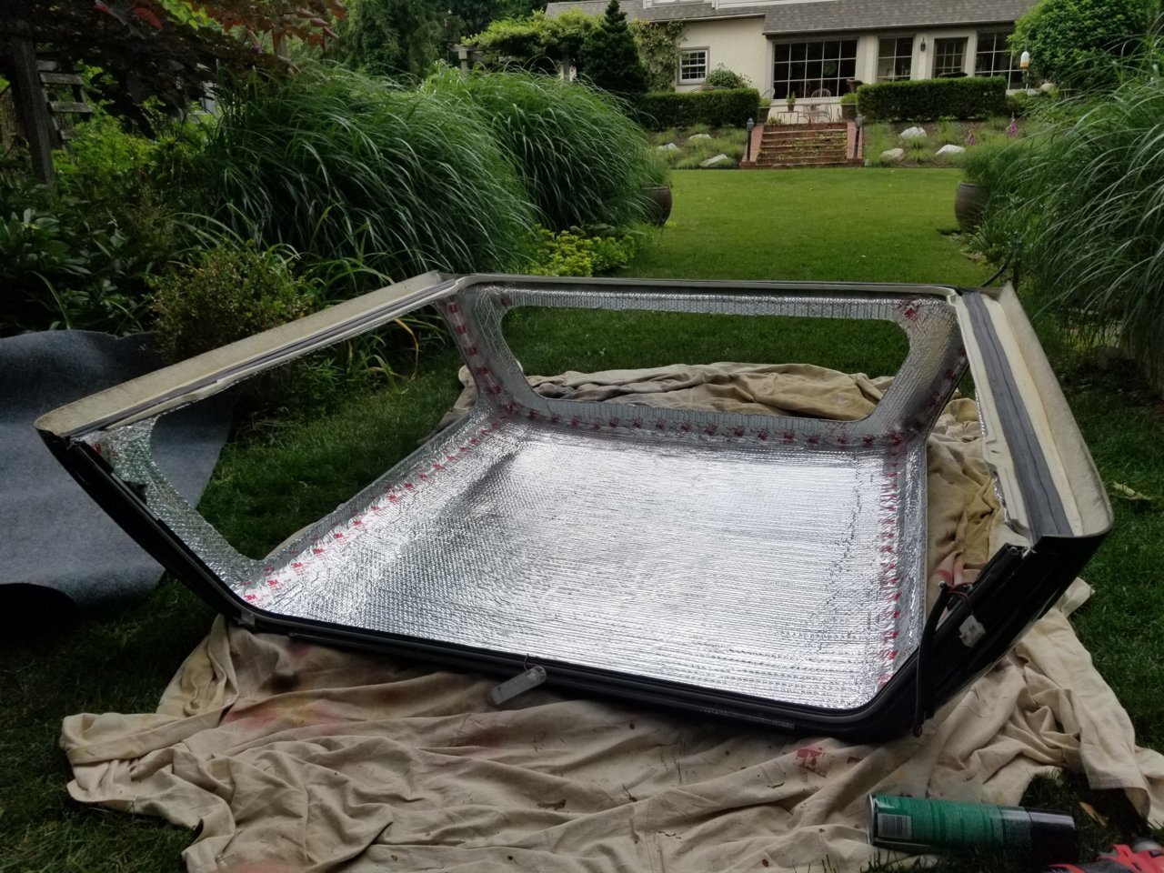

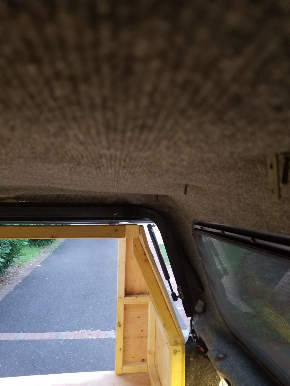

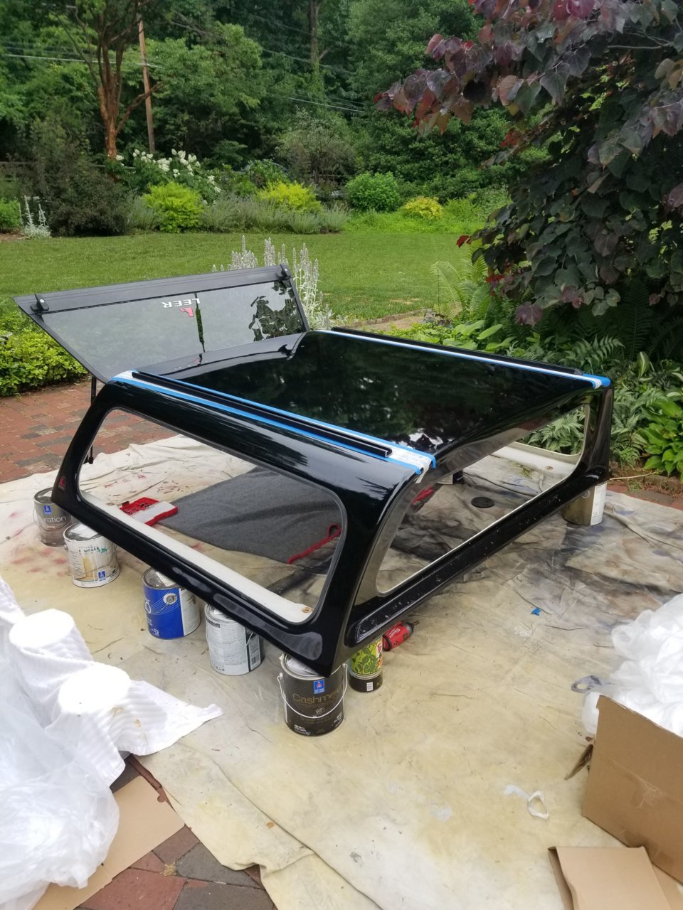

    First, I snagged a bedrug from Tacomaworld marketplace and found a topper on Craigslist. Used some other great threads on here to add insulation, carpeting, and rails to the topper.

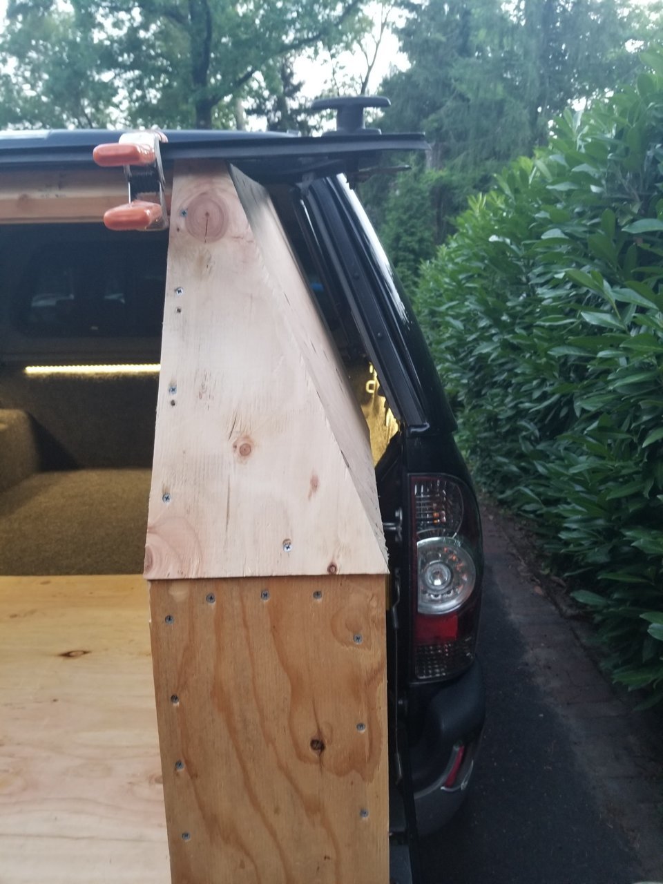

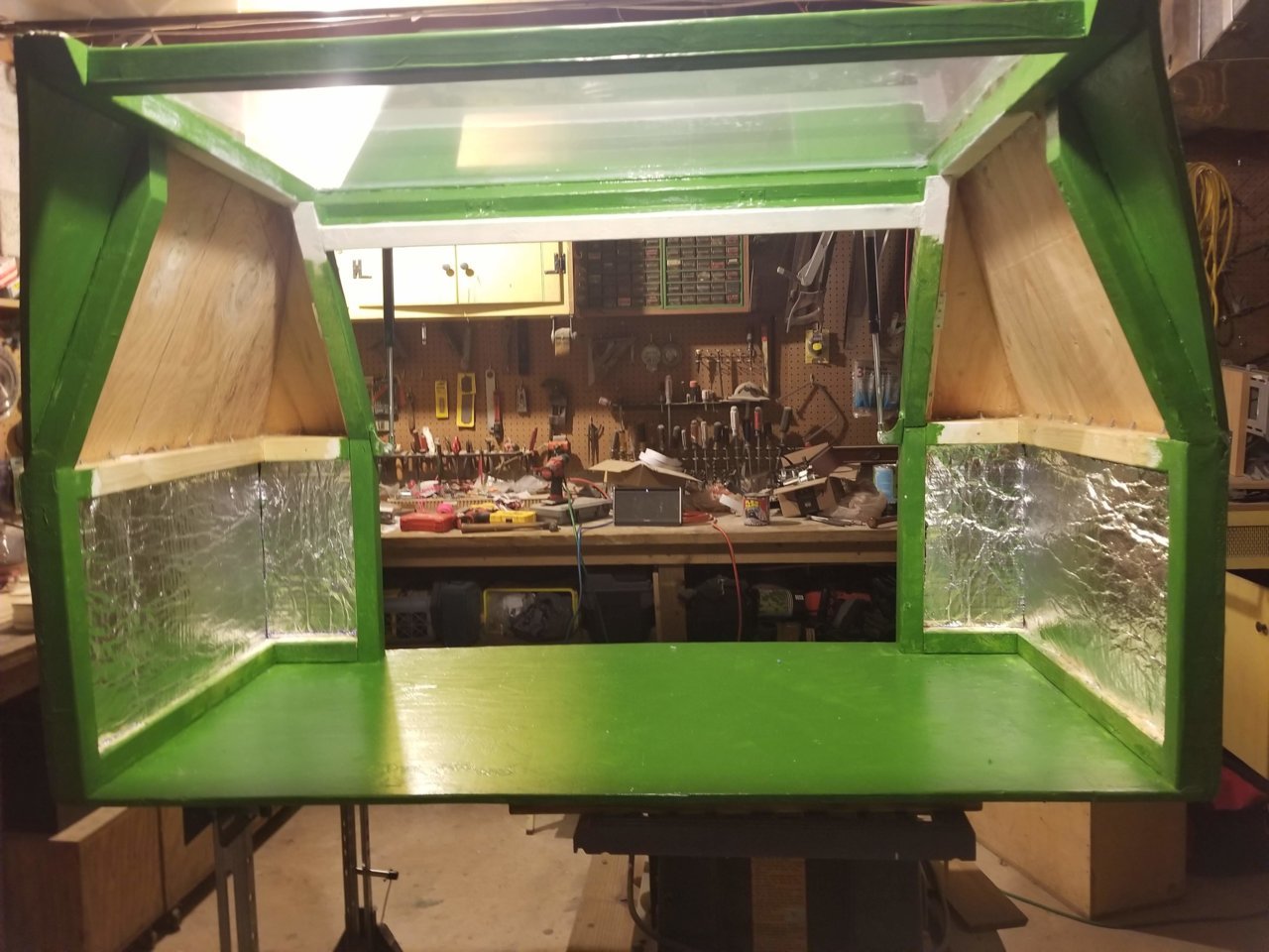

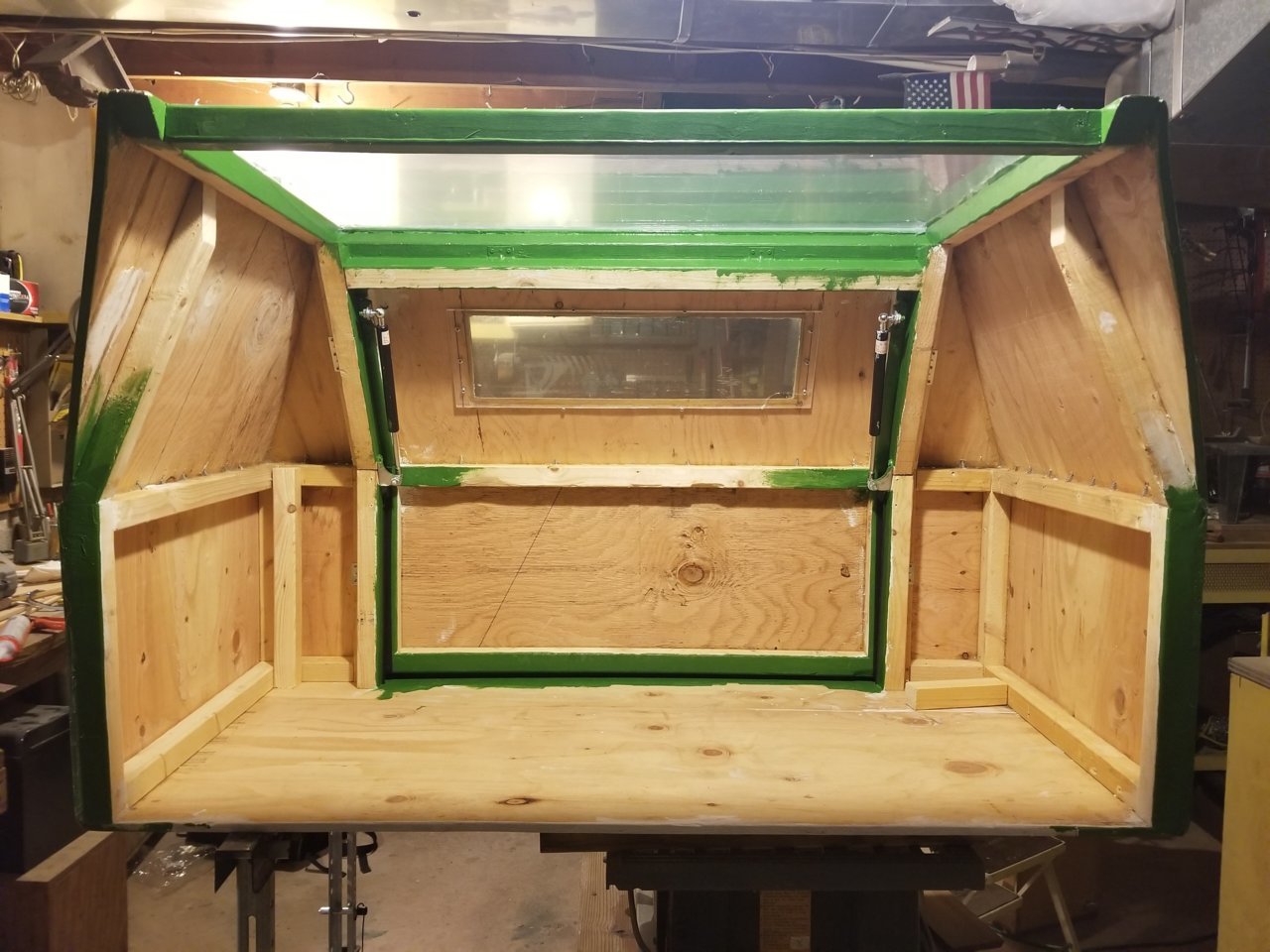

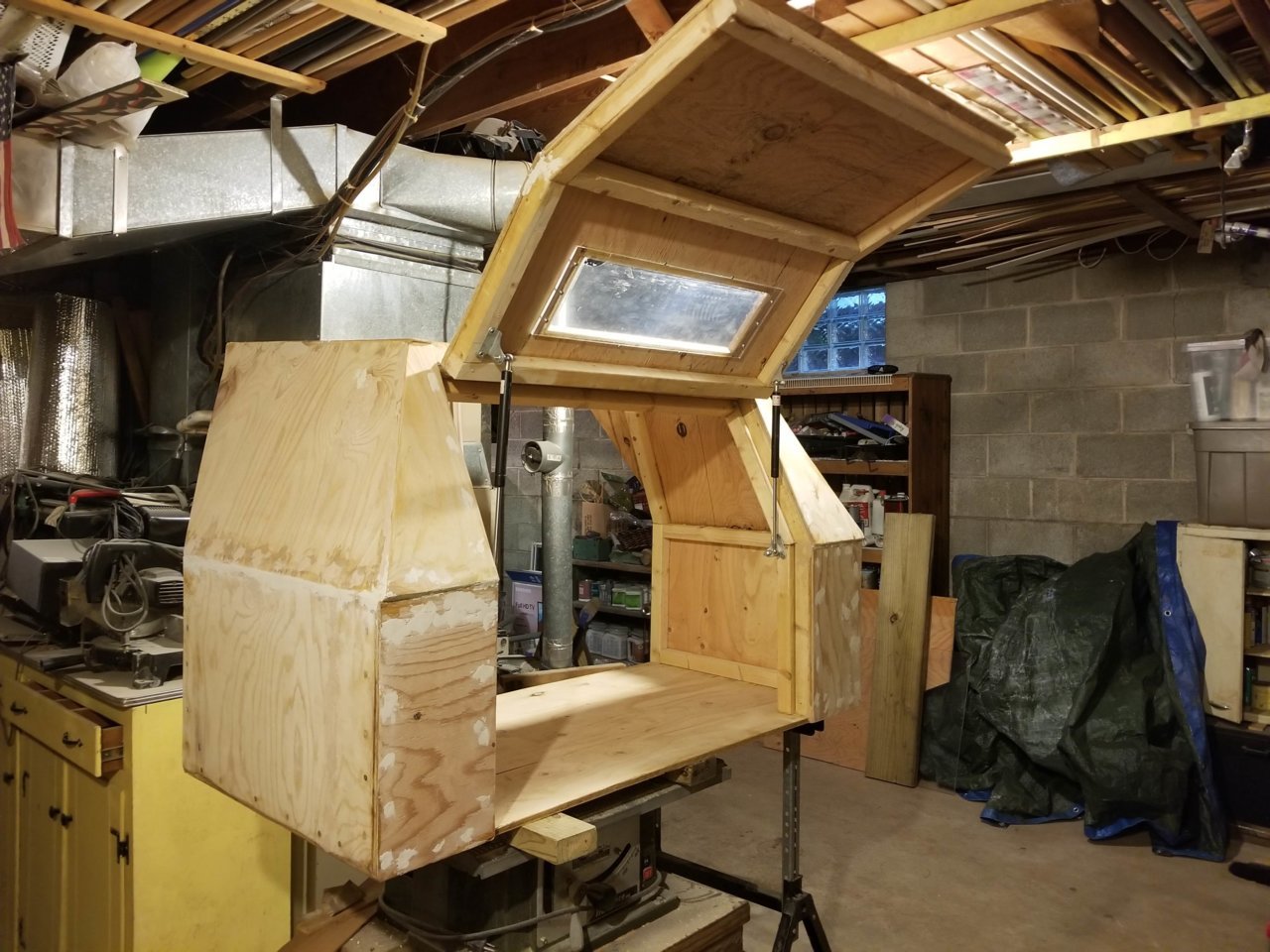

    Then the construction could begin...

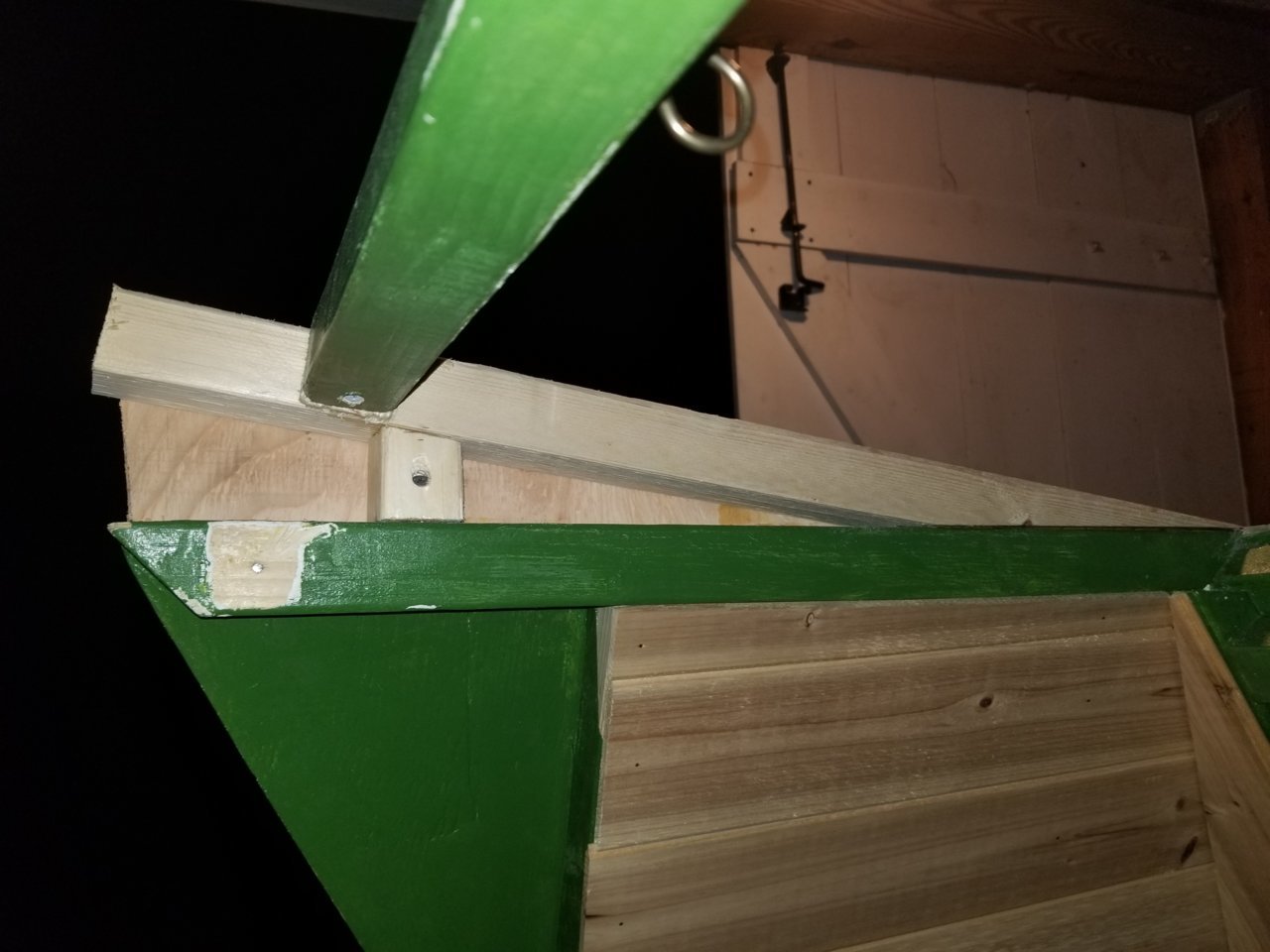

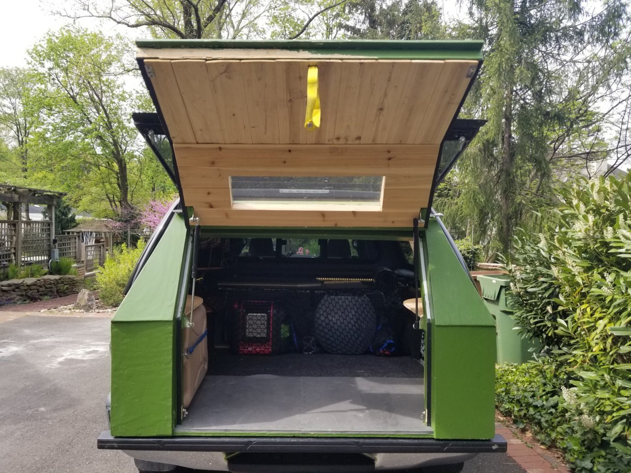

    Still working on best solution for closing in those gaps, but a heavy duty bed sheet or canvas seems to do the trick.

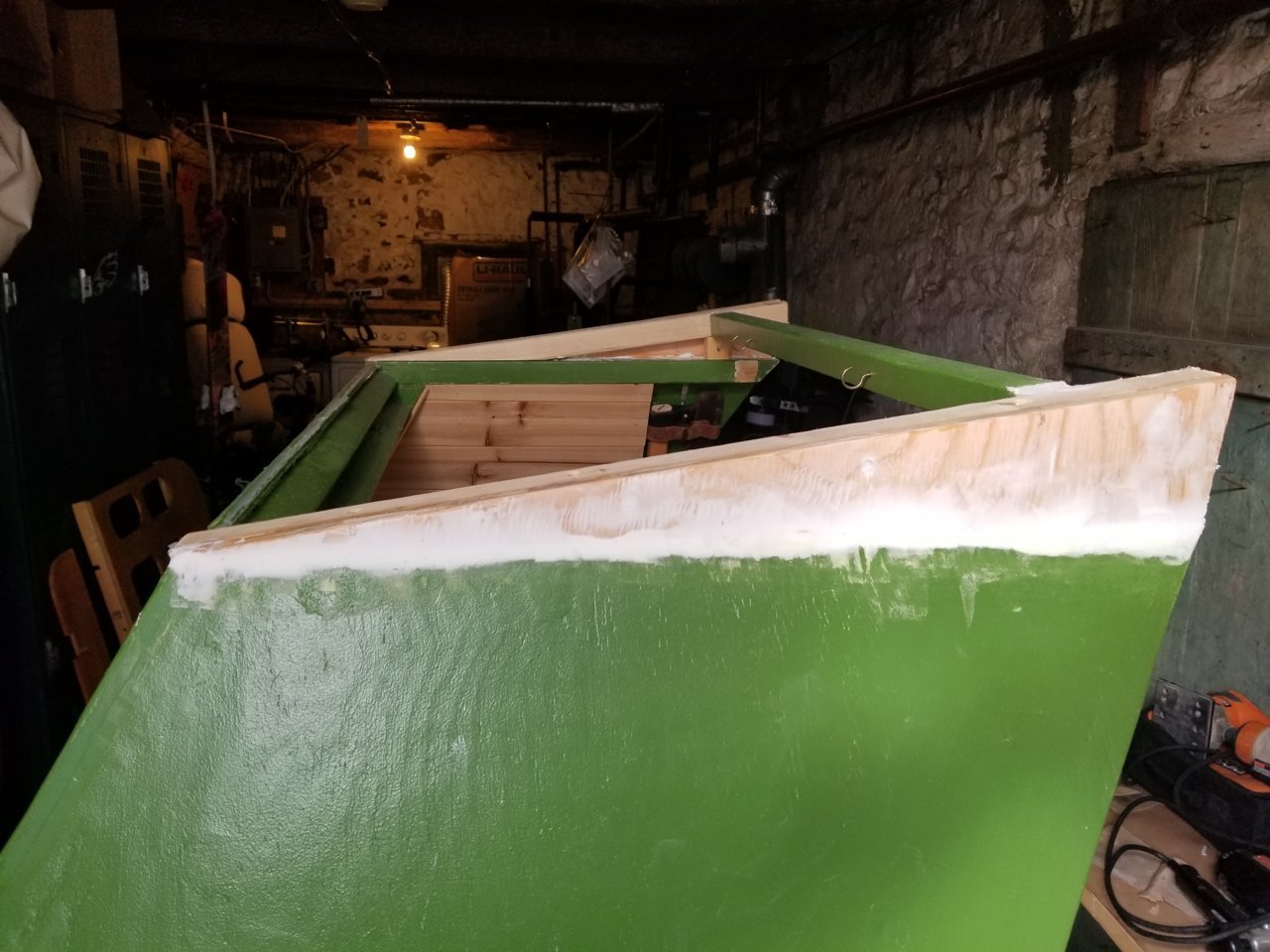

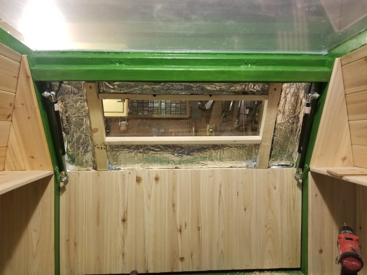

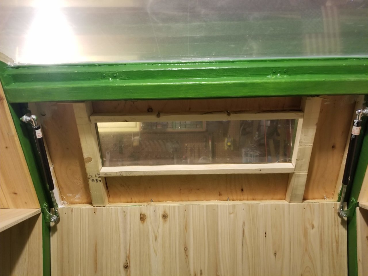

    I ended up using plexiglass for the roof. Probably doesn't help insulate very well, but thought it was necessary to not feel like a coffin. When it's real cold I just throw some reflectix under it anyway. Added a window too. Although, I wish I made it bigger to see out the back better while driving, but I ran out of plexiglass.

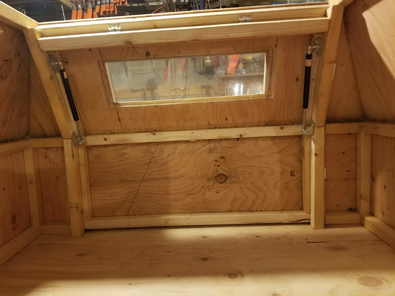

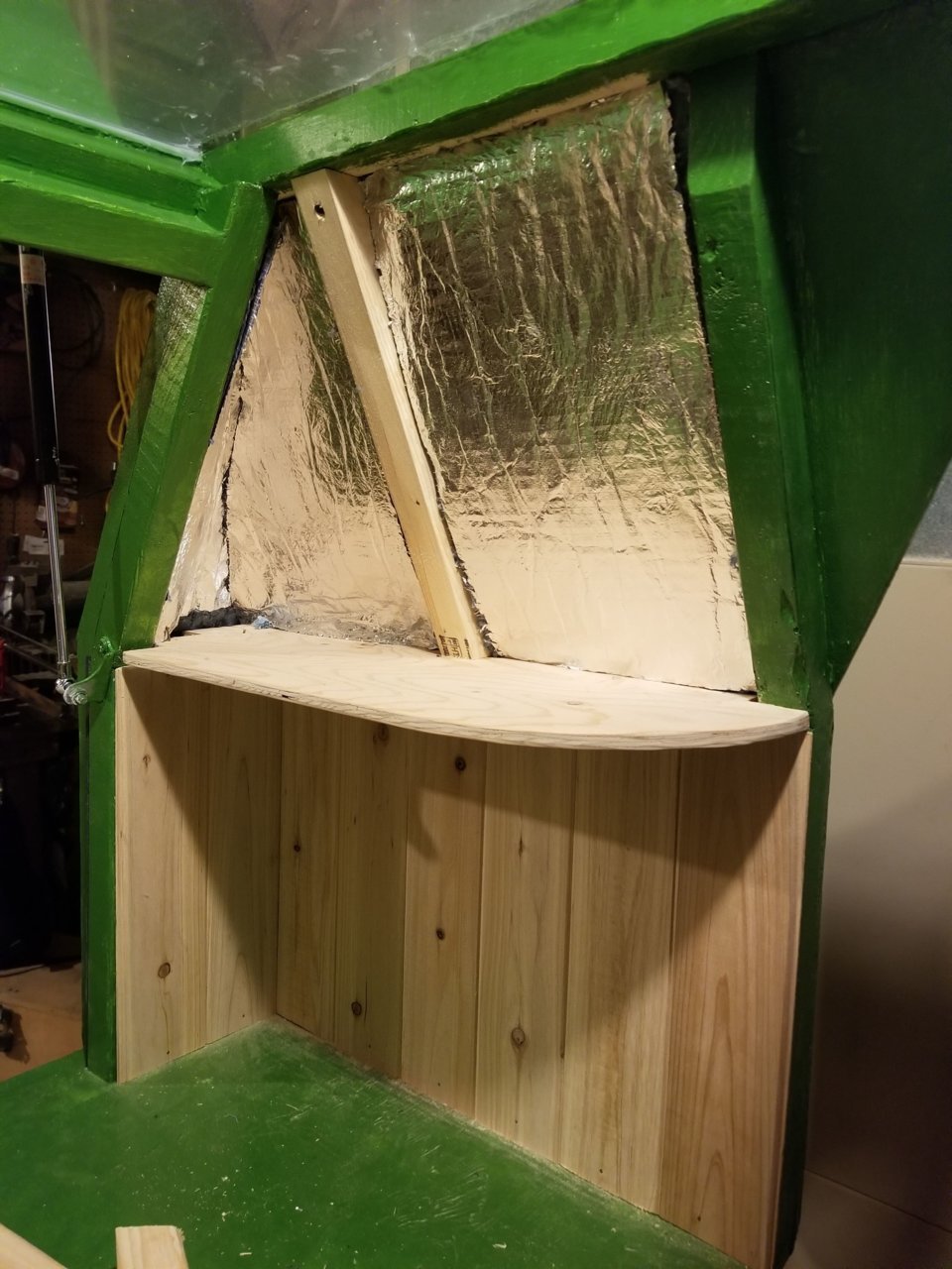

    Considering I used plexiglass for the roof, I probably went overboard on the insulation in the interior. Added two layers of a 4x6' roll of denim insulation from Home depot. Then used some cheap cedar planking to cover that up.
    I needed to add an extra support to the frame so I had something to nail the cedar planks to. Glad I did too. It feels sturdy.

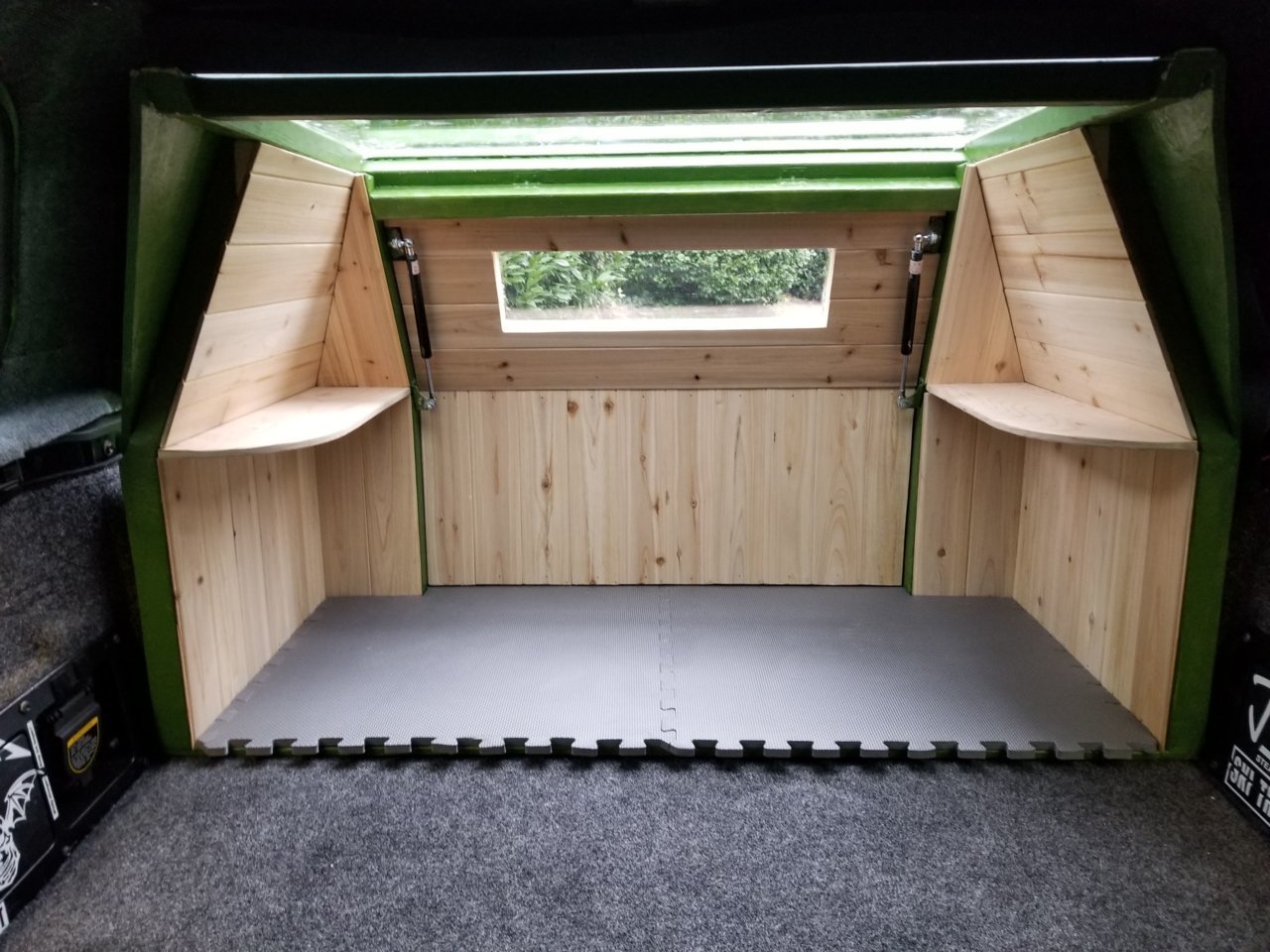

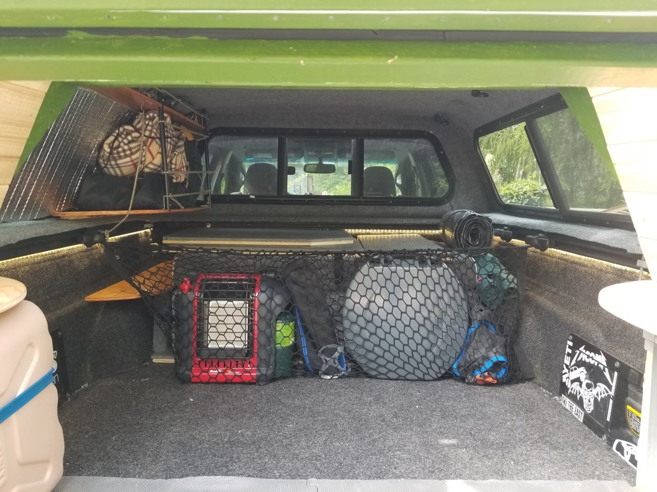

    For the flooring, I have some plywood panels with gym floor mats that fill out the rest of the bed. Glued them together with 3M adhesive spray leftover from insulating the roof.

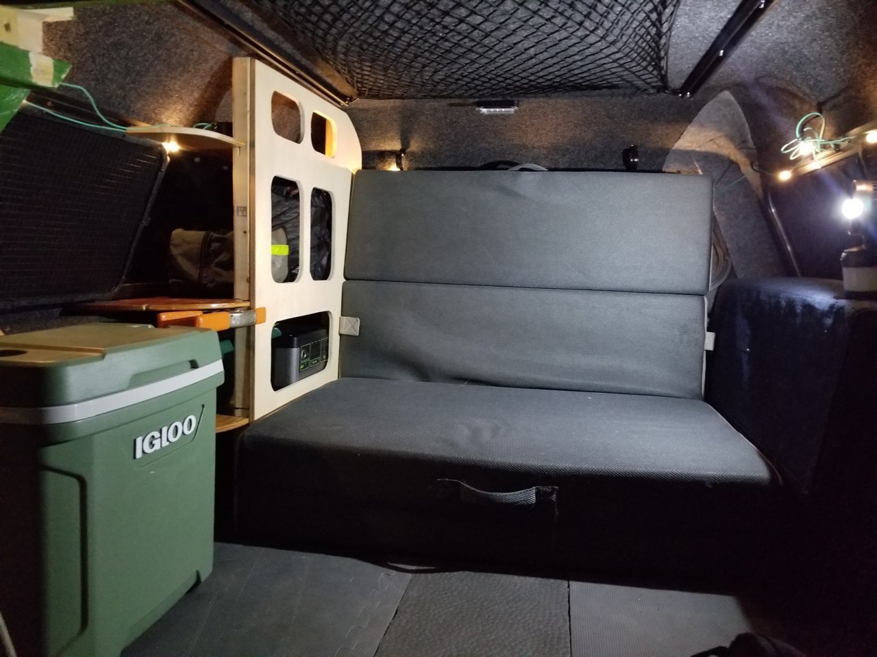

    Bought a 40" wide trifold mattress on Amazon and it fills the entire bed and tailgate once unfolded. It also has different positions—can be a lounge or sofa style as well...if I only had a high-rise.

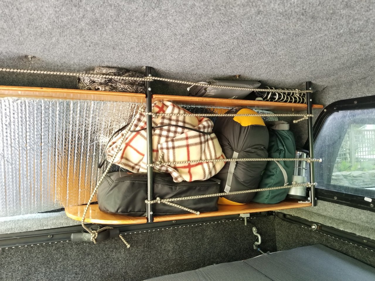

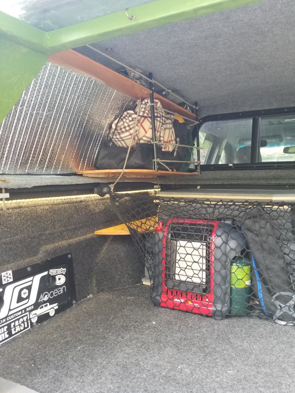

    Finally, I added some shelving to organize the sleeping bag and other camping gear.

    That should be a good alternative. If I were to do it over I might have chosen lighter materials. Maybe thinner plywood at least.

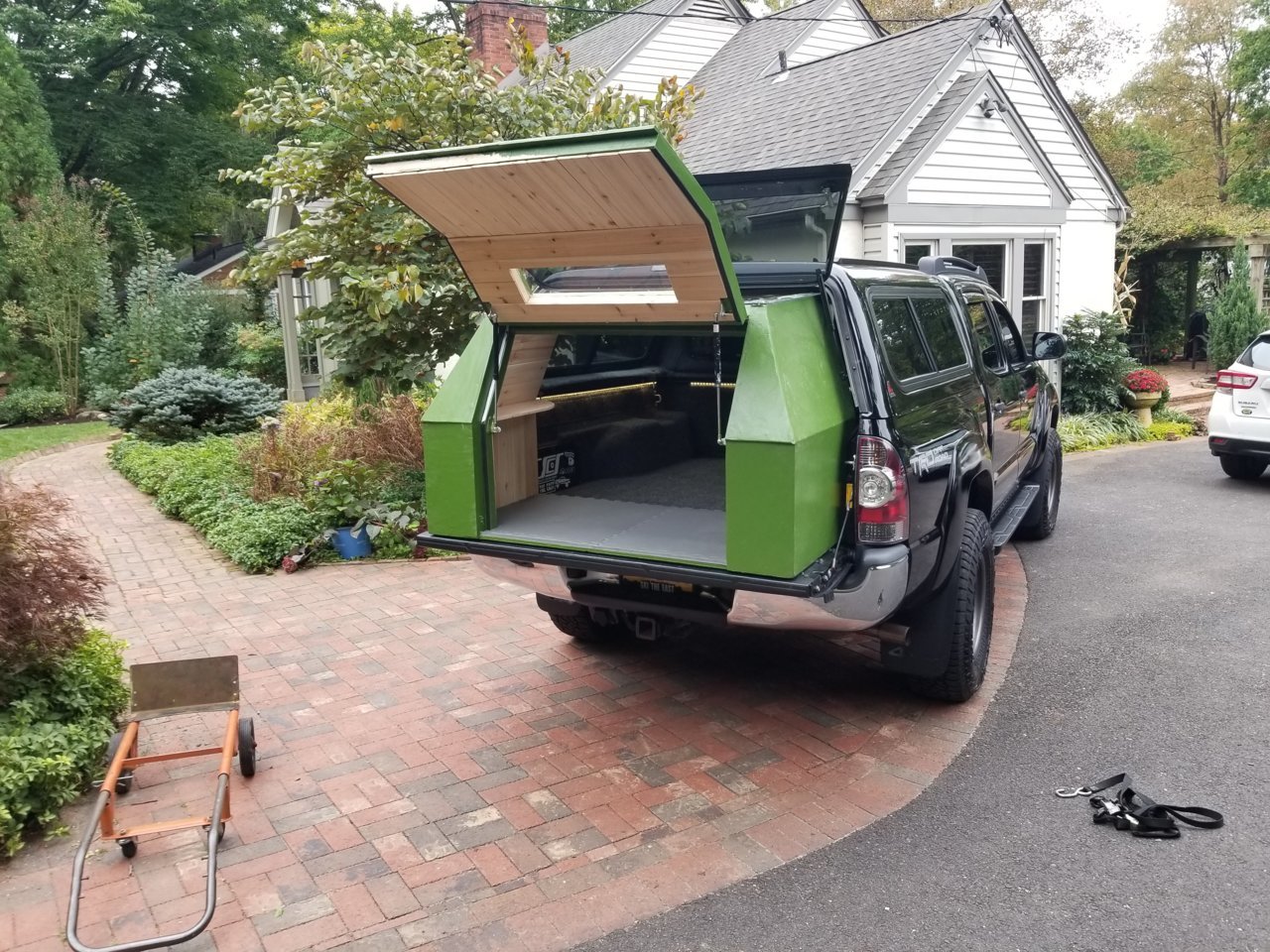

    Looks like you improved on Brian's. I haven't watched his channel in a while (just glanced at it and I see Sierra is still alive and he doesn't look as frail as he was looking) but I recall after a couple of years living in it he was planning on doing some repairs or upgrading it (guess I ought to give him some views). He was using pool noodles as the fill between the extension and the truck at one point, not sure if he still does that. The only thing I'd be leery of with the pop up hatch like you have is water running down and dripping through the hinge- the way my luck goes I'd wake up with wet feet. On my last Tacoma, my ghetto "fix" for that issue with the camper shell window was to initially use contact cement to put a piece of rubber over the hinge (an old mt bike tube that I split open). I'd thought about using some of that stick on rubber gutter like they use on RVs but the old tube was free.

    thanks! Yea I watched his channel a lot when I was building for ideas. I can confirm there is no leaking with the door the way it is. However the plexiglass roof hangs over the hinge which is probably why there no leaking. I’ve also added a small awning off the roof rack to block out rain/snow too.
    I’ll admit though, if I did it all over I might do a normal door like Brian or a 50/50 split. it would have more functionality to hang things or add shelving. Would be easier to close too

    Last fall I found a leer 180 mid rise cap on Craigslist and swapped it for the cab height leer 100r. The colors don’t match but totally worth it for the new head room. Then I had to adjust the roof line of the extension to match the new height of the track cap.
    Added new shelving too but need to get more pics of the latest set up.
