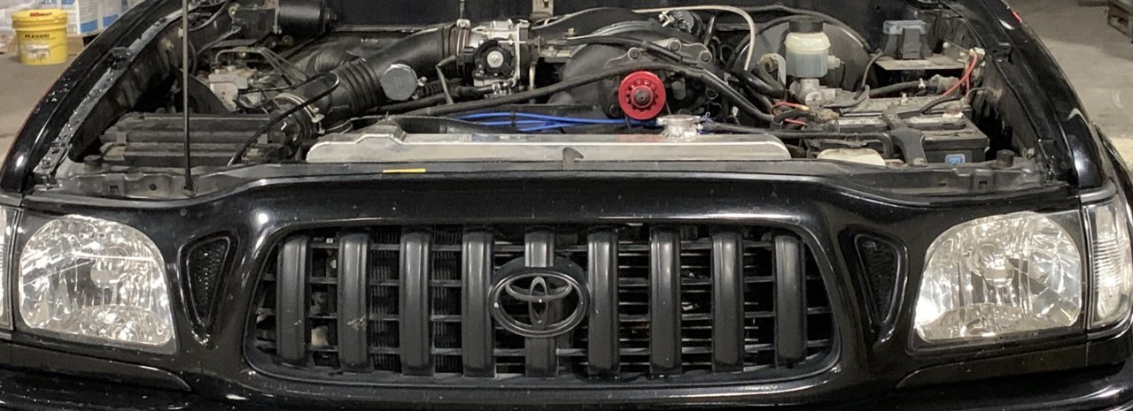

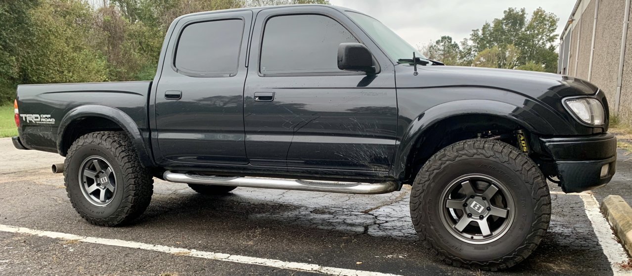

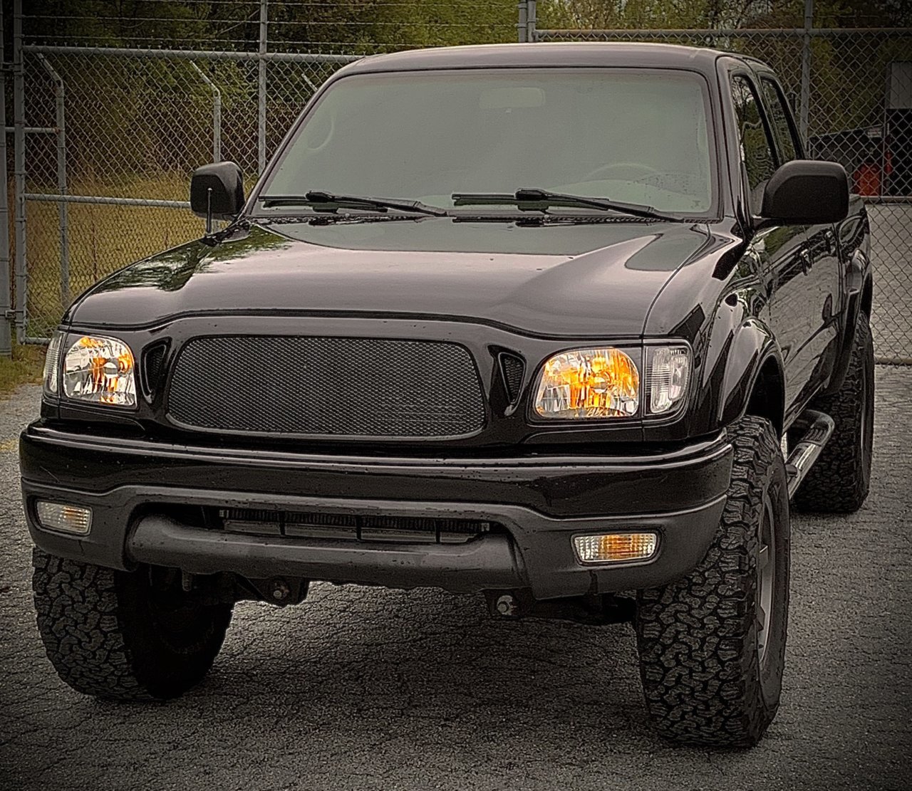

    CURRENT MODS
    LIFT
    ADS with reservoirs 2” over stock.
    550lb coils.
    MCM Fab reservoir mounts.
    Camburg UCAs
    5100s rear.
    Deaver J59
    TIRES
    285/75/16 BFG Ko2 Load E
    LEVEL 8 MK6
    PERFORMANCE
    TRD Supercharger.
    170 degree Stat.
    URD performance crank pulley.
    PLX DM-6
    PLX KIWI3
    Mini H1 projectors.(yet to be installed)
    Transgo
    Devils Own kit.

    Truck looks awesome!
