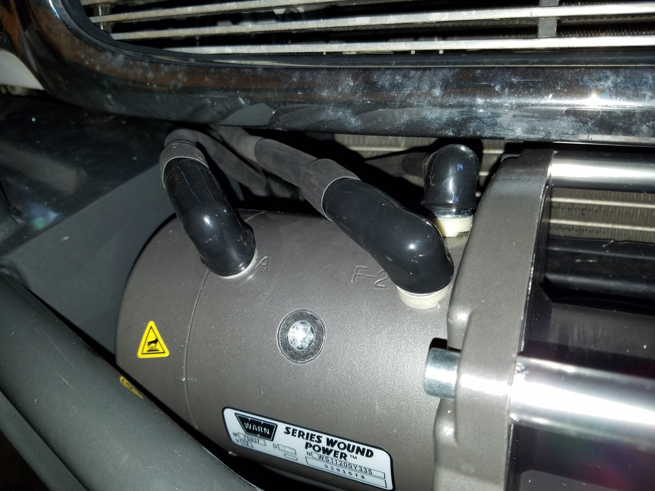

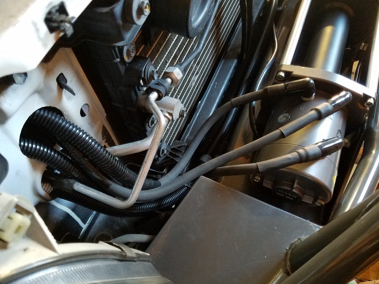

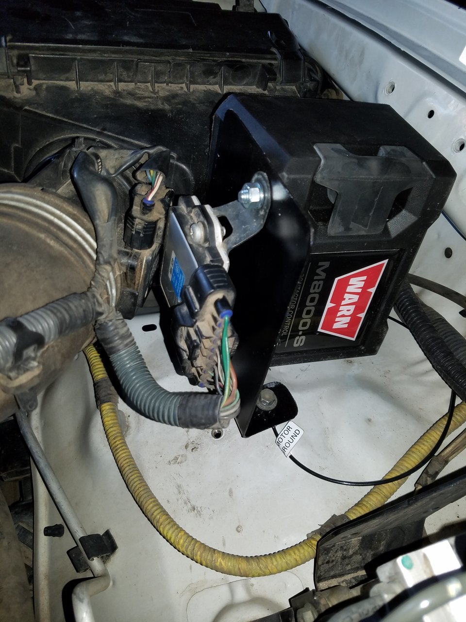

    Got my winch installed last week as well. Warn M8000S.
    This little job kinda sucked, was just a lot of little things that added up to a few days of work. I mounted the control box under the hood behind the airbox as it wouldn't fit on the winch. So I took the bracket Warn gave me and chopped it up, made new mounting tabs and welded it up, and since I had to move the igniter to fit the box, made a new bracket for that out of some 16g sheet metal.
    Extended all the winch lines with 1g welding cable, must've put them in the routing location like 20 times, in and out to check for fit, location feasibility, then get measurements and finally to mark the orientation of the cables to get the ring terminals placed so that I didn't have any funky bends/kinks. But, it was worth it, the lengths and terminal orientations came out just about perfect.
    Gave them some loom where they passed through the front sheet metal, drilled a new 2" hole under the horn the fit them all....and not pictured here, the 3 control cables are color coded with some 3m colored tape to keep track of what goes where if I ever take them off for some reason.

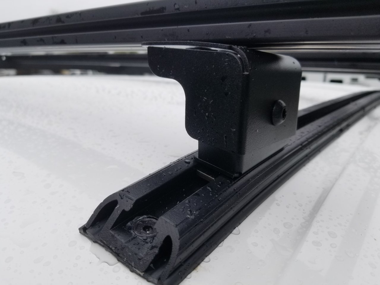

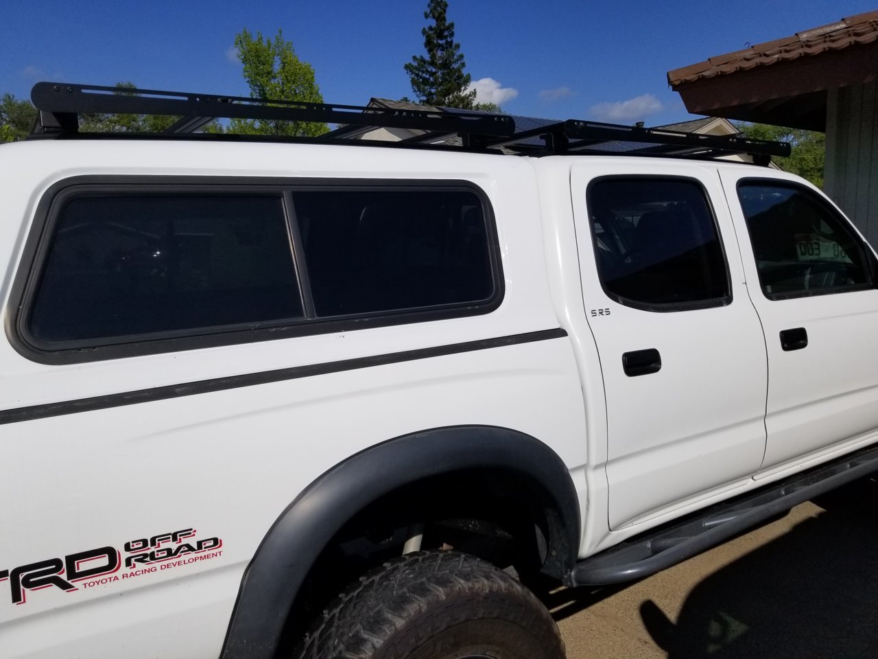

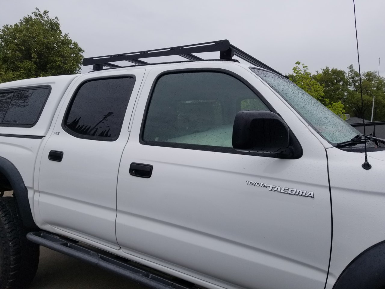

    A couple years ago as a project in a CAD class I drew up a side rail for a roof rack and was able to cut a mock up out of plywood on a CNC router. My time and interest faded for a bit but I pulled it out, dusted the cobwebs off and made some changes to the design. I found a local shop to have it laser cut and powder coated and got the first rack installed on the cab last week. Had a 2nd one cut to put on the camper shell, hopefully get that installed later this week.
    I used 8020 extruded aluminum for the cross bars, 2x1 (25 series 25-2550, 25x50mm) and purchased Front Runner mounts and universal track.
    Overall I'm happy with how it came out. I may modify the mounts to drop the rack another 1/4 inch or so. Right now the middle bars are about 1 inch from the roof at the lowest point.
    I wanted something modular, low profile and with a flat surface up top for those times when I need to carry something big/bulky.
    I was worried about the non-factory rack Double Cab roof that did not have any extra reinforcements, but I got the track far enough towards the side of the roof that it feels super solid, and it held me just fine with no flex (165lb) I don't plan on carrying anything super heavy over the cab, if I need to heavier items can go over the campershell which is rated for 250lb.
    Feels good to get the super tall Yakima Q-tower rack/basket off the top.

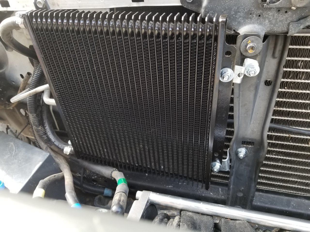

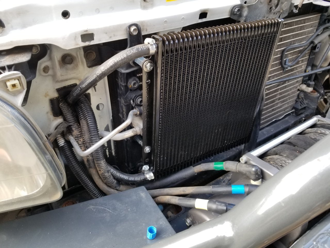

    Got my trans cooler installed as well. Was able to get it mounted using 2 existing threaded holes on the far left and used the provided brackets bent and cut to attach to the center support. Used some leftover pieces of hose split down the middle to help stop abrasion where the hoses pass thru to the engine compartment.
    I plumbed it from the trans -> factory cooler ->aux cooler ->back to trans using 3/8 transmission hose (not provided in the kit)
    Now I just need a scan gauge to watch trans temps while towing.
    Plan on changing the fluid here soon too and I stalling a new filter.20200330_170312.jpg 20200330_170317.jpg

    Do you mind me asking how much it costs to have the side rails cut out? And do you have any plans to make side rails for the camper shell? I have a prinsu rack over the cab of mine. I got it 15% off and still feel like its way over priced.
  12. Apr 7, 2020 at 6:23 AM
    #52
    shortround13
    shortround13 [OP] Well-Known Member
    Dec 10, 2014
    #144048
    202
    Sacramento
    04 DblCab TRD 4x4
    That is one of the biggest reasons I went my own route. Let's just say with all parts for 2 racks (cab/camper) I was right about $800 plus a few for some extra hardware.
    When having something made like this, the cost per unit gets cheaper the more you make (to a certain point) you have to pay for material obviously but the bigger part is the initial set up. But the cost to have 4 rails cut/powder coated (2 per rack) was not so absurd that I took the chance. This was my first time ever taking a CAD design and turning it into an actual product so there were some unknowns for me.
    3 things I would change if I ever made a v2.0 1.) thicker material. Its 5/32 (0.160) aluminum. It has a little jiggle side to side. The vertical rigidity is fine (where it needs to be strong it is, holding weight loaded on the bars) but it probably wouldn't cost much more to use 3/16 or even 1/4
    2.) I would add another inch or so to the height of the side profile, strictly for visual aesthetics. Modeling a truck in CAD is beyond my ability and I couldn't find a commercially available one, so I was limited to some basic measurements and plotting a rough shape of the roof to go off of. I wasn't exactly sure how high off the roof the whole thing would sit and didn't have the feet/ mounts in hand when designing either. So, long story short it sat a little higher than I thought and some material filling the gap would look better. It doesn't look bad now per se, but nothing wrong with wanting better right?
    3.) Keeping the holes for the cross bars where they are, I would add like an inch to either end, for visual/aesthetic reasons stated above. That could also allow for some holes/integration with a wind fairing that I'm going to work on. I haven't driven on the fwy with it yet so I don't know how noisy it is but I like the look of an angled piece up front to finish it off.

    Good looking rack. Just curious, how did you transfer the roof profile to CAD? I've been wanting to do this for awhile but can't figure out how to transfer the side profile, and the front profile for a wind fairing.
    Also, it seems like you could make some lower profile feet that would drop the rack down rather than adding an inch to the sides.
  14. Apr 7, 2020 at 12:14 PM
    #54
    shortround13
    Dec 10, 2014
    #144048
    202
    Sacramento
    04 DblCab TRD 4x4
    Thanks.
    I set a level (anything straight/flat would work) on 2 blocks of equal height and took measurements side to side at intervals of an inch, then moved the level back a few inches and did it again, until I got to the back of the cab. Then I plotted all the individual points in the CAD and created a curve and then meshed them together. Not the most elegant way to do it but it worked decent enough.
    As for the feet, I may actually just trim a little off both pieces so that it will drop the rack a little bit. It wouldn't be too hard to make my own but time wise, with 2 toddlers this worked for me. But yeah, getting the rack another 1/2 inch or so lower would be nice and then reevaluate how the rails look at that point.

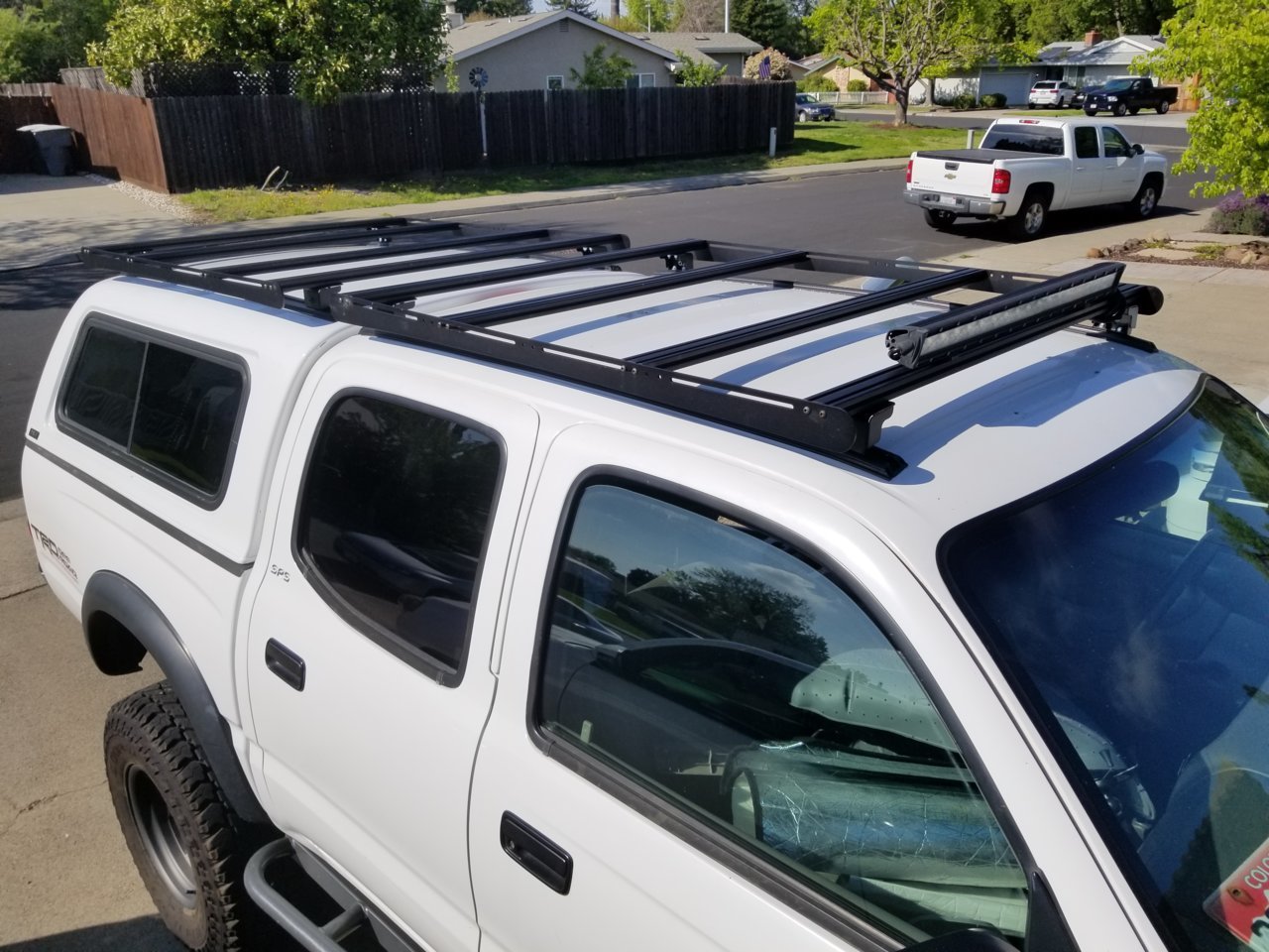

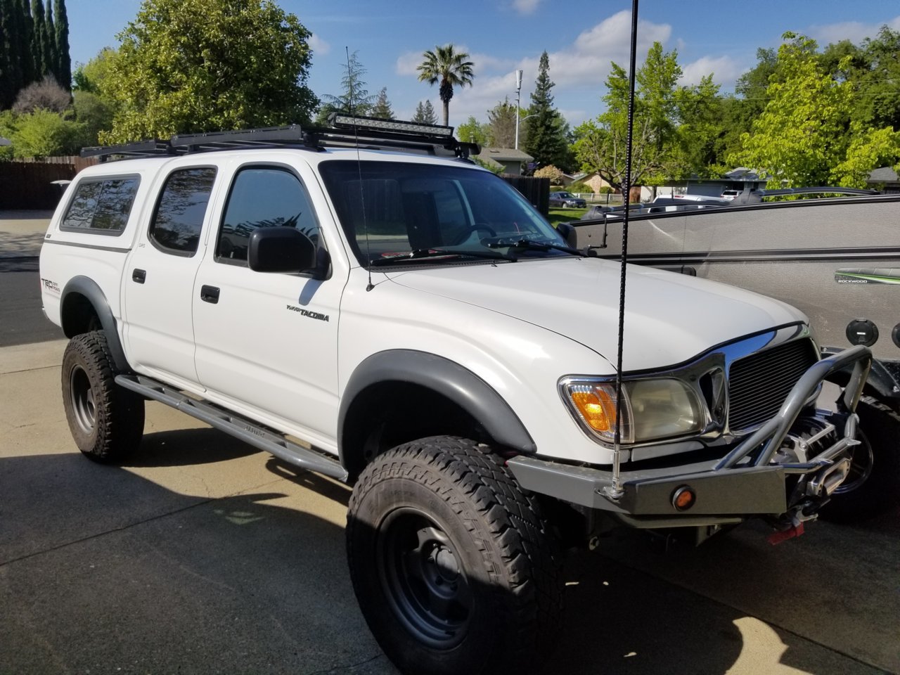

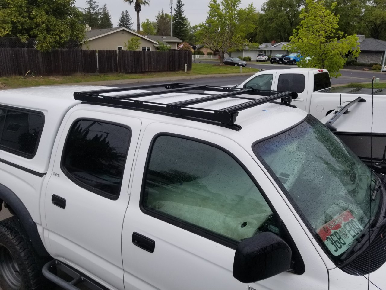

    Camper rack installed today. Gonna tweak placement between the 2 racks a bit still when I have more time. They aren't on 1 level plane yet, but I think a little adjustment will get them close. Worst case, and I planned on doing it anyway, I'll do some cutting to the feet so I can drop 'em lower.
    Over all, I am happy with how it came out.20200411_161828.jpg 20200411_161859.jpg 20200411_162053.jpg

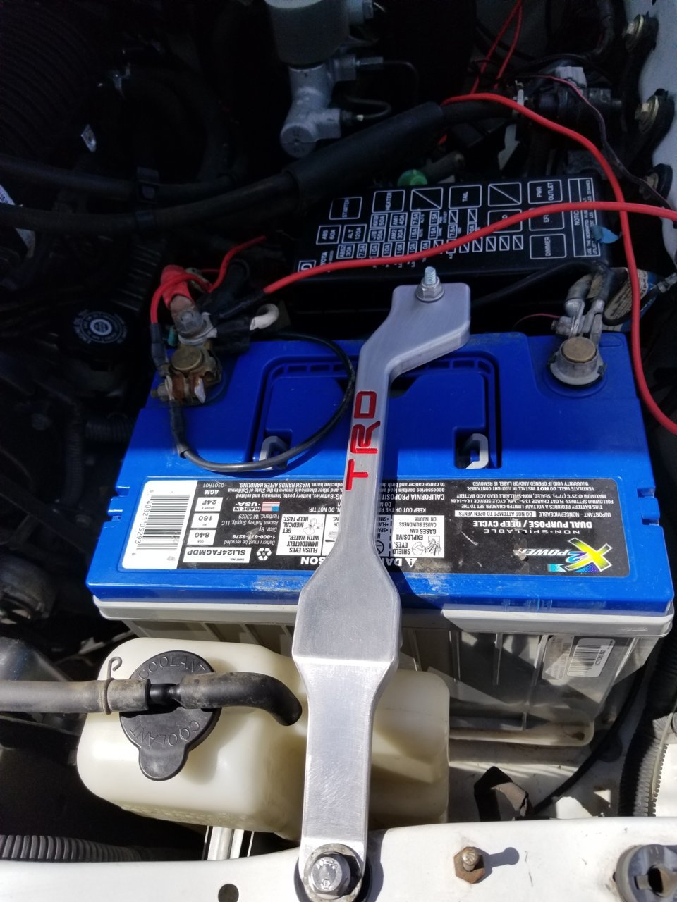

    A little TRD under hood love courtesy of @Coupe Really nice and does a much better job of holding the battery. My X2 was just a bit narrower than the OEM hold down angle pieces and it never did an adequate job and the battery would always end up caddy-wompus. This feels much more solid, and looks better to boot.20200415_141837.jpg

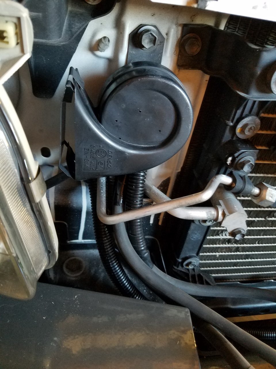

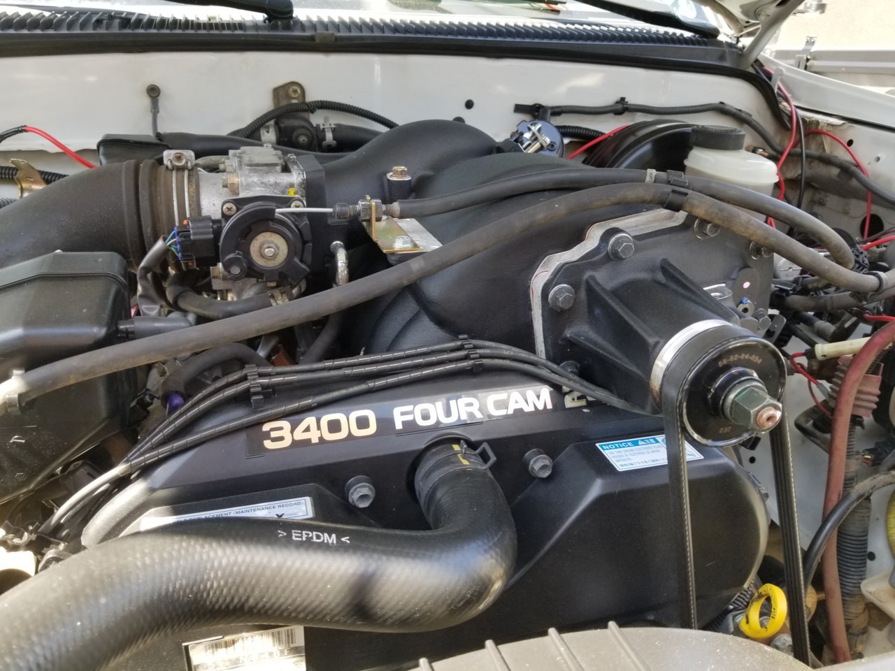

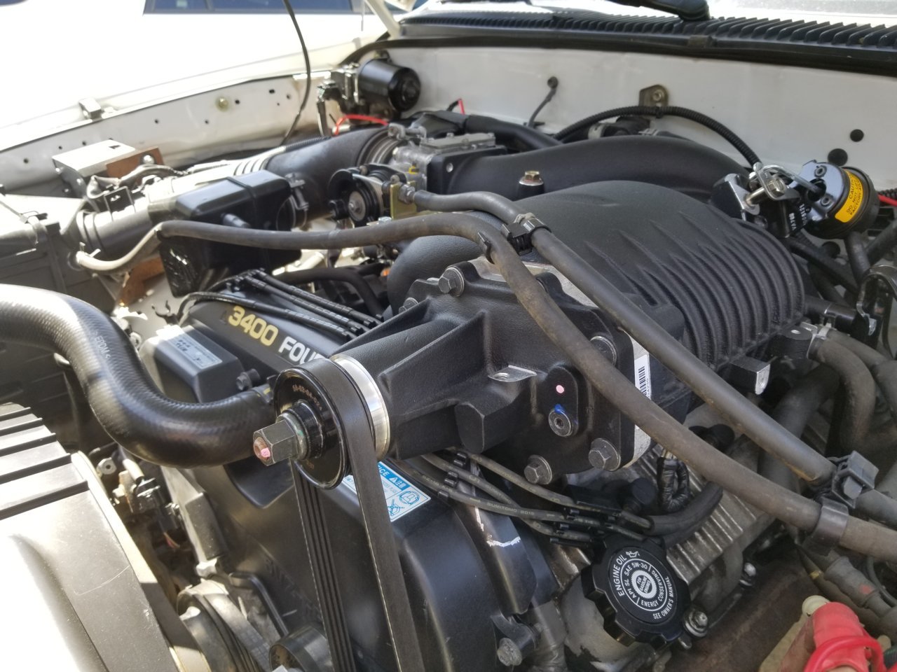

    Never updated here, but installed the Magnuson super charger last April.
    Replaced a few things while I was in there:
    Denso IK22 spark plugs
    -plenum gasket part # 17176-62040
    -Belts AC, power steering (supercharger belt replaces alternator belt, included with kit)
    -fuel filter
    -200 amp alternator
    -Green fan clutch part #08921-04950
    -spark plug tube seals (6) 11193-70010
    -spark plug wires 19037-62010
    -valve cover gasket (2) 11213-62020
    -PCV valve 12204-62010
    -PCV grommet 90480-18001
    Still running it stock, no fuel upgrades. Seems to be running fine. I just added the trans cooler so hopefully that helps keep me ping free (was living in Denver at time of install, now I'm just outside Sacramento, CA basically at sea level) and plan on changing out to a 170° thermostat
    Want to add a boost/AFR gauge and scan gauge eventually to keep an eye on things.20200415_142152.jpg 20200415_142201.jpg

    What model is that oil cooler? I like it.
