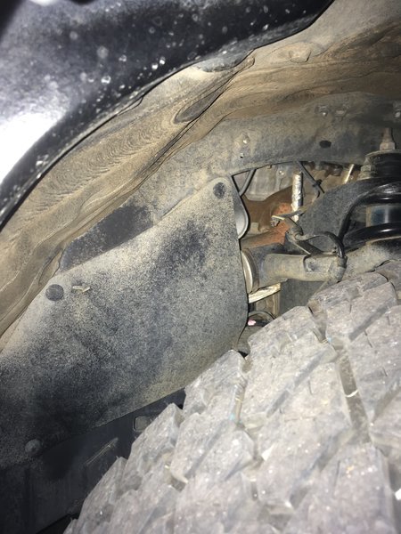

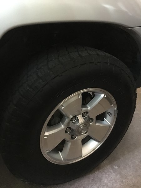

    Here's a pic of the tires and wheel wells. No sign of rubbing. (Flash makes it look dirtier).
    I actually did install some mud flaps I bought off eBay, and that's when I started hearing it. I'll have to get the alignment checked.

    Check the cab corners where the mud flap mounts. Especially check the cab mount itself. If your alignment is off it could rub there
    Also check your upper control arms. Maybe the side of the tire is rubbing there.
    Oops meant frame
