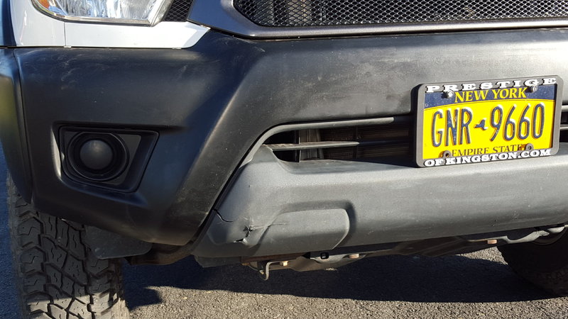

    They wanted 267 bucks to go further after they spent 2 and a half hrs tearing apart my bumper which is now scratched up. Kinda made me question thier mechanical skills.

    Why would they ask for monies if you're covered under extended warranty? Diagnostics time should be comped if they find the problem... I would call and talk to the manager
