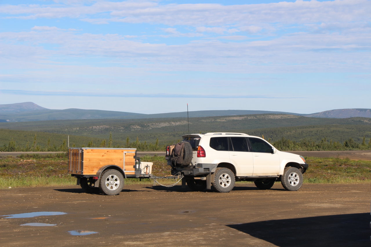

    I got my Tacoma knowing that I would tow my camping trailer about 1300lbs, 3-5 a year and a 5000lbs trailer 1-2 times a year.. Last week I drove it across NM and it did shift a lot, got 13.5-16mpg doing 75mph. The 13mpg was also into a head wind. The picture shows my trailer behind my 2006 Lexus GX470 with a 4.7l V8 5 speed. Going up to the Arctic Ocean and Alaska, that GX avg about 15mpg at 60-65mph and down around 13mpg at any speeds over 65, worst was 11mpg.
    Aerodynamic makes a major difference in modern vehicles, and trailers upset that.
