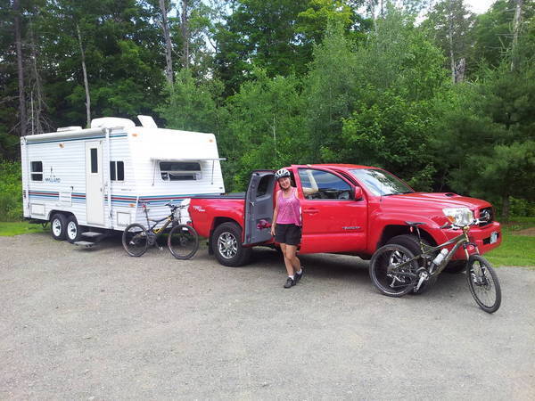

    Here's my setup:

    Are you using a WDH? If so, you should probably check it's setup, as it seems like the truck has quite a bit of rear sag / rake. If you don't use a WDH, I would VERY strongly suggest looking into getting one.

    Thanks.
    No, I don't have a WDH. I think the sag is the notorious rear spring issue that I haven't taken care of. There was some stuff in the bed of the truck, but you are right - there does seem to be too much sag (especially noticeable in this picture). The trailer was empty of fluids at this point and loaded pretty evenly also.

    You need the WD hitch. Mine's lighter and I have the spring upgrade I do not have a WD but going to get one before I go back up to Canada the end of the month they make a big difference also get's rid of the rocking horse effect. If you thought it stopped OK wait till you get the controller and see what you were missing. Estis is a good place to get useless I go up in the winter and snow mobile have a friend that has a camp above Flagstaff lake we snowmobile (only way to get there) down to Stratton across the lake for a pint.

    You need a WDH, if possible with sway control for that trailer, if you are pulling it with a Tacoma. Do you know what the tongue weight is, and the total trailer weight? You need to do some more reading and studying if you want to make your setup safe. Right now, you are unloading the front axle; and you are most likely what's an acceptable tongue weight without weight distribution. With your estimated 5K lbs of treiler weight, I bet your tongue is north of 600 lbs, which is approaching the limit WITH weight distribution.
    Yes, a WDH will help the rear sag (a lot) even without upgrading the springs. Once you know your approx tongue weight, you can select the right hitch. I would recommend the Equal-i-zer. Here is a good source: http://www.rvwholesalers.com/catalo...r-hitches-equal-i-zer-travel-trailer-hitches/
