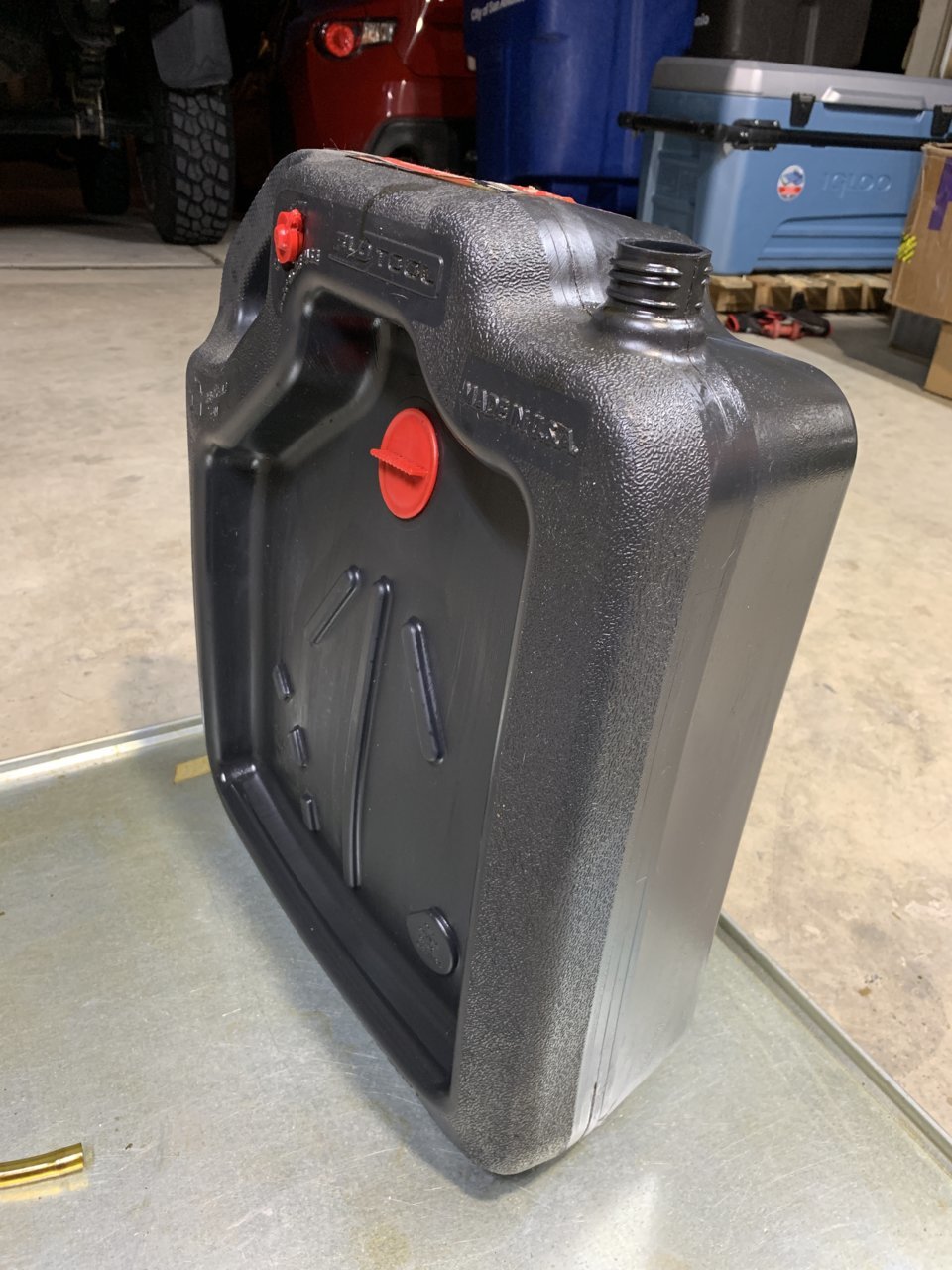

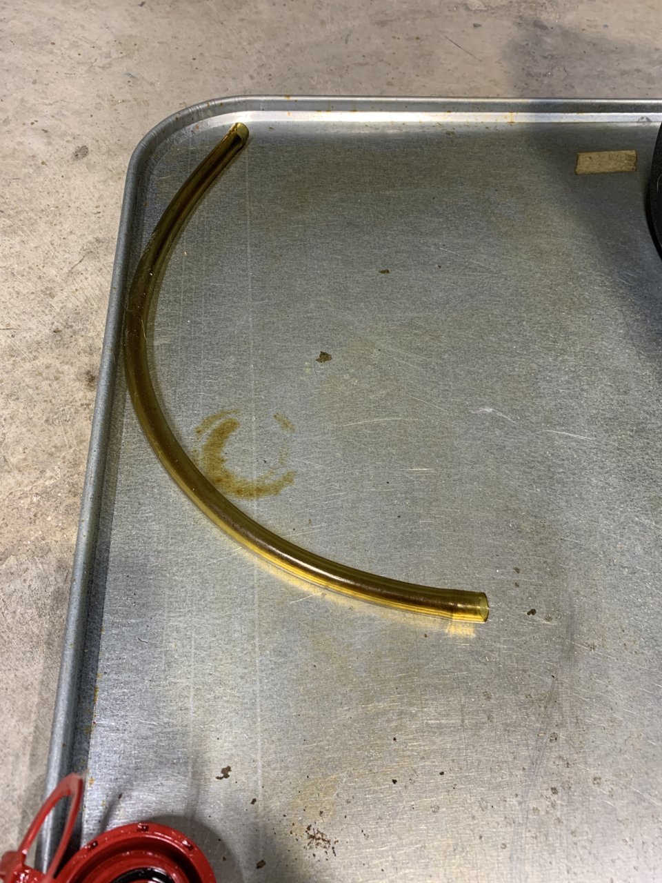

    I recently completed a 3k mile road trip with some wheeling in Moab and the back country of Utah. Normally when I change the oil, I route it from the Fumoto valve through a bit of tube...
    ...directly into the catch can.

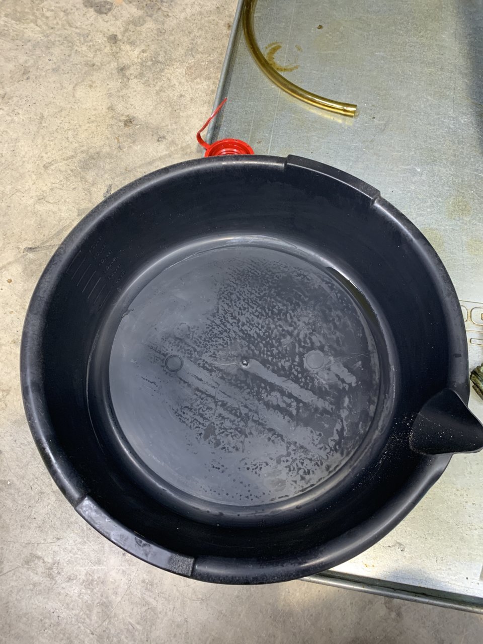

    ...hit maximum capacity so I swapped over to a conventional pan...

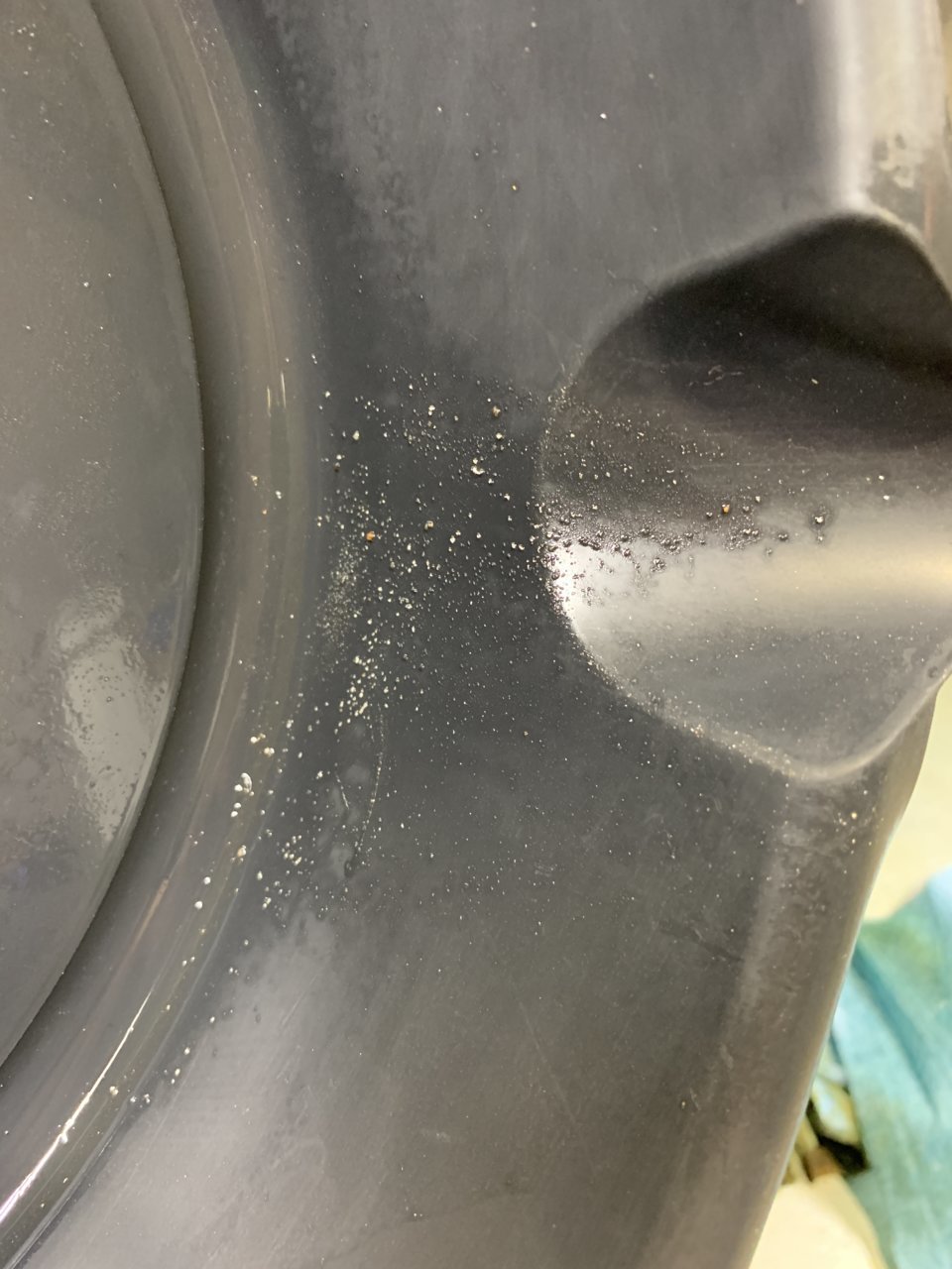

    ...to get all of it out. As I was dumping the pan into the catch can I noticed metal shavings...
    ...in the pan. The pan was clean enough to eat out of before so I believe they came from this oil change.
    I've been using the Fumoto valve and hose to dump directly into the catch can for tens of thousands of miles now so I don't have a clue as to how long or how much metal shavings have come out in previous oil changes. I'm fairly mechanically inclined and have been wrenching for twenty+ years on everything from mowers, sprint karts, dirt bikes, four wheelers, Jeeps, and now tacos.
    This is a giant red flag for me. The truck has just under 95k, I use Mobile 1 and an oversized Mobil 1 filter. I drive conservatively even off-road and am meticulous with maintenance. I'm not comfortable seeing that much metal on a "broken in" engine so my thread title is my question to you: should I be concerned?

    Alex that’s a bummer I’m clueless about this. Looks like shaving from a rod or crank bearing.
    It’s appears to me both shiny an a brass flakes is that right?

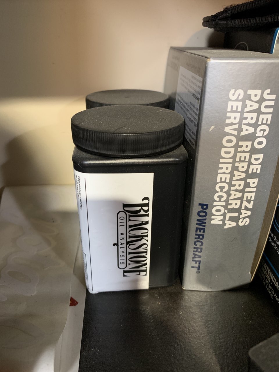

    It would be worth sending a sample to Blackstone labs would be in order.

    Sound like a rod bearing or a main cap bearing.

    I've got a couple bottles on standby. I'm going to run 500 miles and collect a sample to send in.

    You were recently in the desert. I'm going with sand/debris that fell from the underside as you jostled around underneath.

    With the Fumoto valve, it would be unlikely. Before the oil change I thoroughly cleaned inside and out. I was in roads with salt so when I made it back to Texas I sprayed underneath thoroughly. The dirt was also red, what's in the pan is undeniably shiny metal shavings.

    Yup, sample to Blackstone. Also, when you drain the fluid next, pull the oil pan off and see what ya got in there. It reveals with black RTV or Toyota FIPG.
