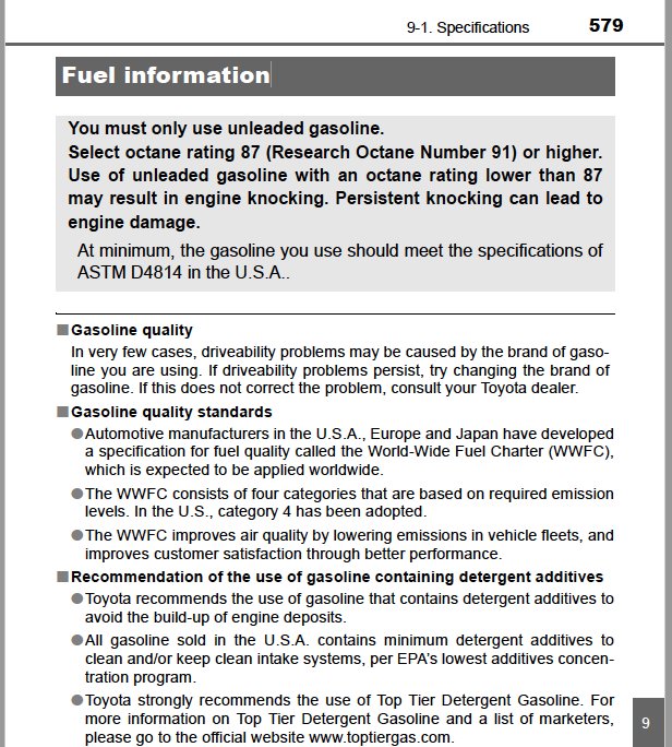

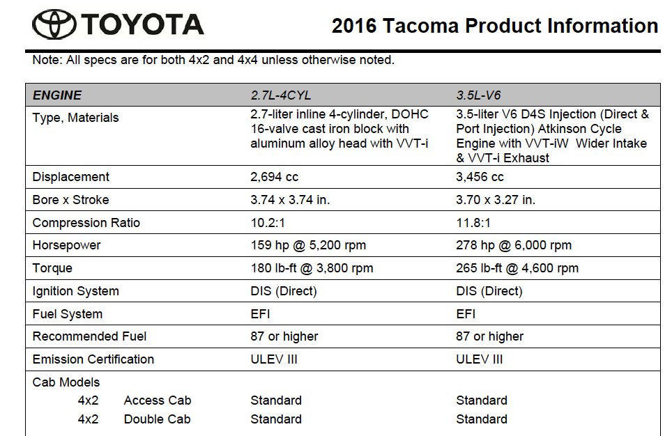

    The engine is designed to operate properly with 87octane minimum. I doubt using premium will benefit enough to justify the significant higher cost, or at least it does not do it for me. I would try a different brand is performance is lacking.
