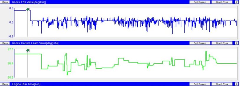

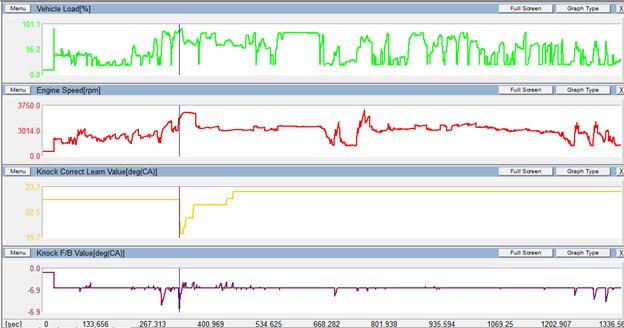

  12. Sep 10, 2021 at 9:44 AM
    #272
    Vlady
    Vlady Well-Known Member
    Dec 20, 2017
    #238986
    4,548
    Issy, WA
    2017 White SR5 DCSB V6 4x4
    Based on my experience with monitoring, Tacoma pings on Premium as much as on 87 and I did not see any gains in performance using Premium fuel
    Here is an example from one of my old logs that I did a while ago running 92 octane. This sample is me driving 60-70, 5th and 6th gear
    Here is a sample of cleaned up timing tables, running 92.
    JJ Diablo and RX1cobra[QUOTED] like this.
