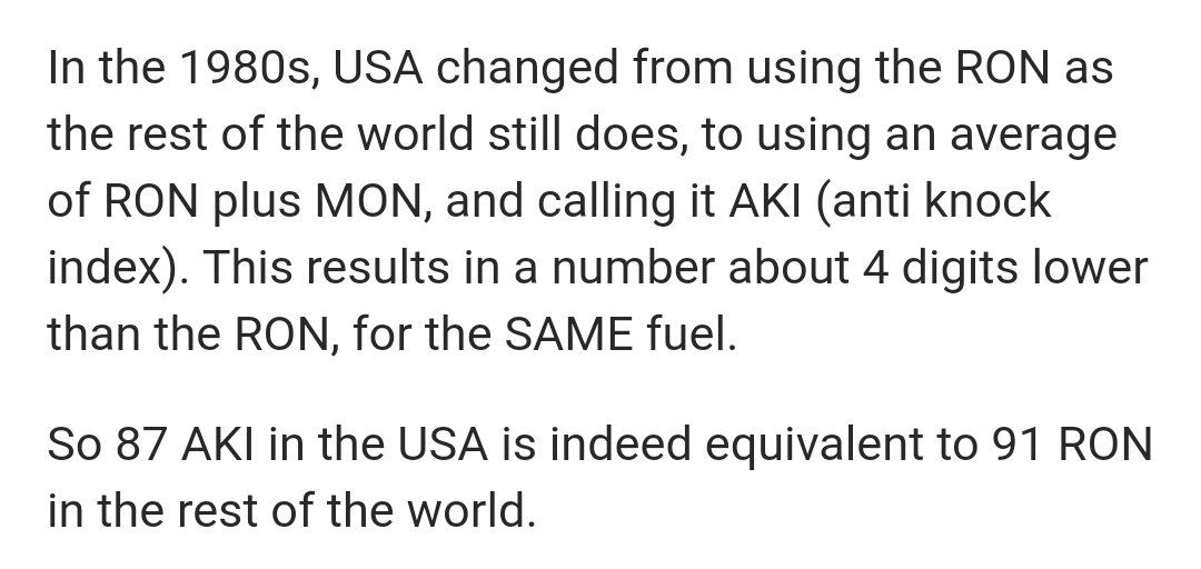

    @cryptolyme is probably referring to this:
    But didn't know this:

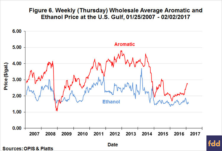

    Cost is less than the aromatics they replace.
    https://farmdocdaily.illinois.edu/2017/03/on-the-value-of-ethanol-in-the-gasoline-blend.html

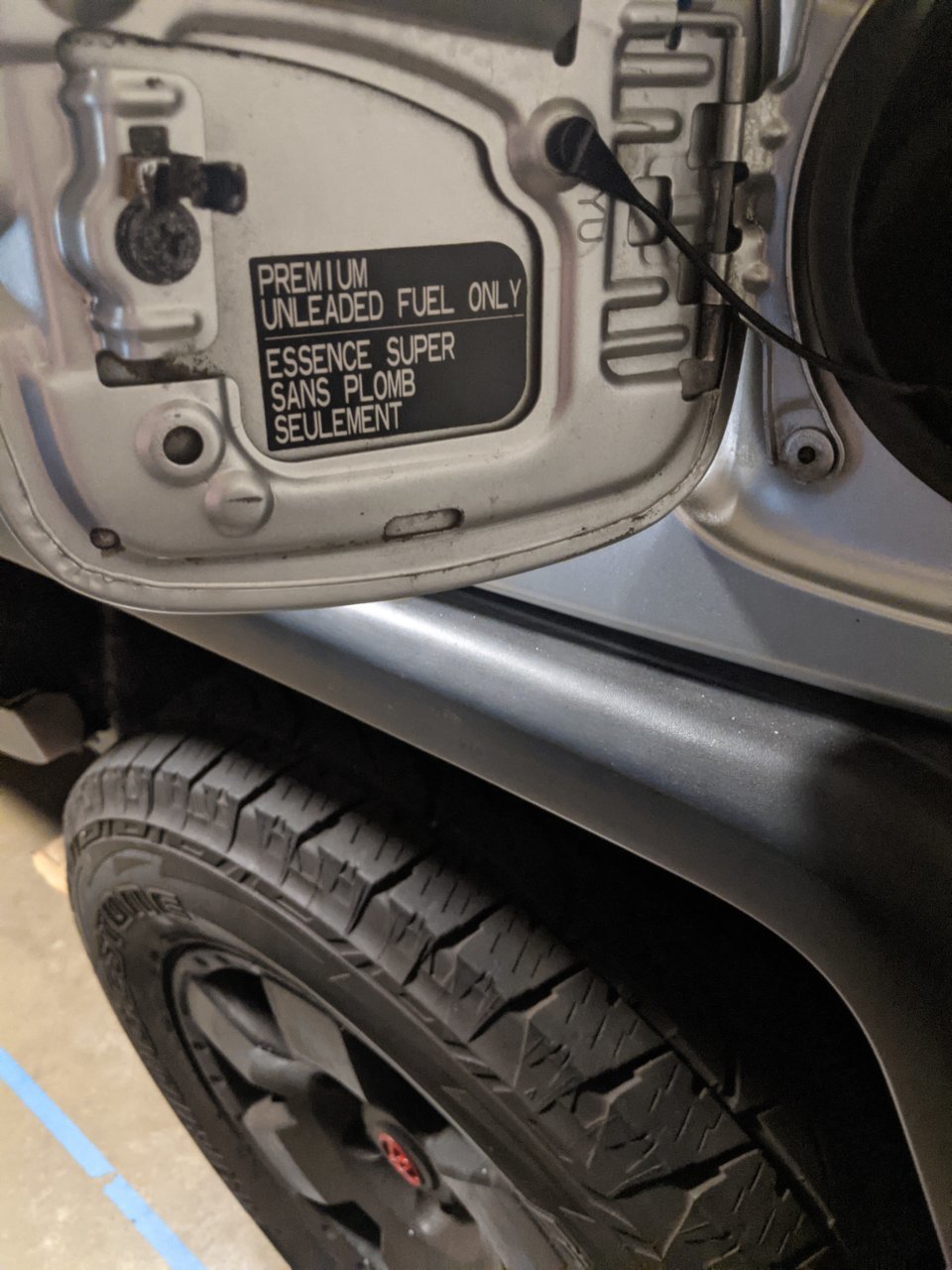

    A couple weeks ago I was pumping 87 in the tank when I noticed this sticker
    cryptolyme, Junkhead and Barsoom like this.

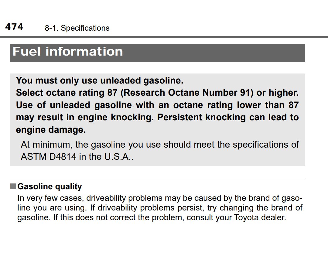

    No one has said that 89 or 91 is required. The manual says Toyota recommends 87 or higher which is very different that what you are saying the manual says.
    cryptolyme and Lt. Dangle like this.

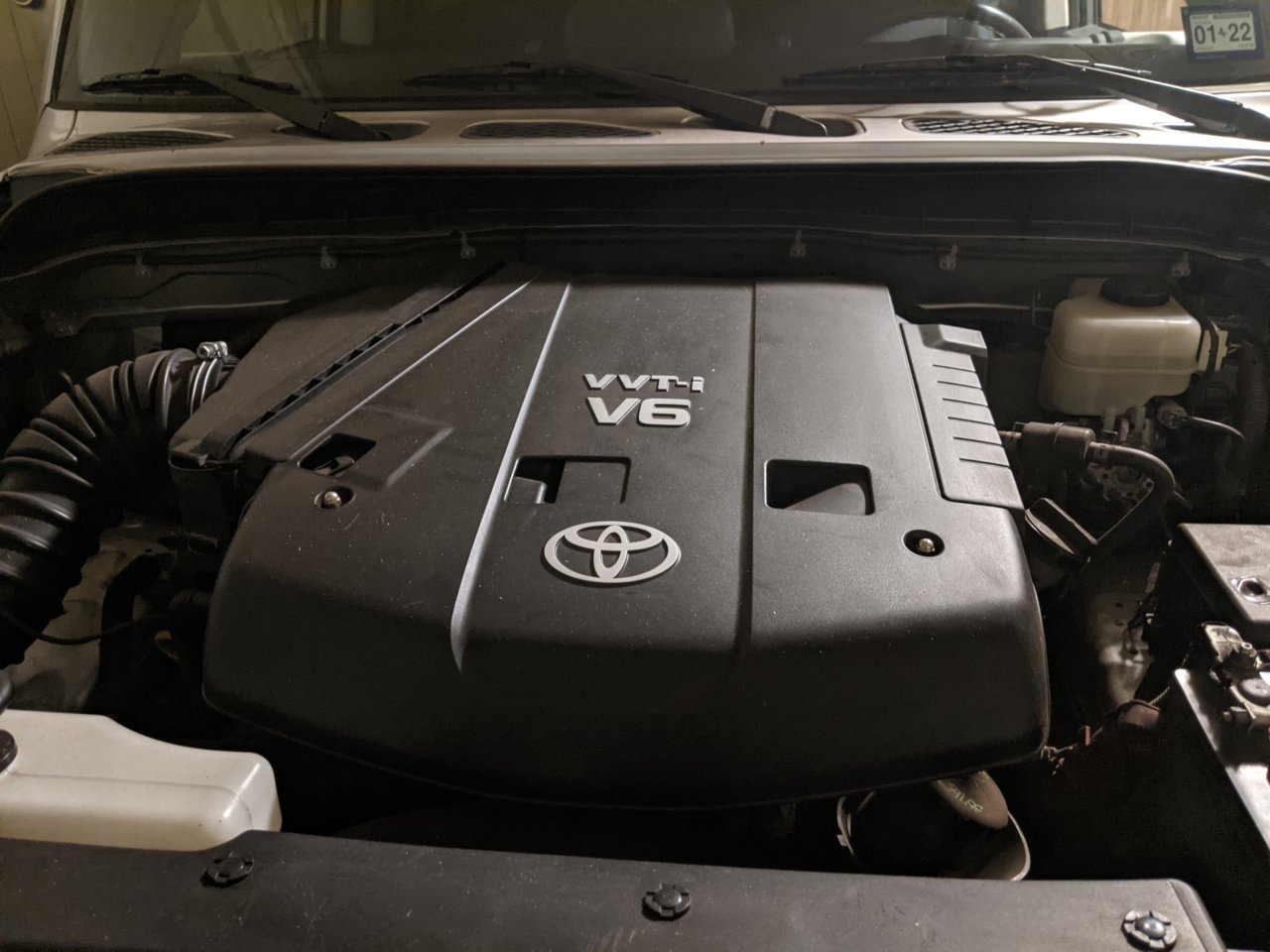

    I don't think that's a Tacoma... look at the fender flare. FJ? So probably a supercharged 4.0L FJ...

    I wish
    You have a keen eye for details ( it's an FJ).
    I've never put anything but regular unleaded in it, I never even noticed the sticker until a couple of weeks ago.
    Guess I'm not so good at the details.:anonymous:
    Notice the 3 wipers
