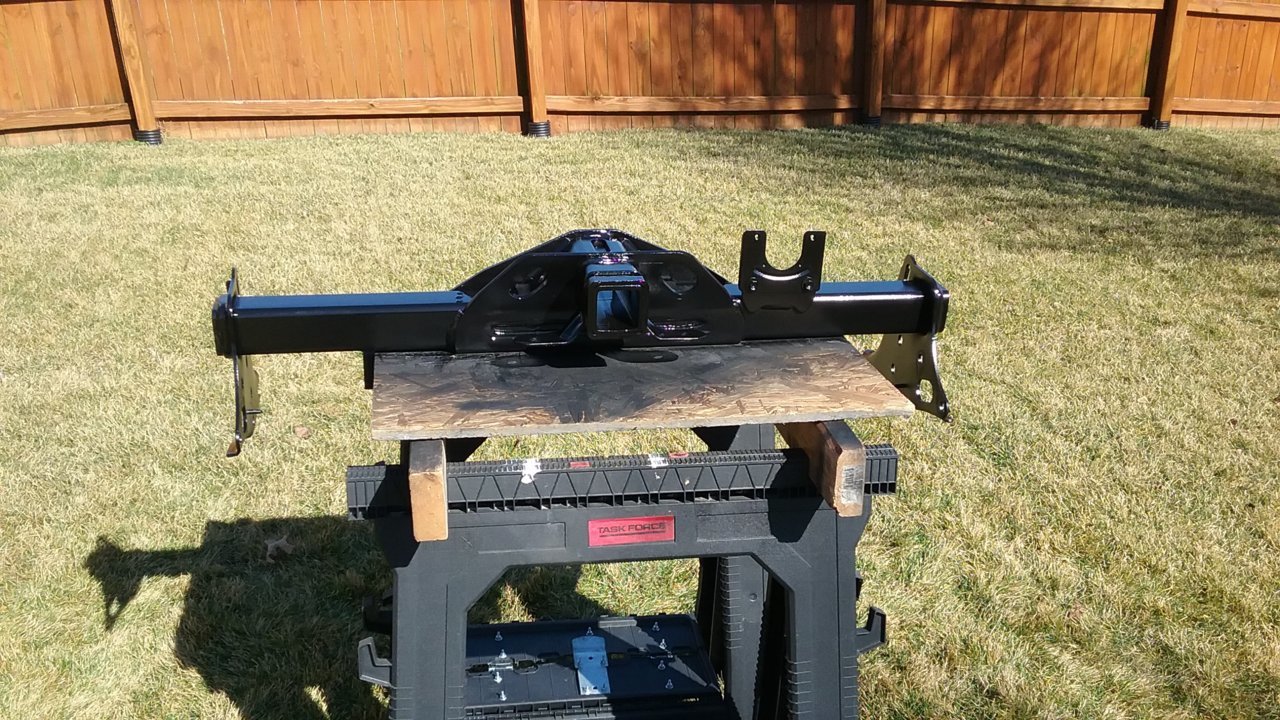

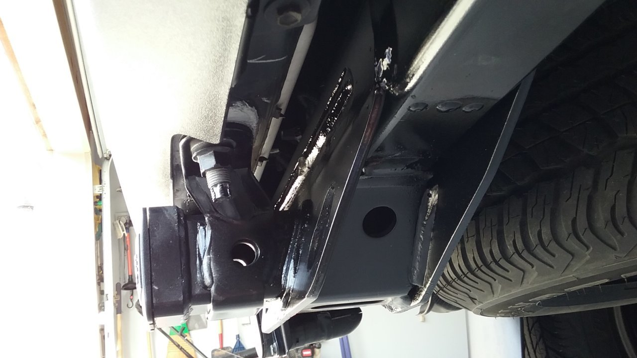

    I noticed some starting to form on my 3 year old '15. Caught it before it became a mess.
    Couple of coats of Rustoleum Rust Reformer followed by a couple of coats of Rustoleum gloss.

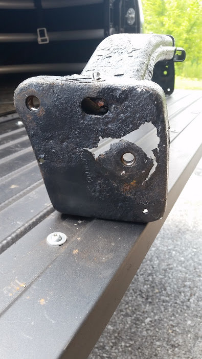

    You may want to check the re-enforcement bar inside the bumper. Mine was completely eaten away.

    Just the rusty parts. Really wasn't that much either. Mainly under the area around the safety chain loops.
    Hitches have a tendency to rust. So I knew where it was headed. I made a preemptive strike before it got bad

    Geez, thats totally corroded through

    yeah, I just replaced the bar, and all the hardware as well. The hitch itself wasnt this bad, but it definitely had some areas that let go of some pretty large rust flakes. I dont currently have plans for towing anything, so im not too worried about it. Should i ever need to tow something, i will probably replace the whole receiver.

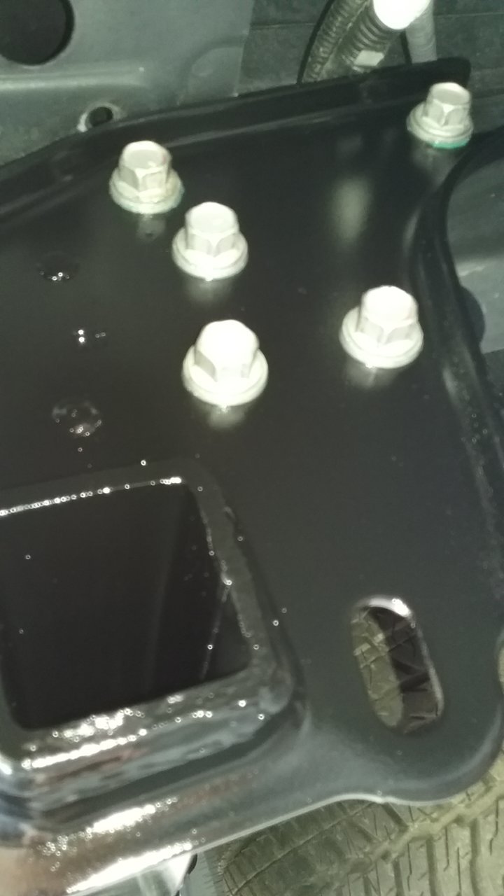

    I also add that I put a layer of antiseize on the surfaces between the hitch and the bumper supports help prevent corrosion in addition to the paint. Plus it will make any future hitch removal easier.
    The area behind the surface in the picture.
    And while I had all the bolts out I applied antiseize to them as well.
