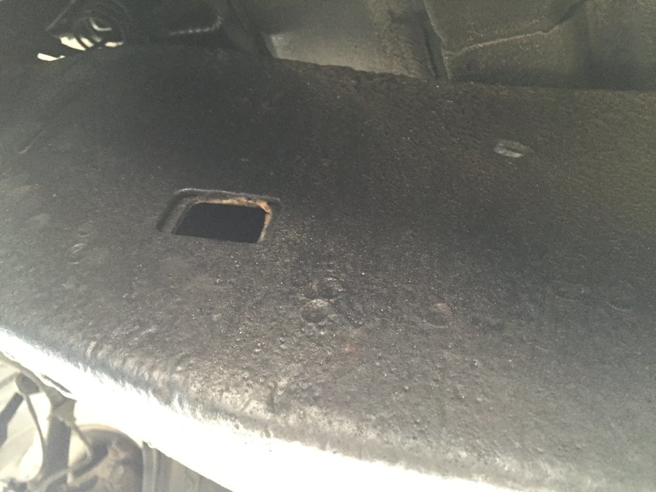

    I know I’ve spent lots of time under it. Hammer test bore scope in box section. Did in the block also because I have it an can.

    Hey Bud I stand corrected upon this after winter hose down before seeing what I got.
    I found a hole in the front crossmember by the tie down drivers side.
