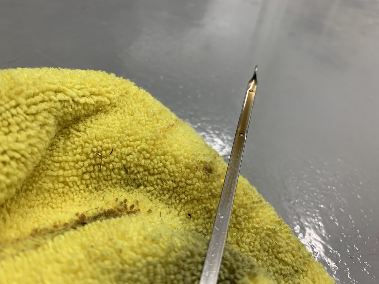

    A little trick I do to get an accurate reading on dip sticks that are hard to read. Pull it out, leave it pointing down, rest the bottom tip on a rag, then I sorta swipe my finger on the under side at a 45 angle down towards the top dot. Then you can see where the oil was because you can see it on your finger. It’s not a difficult technique, do it a few times and you’ll get the hang of it.

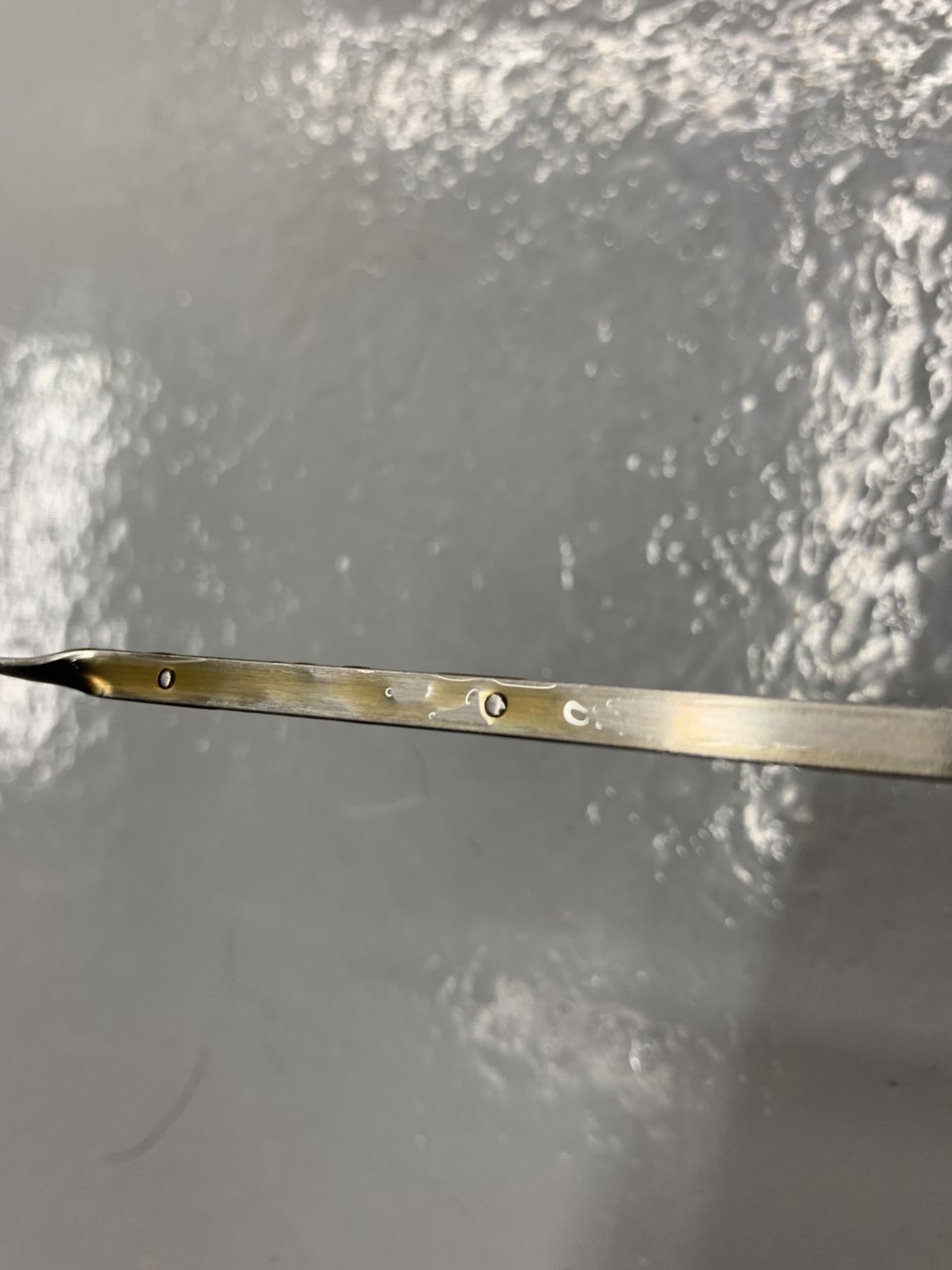

    so I just took a reading (truck has been sitting garage on level ground all day) I just scuffed up the dipstick with sandpaper and wiped it off good and here is the reading. Do I need to drain some oil? A little high? Too high?

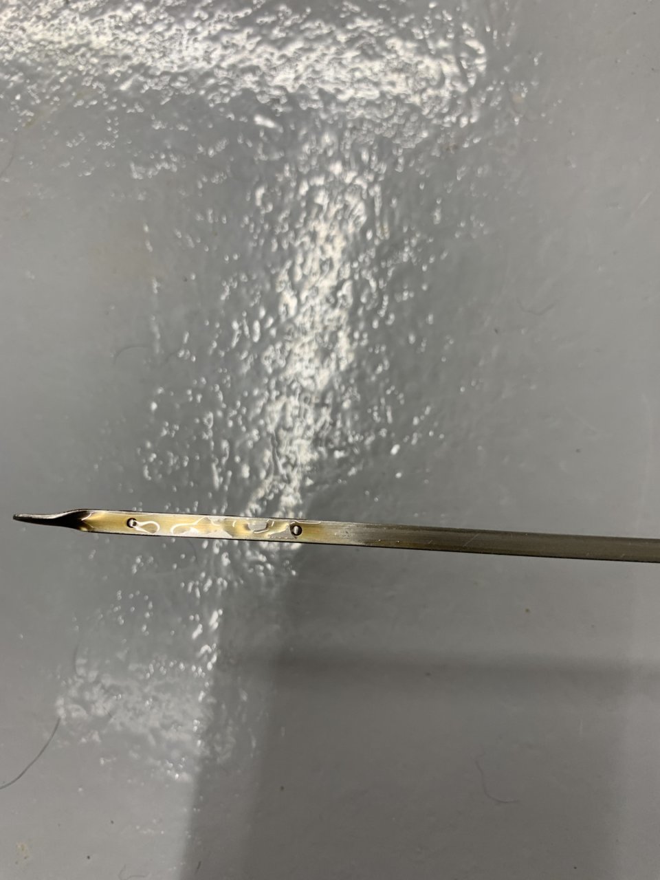

    here is a second reading and honestly it’s frustrating because I can’t tell what’s accurate or not. It’s kind of streaking but I’m not sure if that’s the line or just streaking.

    Looks like maybe a little less then .5 qt over? I don’t remember the consequence of over filling.

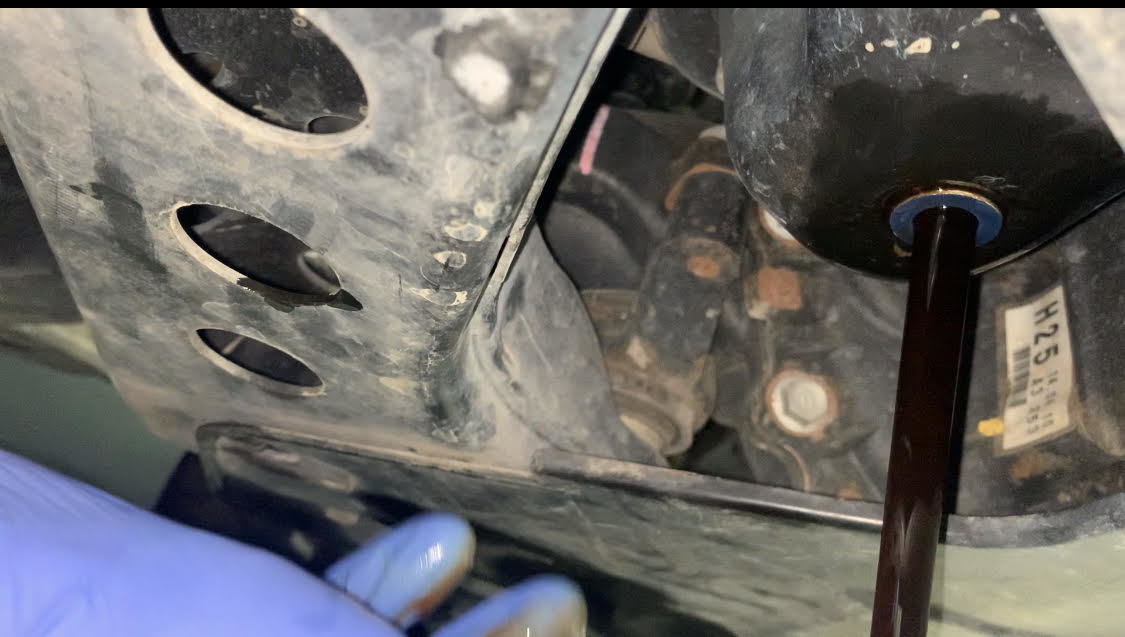

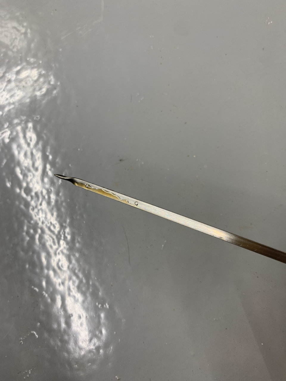

    So I am still getting EXTREMELY inaccurate readings but I determined it was over and drained it a little. Then checked the dipstick and it was looking like it was just under full so I drained a little more to see if I could get a pattern with reading the dipstick better and it looked like it was down to half full. I then tightened the drain bolt and re-filled with half a qt of oil and it looks like I'm about 3/4 full of oil now. Weird thing is that when I drained the oil out the two times the oil was weirdly dark. I've only driven the truck 30 miles or so from when I did the oil change so I'm just a little confused why it would be that dark already. Although maybe from running through the engine and rest of oil pan it's just gotten to be a darker color already?
    Here is a picture of the oil level after dumping some out and adding a little as well as a screen shot from a video I took of draining some of the excess oil out. Is it weird that the oil is that dark from a fresh oil change? (Only drvein 30 miles or so)

    A little trick I’ll do, when the oil is super dirty sludge. Drain and refill with clean oil. Drive it a week or two. Then do a normal oil and filter change. Both drains I do my best to drain very thorough. Jack it up level, lean to the side so it drains better.

    Just seemed a little dirty for just getting changed. Regardless I know it's fresh oil and it's not over-filled. I wonder if I need to buy a new dipstick. At about 3/4 now so I just need to monitor it.

    This does look like it is slightly over full.
    But I would not have drained any out.
    I would have run it the way it was.
    A little bit low or a little too much is not something I worry about. It’s WAY too much or WAY too low that I worry about.
    :mudding:
    FWIW, a fluid extraction pump makes like easier when “removing a small amount of oil”.
    If it were me. I’d check after setting over night. If it is close to top mark, I’m calling it good. :thumbsup:
