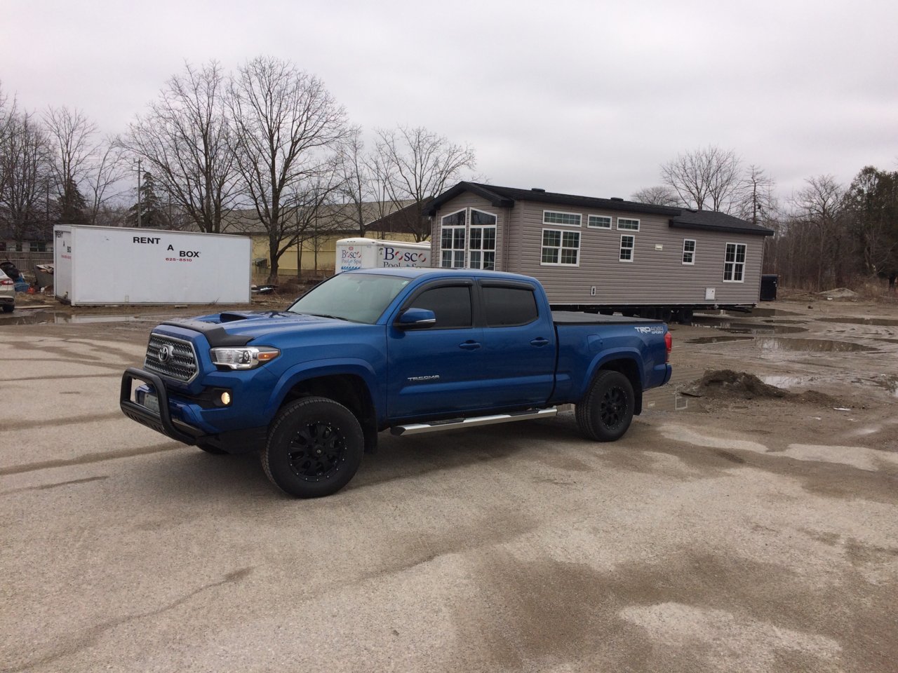

    Just had a level lift done this week. a 2 1/4 " kit for the front
    The rear seems to be "squatting a bit " in this picture. Is it just me or maybe the lift is only a few days old and the front suspension has to relax a bit? I have about 150 lbs in the back but i doubt that would make rear squat much.
    or should i be looking at having 1" blocks installed in the rear to raise it a bit .

    150lb will drop back down 1/2" to an 1" You can do 3 leaf progressive add-a-leaf (1-1/2 without overload 2" with), or blocks. 1",1-1/2" would work. All depends if you want rake. Should get extended length shocks also with over an 1" lift in back.

    Yeah I’d bring it up a tad

    Just put an aal in the back

    add a leaf for sure

    3 leaf AAL with the overload kept in will give you about 2 inches in the rear.
    My truck with 2 inch lift front and rear retains factory rake even with a tool box and 100lbs of stuff in the bed.

    I had about 130lbs total of tube sand bags for winter traction i took out and that helped bring the ass up a bit but i took some measurements and ive got about a 1" squat toward the rear that needs dealt with. So i figure a 2" lift at least with an AAL should take care of it.
    I got a few quotes for the AAL and waiting on the dealership to give me their numbers as well for about a 2" lift. But this is a definite install in the next month or so. Just blew a wad on other customization on the truck so i got to get that paid off first..
