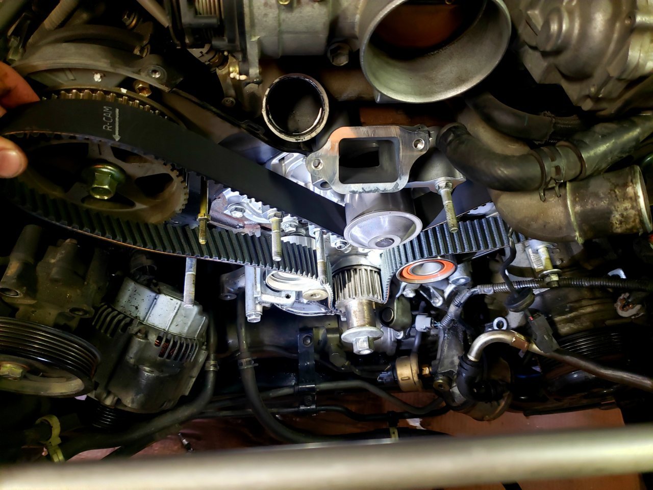

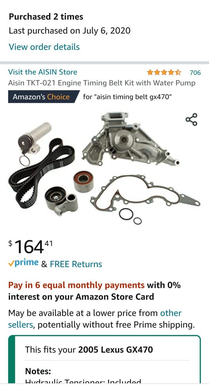

    TB/WP replacement is part of PM for the 4.7L. I own GX470 and LX470. Did both timing belt/water pumps myself. Aisin kit on Amazon is $164 right now. Japanese parts.

    -FSM (repair manual)
    -Torque wrench
    -Crankshaft pulley holder, to remove crank bolt.
    I spend about 8 hours. Take my time and clean everything meticulously.

    It's not bad but you need to be able to get the crank pulley bolt out and know how to line up timing marks at the cam and crank.
    Leaving the hydraulic tensioner off while setting up the timing belt will give you the most slack, it can be hard to get the rubber belt over the pulleys.
    Also, those V8s have a bunch of different length bolts at the front of the engine that go through the water pump and various brackets for the fan and accessories. Keep those long bolts organized and make sure they go back in the same hole they came out of
