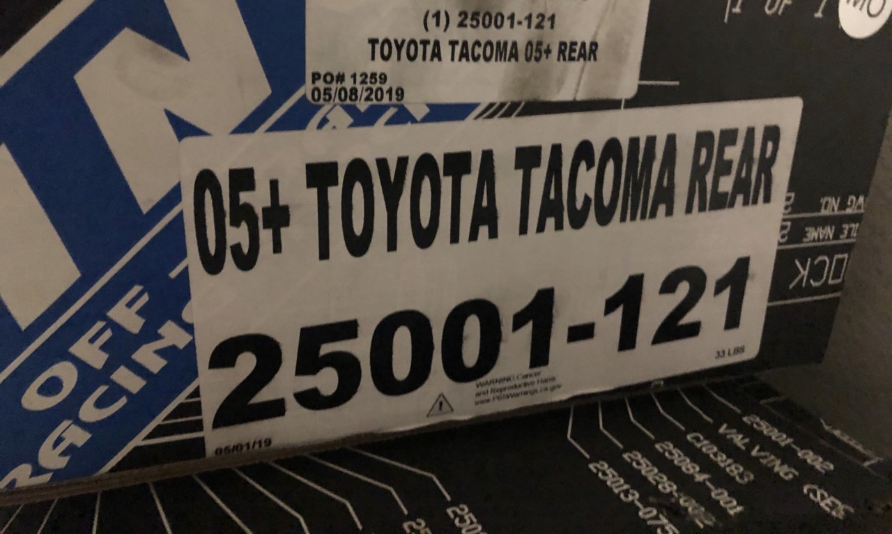

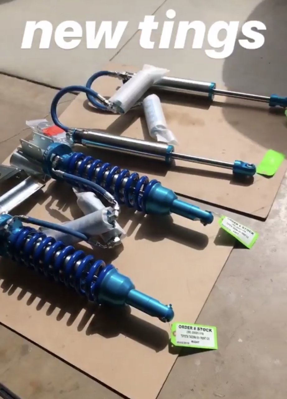

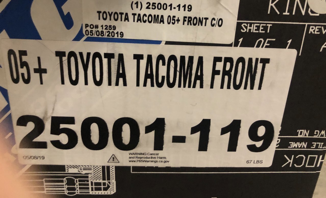

    So I am currently running the stock Bilstein suspension that the Baja came with. I added the Toytec 1" spacer up front and the Icon AAL in the rear. I am strongly considering purchasing these Kings that are practically brand new from another member. My question is, will I see any additional lift? I was hoping for another .5-1". I know I will need to get the Total Chaos UCA's. Would you guys recommend the switch? What benifits will I have by going to the Kings??

    .. they’re height adjustable throughout a set range, so whether they’ll add lift or not depends on what you’re running now, and how much room to have from that lift height to the top end of the max range of the new shocks.
    That said, you seem pretty unaware of what you’re looking at despite having pics of the part numbers so you could look up the specs on them. So, I’d do some reading and see if you want to run a shock like this. Then decide. Not to sound rude or dickish, but just seems like you’re reading stuff online about what to get and taking that as the absolute word - like “I know I’ll need Total Chaos UCAs..” not sure why you’d think you need TC UCAs to use these.

    Those kings are not extended travel so you should not need the total chaos arms unless you are lifting a total of 2-2.5 inches. Only reason for needing them is to help with alignment after lifting, and/or more clearance when you have extended travel shocks.
    Those kings look like they have the stock preload, so maybe half an inch or .75” of lift. You can adjust them up higher if you want though.
