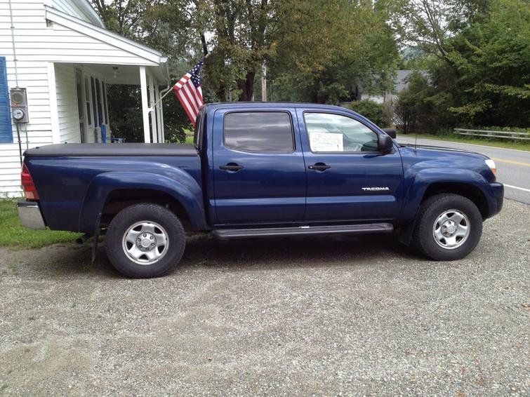

    Here is what the truck looks like.

    It has an Undercover tonneau and Westin running boards. Everything including 4WD hi and lo, AC all function fine.
