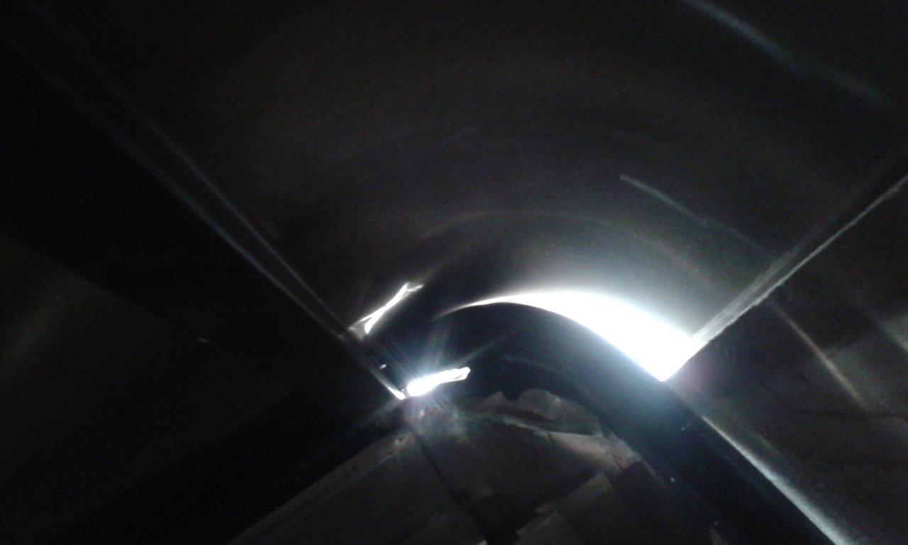

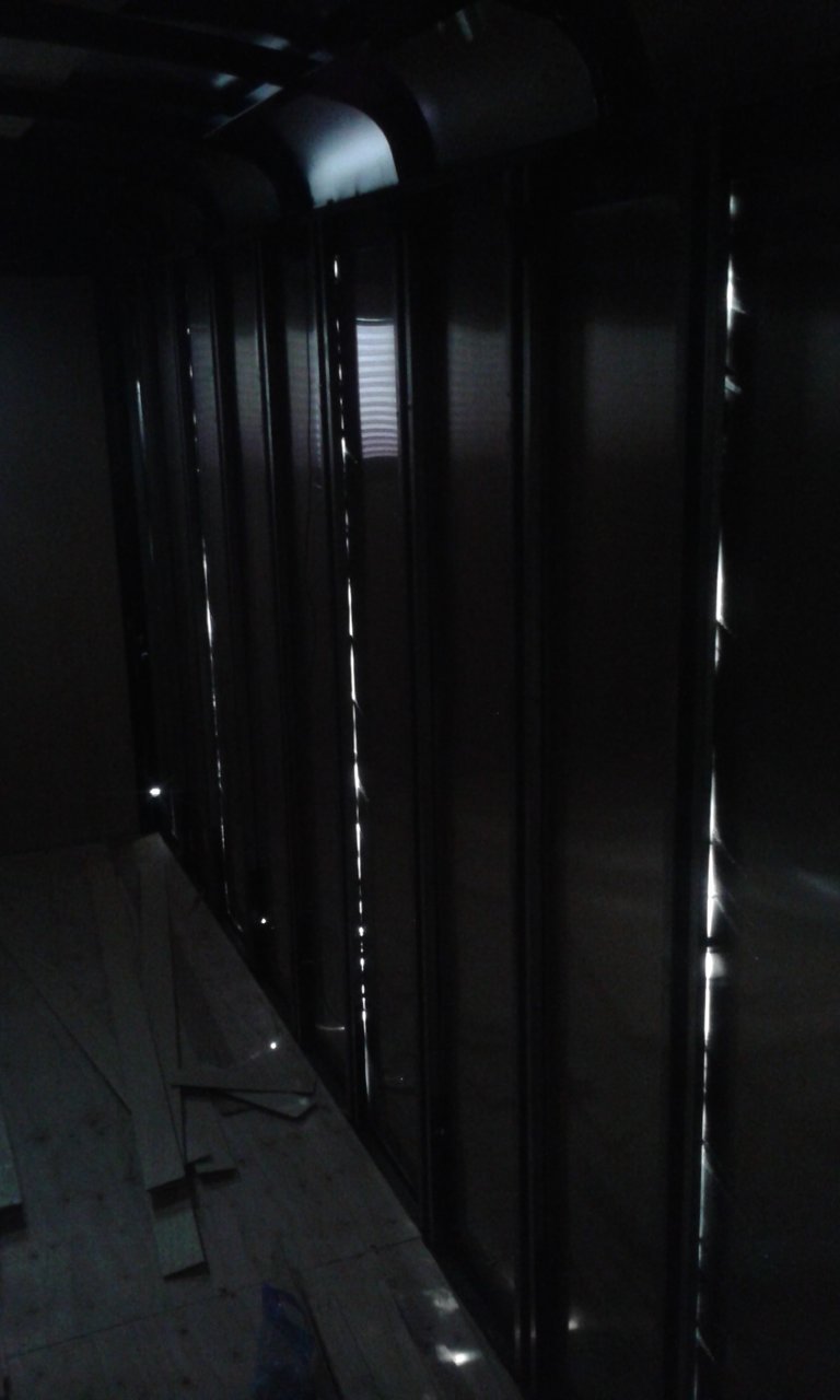

    With the flat top, check where the AC is mounted to see if it is sagging down. It appears the floor is uncoated underneath, check for rot. As others stated, check for corrosion, cracks, bends, and check tires for any signs of sun damage/dry rot.
    If you end up getting a new trailer, I suggest getting laminated walls (screwless) and make sure it is rated for weight on the roof.
    Interstate trailer was kind enough to delete my posts and block me from their facebook when I posted QC issues with a brand new trailer. So, I would recommend not going with them unless you already plan to disassemble it to the frame.

  10. May 9, 2020 at 11:37 AM
    #30
    windsor
    windsor Just a guy
    Dec 31, 2014
    #145322
    7,692
    Homeless in Oregon
    2008 Tacoma Super Duty aka Tundra
    Canopy, fitted seat covers, OBA with self leveling air bags, 100w solar, dual Rhino Rack Pioneer platforms, side & rear LED work/FU lights, CB, cell booster. 7x16 cargo conversion, 3" lift, 7'x6.5' fold down aluminum rear deck.
    To see it, I had to pull the inside walls off. Kinda hard to talk a dealer into letting you disassemble a trailer before you buy it.

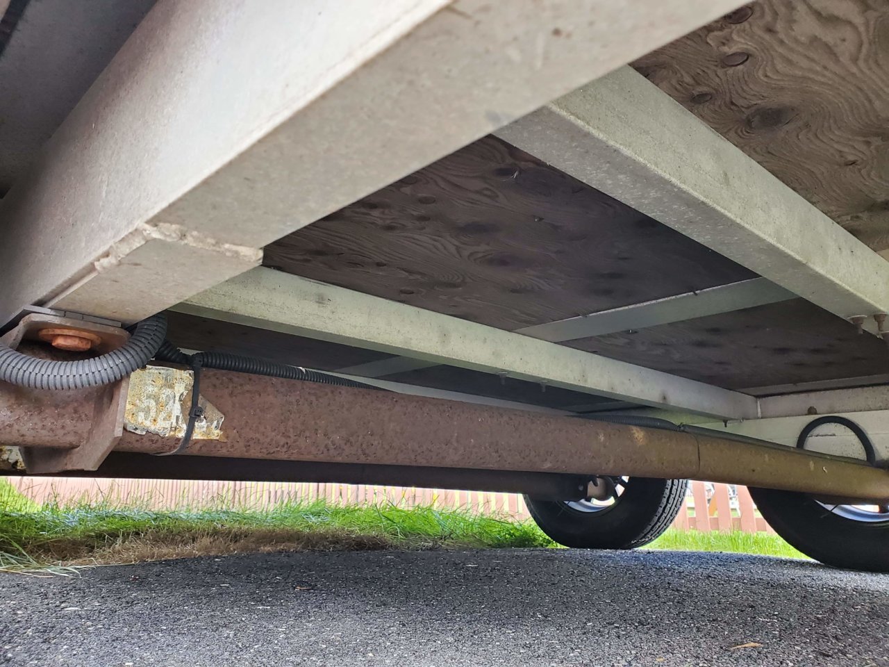

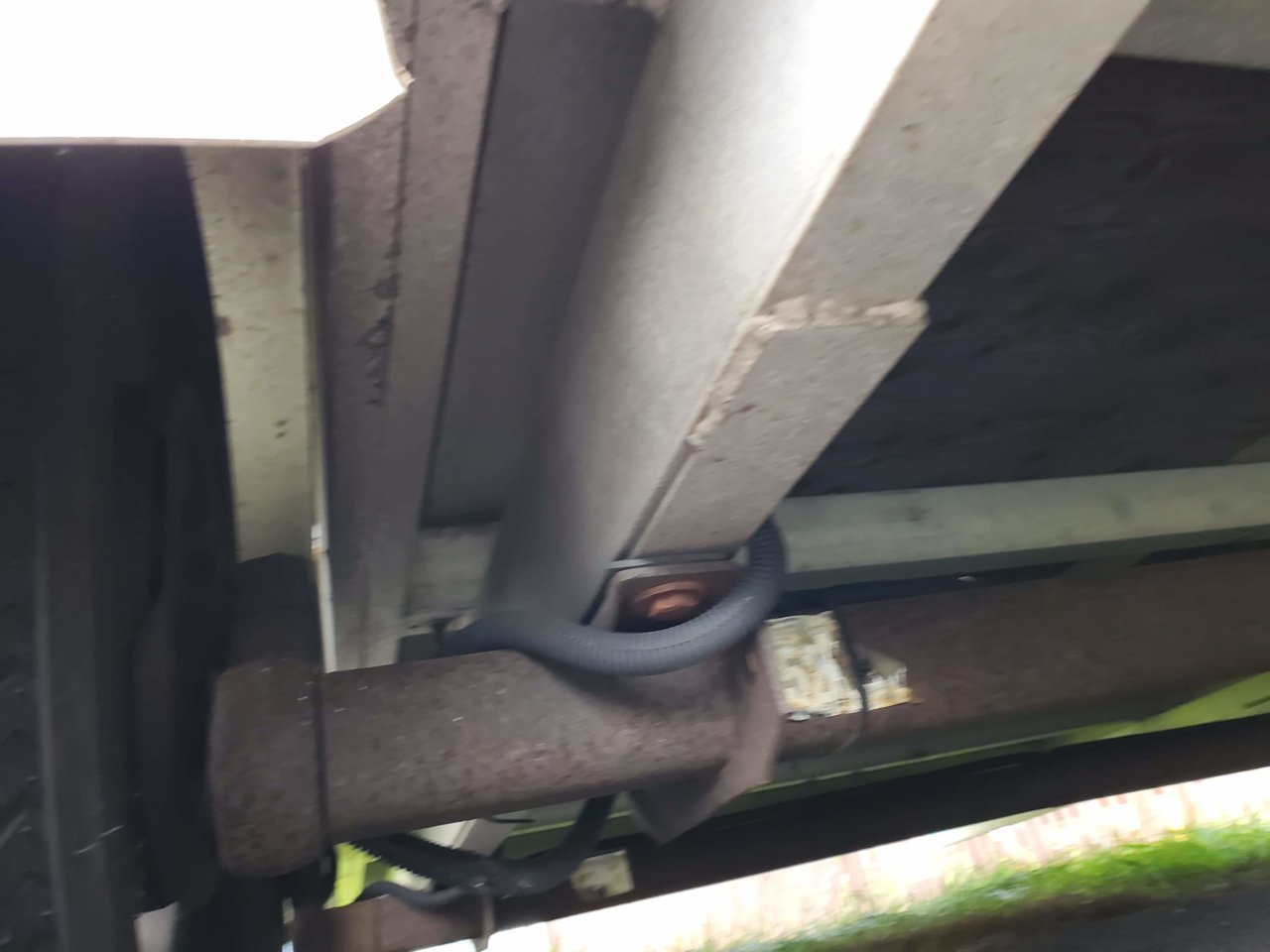

    Hi guys, I just got these pictures from the owner from underneath. It looks like the axles are torsion? If so, any cons?

    #145322
    7,692
    Homeless in Oregon
    The only cons for me are the price to replace the axles when they are done, when they fail, they can drop the fender onto the tire (more of an issue on single axle trailers), and they transfer hits to the frame more.
    I like them because they provide a smoother ride.
    To check an axle, remove the tire and put the jack under the spindle. It should start to lift the trailer as you raise the jack (dont need to keep lifting). If the spindle raises, but the trailer doesnt, you need a new axle.

  14. May 9, 2020 at 3:44 PM
    #34
    calebc
    calebc Well-Known Member
    Oct 21, 2019
    #308578
    1,056
    Walk around and look at welds, make sure you don't see any cracking. I've owned aluminum trailers and worked on aluminum trailers and almost all of them end up developing cracks in the welds. It's not a huge deal, especially if you can grind and weld the aluminum yourself, but it is something to check out.
